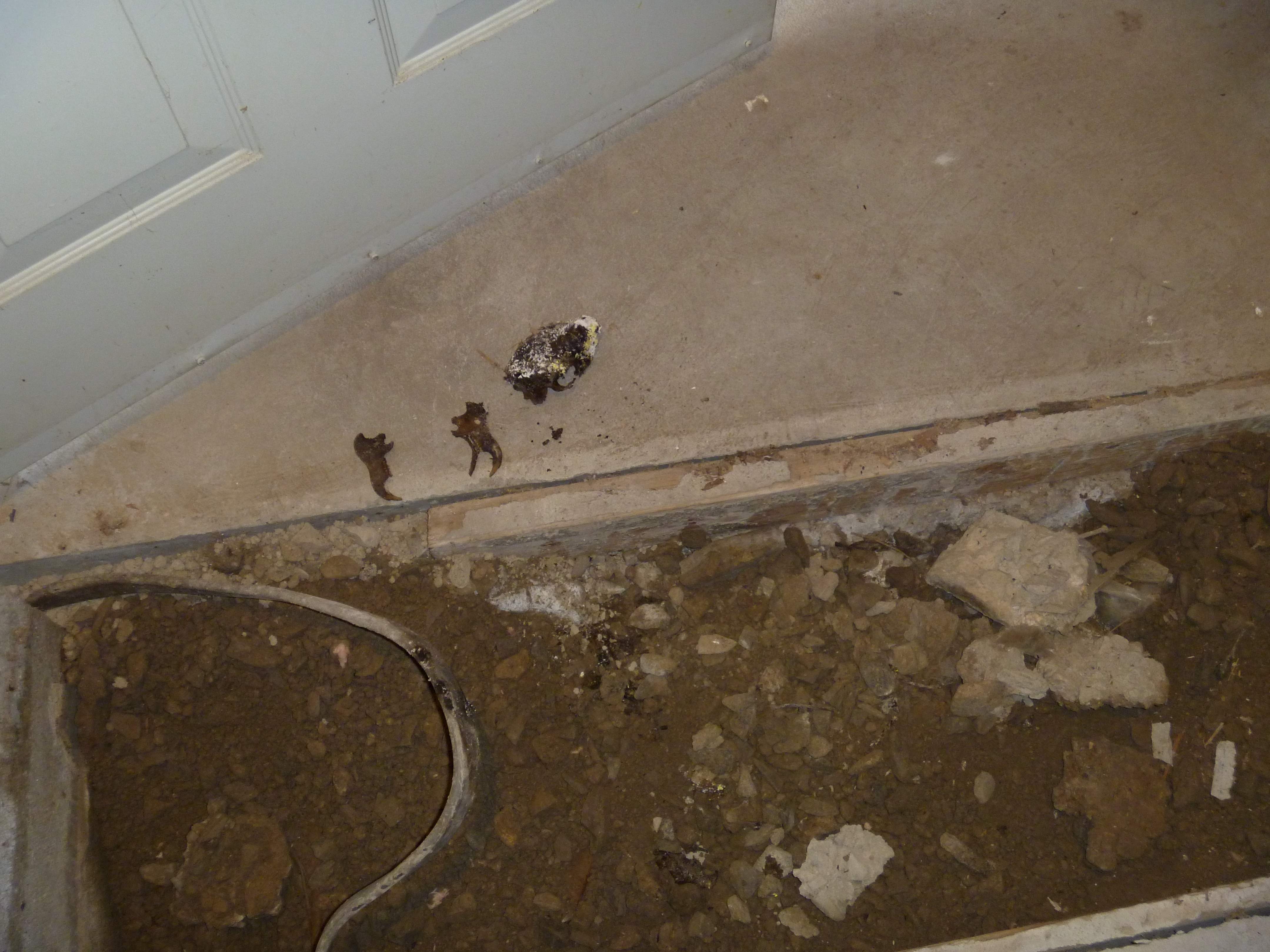

This little critter tried some welding without reading the safety stuff in the manual. He caught a buzz off the feeder wire under my shop floor. No sissy MIG for him, he liked straight AC.
