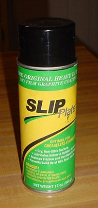

Jim,
I get this stuff at my local Farm Store. Comes in spray cans, Quarts and Gallons. I use the brush on stuff for the decks and mold boards. I also like it for parts that need lubed, but I don't want grease and oil all over myself. Dries very fast.
NOTE: I use the same brush all the time. They get hard and dry, but I just tap the bristles gently with a hammer against something hard and the dry graphite flakes away.

It's called slip-plate and I've been using it for years with great results. It keeps the acids from mowing from eating into your deck.
Step 1 - Apply it with a brush to get a thicker coat than spray for longer lasting results. Let dry.
Step 2 - Often not done but must be done for best results. Burnish the coating - I use one of those foam sanding blocks from HF - by sanding or wire brushing all over, especially the tight areas and curves. It will leave a very smooth shiny slick finish that's good for at least 1 season.

You can also find Slip Plate at Grainger...
Edited to add - They had to order my gallon, but it came in within a couple days..
Brian
