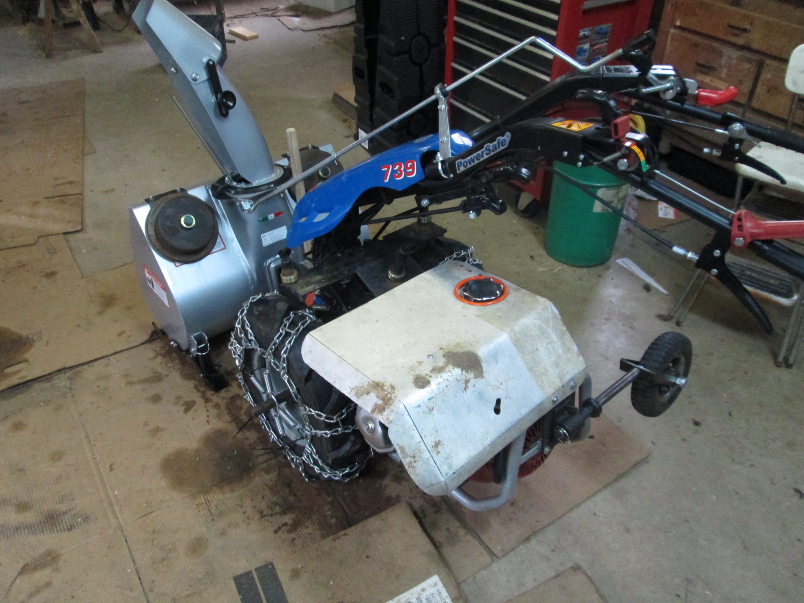

Actually, what I was asking about is whether there are any of these heat shields or some type of baffle available commercially. I made a cover for my engine to keep the snow drift off of the governor but I have doubts whether it would retain any appreciable heat. I can try it.

I stumbled on that manual when I was researching Honda GX engines, and I bookmarked it for future reference. It's the best one I've found. I have an older BCS 605 powered by a 12.5 hp B&S Vanguard. That engine has worked well for me and even sounds nice and smooth compared to the Honda GX, which has more of a high revving and higher pitched lawn mower sound. I started looking at 853's to trade off the 605, but the Honda engine choice made me reluctant. The GX engines get great reviews, but also have some weaknesses as you are experiencing in cold and snow. I considered an 853 with a Robin/Subaru engine from Joel at Earthtools, but I read about quality issues and part of the Subaru engine line was sold off. I'm not sure if Joel still offers them either. So back to Honda I guess.
I like the way your engine shield looks. I can picture it with 3 sides extending down like a full dome or hood over the engine for cold and snow.

I'd be interested in building an engine shield for my 853 as well. I've noticed after blowing snow for a while, it seems like my engine power starts to decrease...
I can't see a photo of the shield you made, could you post it up if possible?
   / Cold Blooded Honda #37
Here's the thread that NibbanaFarm discussed the shield. He has a picture of his weights added to the blower in that thread too. http://www.tractorbynet.com/forums/...snowblower-review.html?highlight=#post4654976
I added his picture of the shield from that thread as well.

That is great, thanks! Man, that's nicely done.

That's the kind of thing where once you see it you know exactly what you want to do, because a great solution is right in front of you. But, I don't have a workshop at the moment so fab ability is pretty crude.
I was thinking of also making a skid plate for sorts for underneath/the side of the BCS. Really dragged the motor through some snow making a path today.
