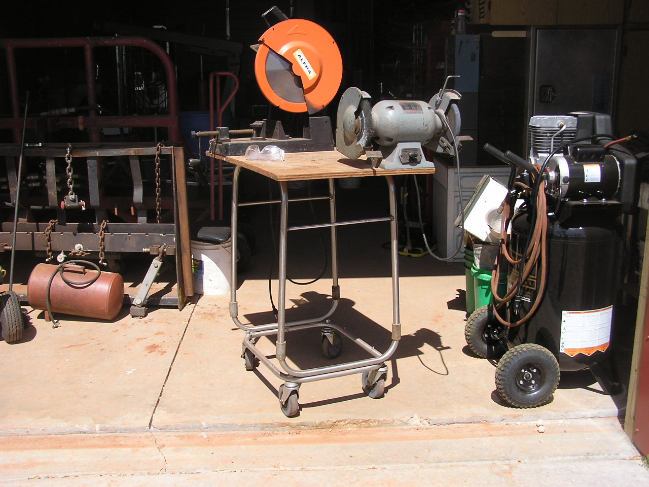

I converted an old DeWalt radial arm saw to metal cutting, the thread title is Metal Cutting Saw. It worked as planned but was not as versatile as I hoped and took up a lot of space. In the end I dismantled it and replaced with a Makita cordless metal cutting saw. See photo below. It is not very expensive, extremely versatile and takes up very little space.
I also made a table for a DeWalt handheld bandsaw. I use that just about every day for something or other. The thread title is Band Saw Table.
Several companies make metal cutting saws that work similar to an abrasive chop saw but are much quieter and make a nicer cut. They cost $400-$500. I have a 12" Makita metal cutting saw that is excellent. It would be a complicated DIY job to make one comparable from scratch. I would not attempt that.

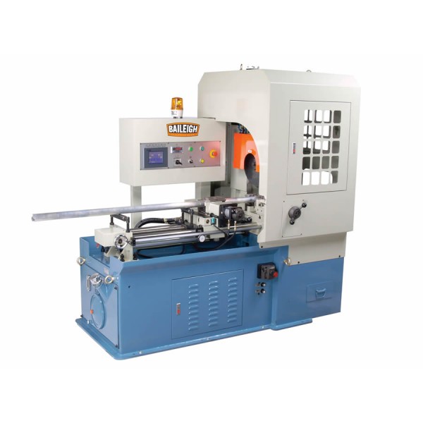

Have thought often about building a cold cut saw ,has anyone done this ?
Industrial? How big? Three phase?
I bought a 14" from a local welding supply store.
Was amazed by the way it cuts metal. :thumbsup:
/ Cold cut saw #7
That Alfra looks like it shares a lot of components with the 14" abrasive saws that you see everywhere. It has a motor that runs about a third the rpm of the burners and of course has a very expensive blade.
Cold saws can be a little messy, the coolant has a tendency to migrate along the material and get inside tubular items, so keeping an immaculate work area with one would be impossible. The blades do stay sharp for a long time with reasonable care, and can be resharpened. They are quite brittle and can be broken easily if the material isn't firmly clamped down or if you slide something into it. I've got several blade chunks that I brought home to use for tooling.

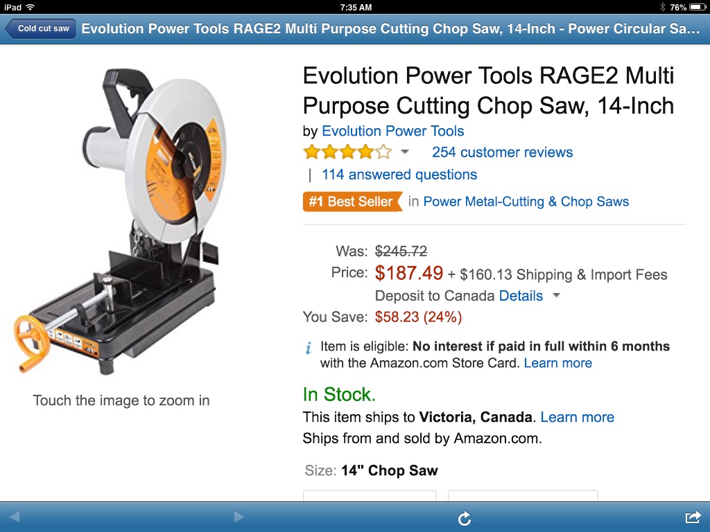

Yep thanks for the clarification. I for one, am interested in a dry cutting saw as a replacement for my Dewalt 14in abrasive cut off chopsaw. It just doesn't like angled cuts. I go to my local welding supply for metal and they do any perpendicular chop cut for a buck! I don't have the floor space for a fancy horizontal fluid cooled bandsaw anyways. I do have my eye on this saw...

Mark. I clicked on your link and this is what came up:
Check out the "shipping and import fees". AND it would still have to be converted to Canadian dollars. :D

Yikes... I don't see any of that. $187.49 and free Amazon Prime two day shipping for me.
Yup.
Welcome to "my world". bienvenue au Canada :D
