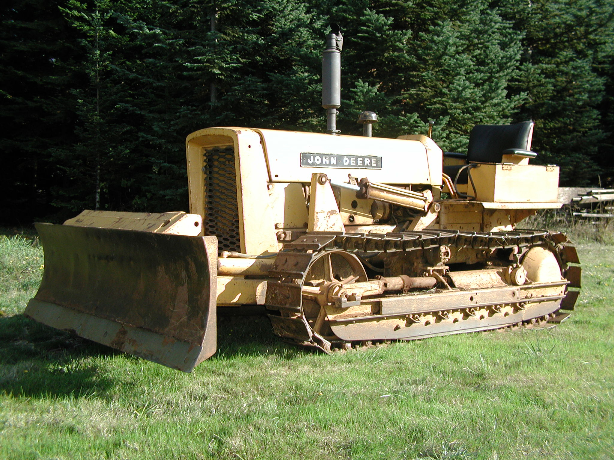

I have a 1959 John Deere 440 ICD with a Detroit Diesel engine, no glow plugs and uses straight 40W oil.
It was very hard to start cold until I installed core plug block heater many years ago.
It made a huge improvement, was easy to install and no leaks.
