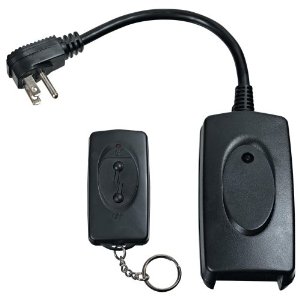

I bought a remote on and off switch for my Rad Hose Heater. It has a key fob much like what you use to lock/unlock your car doors. Cost about $15 and is rated for outdoor use but my tractor is keep in the barn. I hooked up a small light also so I can see it come on from the warmth of my house. The light sits in the barn window.
This is what I have.
[ame=http://www.amazon.com/Woods-32555-Weatherproof-Outdoor-Converter/dp/B001Q9EFUK]Amazon.com: Woods 32555 Weatherproof Outdoor Outlet Remote Control Converter Kit: Home Improvement[/ame]

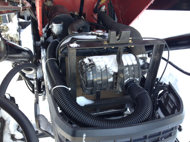

Warm air intake for those -30 days. In taking air from around exhaust manifold and muffler. Engine warms up faster and combusts better on extreme cold days
