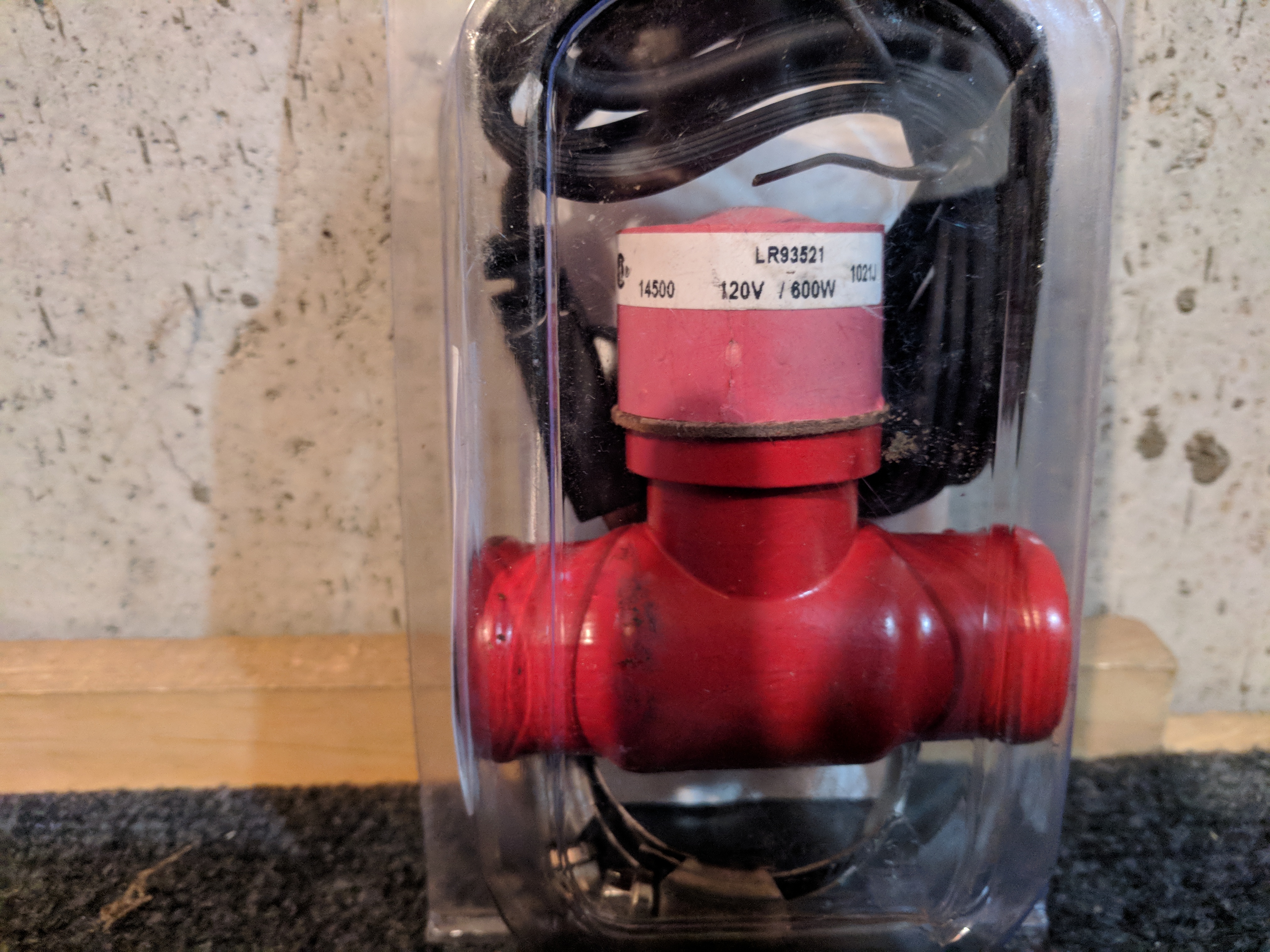

What is Howes? As LouNY mentioned above about the install being critical, the lower radiator hose in my tractor is so short and flat, I don't see the inline heater working. I got looking at it yesterday and I think I am just going to return the one I was sold.
/ Cold Weather Question #23
Howes is a fuel treatment like power service
/ Cold Weather Question #24
I think you are over thinking it. My Kubota has a block heater but I rarely use it. I got it in case I had to leave it outside in real cold temps and because it was just as easy to let the dealer install it. But it starts just fine without it. Sure it's a little harder on the engine but no harder than on your car which most likely gets started a dozen times when just as cold. If it's really cold I will turn the key on, let the glow plug light go out, turn the key off and then back on and let the glow plugs come back on once more. When it starts it'll smoke some and run a little rough but it quickly clears up. If it doesn't then chances are there's an issue with your glow plugs that you should get fixed. The last thing I would be doing in sub zero temps is trying to splice in a block heater into radiator hose.

On an electronically controlled engine. I have seen it where a block heater can make the engine harder to start when it is cold. With warm block the ecm temp sender thinks the engine has been running and the ecm will not go into cold start mode. If you are concerned I would warm the battery or use the space heater in the shed warming block and air. Getting enough cranking speed is important. Do not stop and start.

Yea; I have decided I am not going to worry about it. I have the battery on a minder, and I am just going to run the kerosene heater in there if ever need be. With the snow around the sides and back of the structure, (we call them "heat banks" here) and the front zipped up, that little space warms up amazingly well with the heater going for a few hours.

I prefer the howes and power service additives, but cant beat the ole kero. torpedo heater directed up under oil pan! I stay with mine and move it around a bit as engine warms up.---takes a while, but worth it when you here it start/run fairly decent, until it warms up!! thanks; sonny
