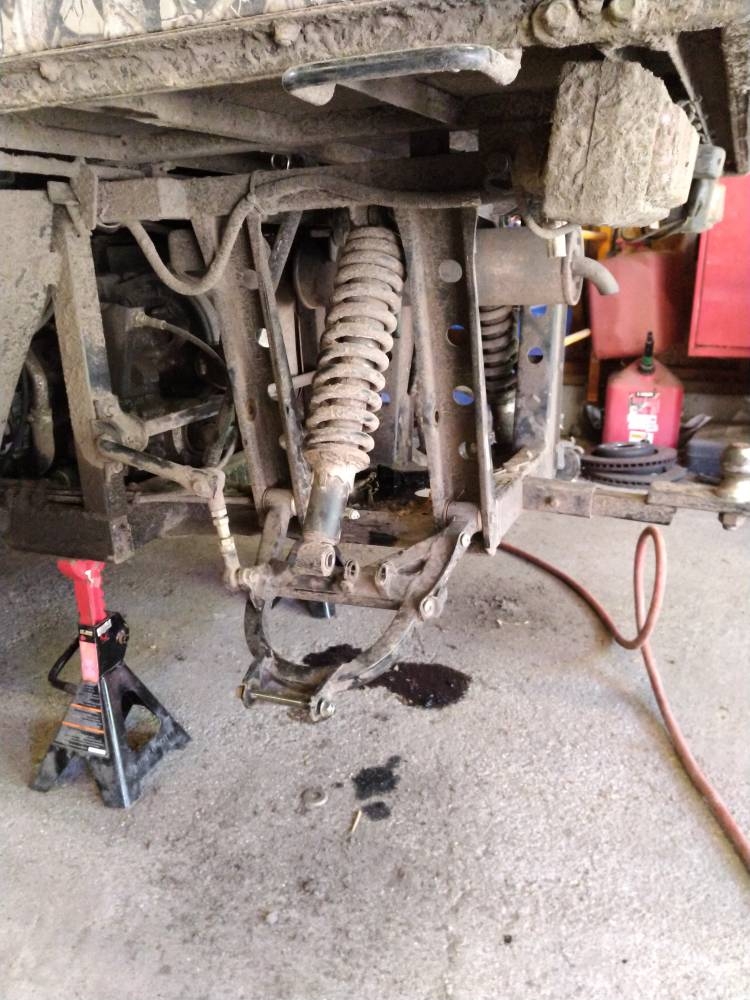

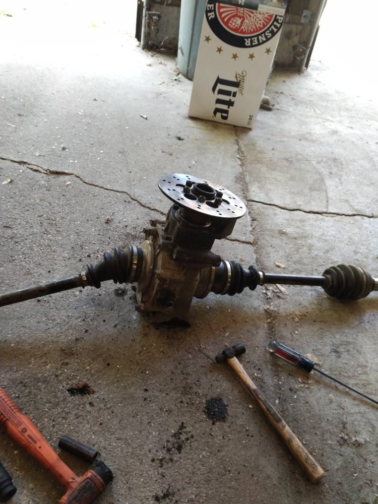

Small things like parking brake can't be adjusted. No safety on it and it's automotive style so easy to overlook. Transmission was solid, no issues. Front axle was good also.
Rear axle on ours not so much...actually it sucked. Nut holding the input pinion shaft loosened up. Smoked the bearings. It was never right after that. Good thing is rear axle is easy to get out.

Our axle issue I hope wasn't a common problem. You can't even drive a mile before it heats up, smokes and then seizes up.
