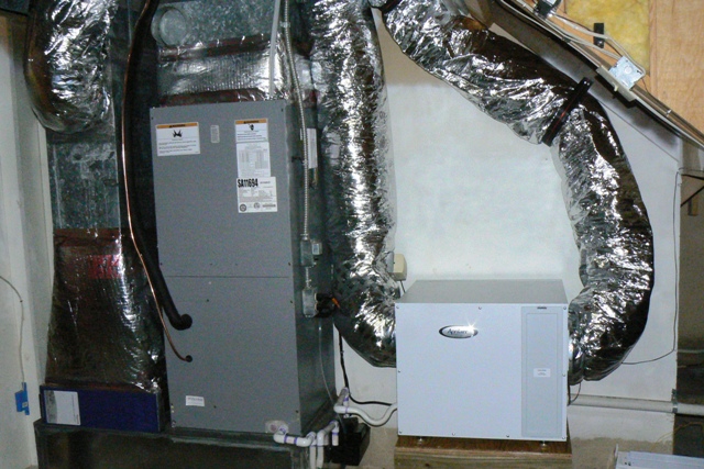

For the last 15 years or so have been using a Aprilaire dehumidifier. The unit runs constantly in the summer, tied to the first floor system. On average, brings all three floor levels down about 5-10% in RH with the first floor generally never getting over 42% RH, which leaves me running the t-stat at around 77F in the summer.

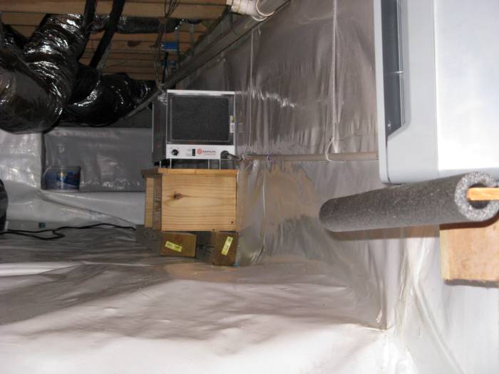

There is something between the plastic we see and the dirt, some sort of ruffled black plastic thing. Cannot get under the plastic we see unless we untape around the upper edges. Did some retaping where we enlarged the hole. Old tape doesn't hold as well. I'm not touching the tape in place.
Humidity is down to 47% now. Turned back the humidistat control on the Santa Fe.

Out of curiosity, if you ever get a chance, please post a pic:D
Still a little confused (easy on my end). I've really ever known take offs being metal on ductwork, including ductboard. Aware of plastic diffusers, but never seen a plastic take off.
Posted a pic earlier that shows some of it. I'll post it again. That duct work you see to the left and goes up above the Santa Fe is the new plastic duct. It's fatter with more insulation than the old (dirty) ducting.
Ralph
The irony is I was going to say the only thing I really see (because I was looking at that picture as well) was the vinyl flexible duct:D I assumed (my fault) when you said take offs you were refering to the tab collars that are metal that connect to the main supply and return duct.
