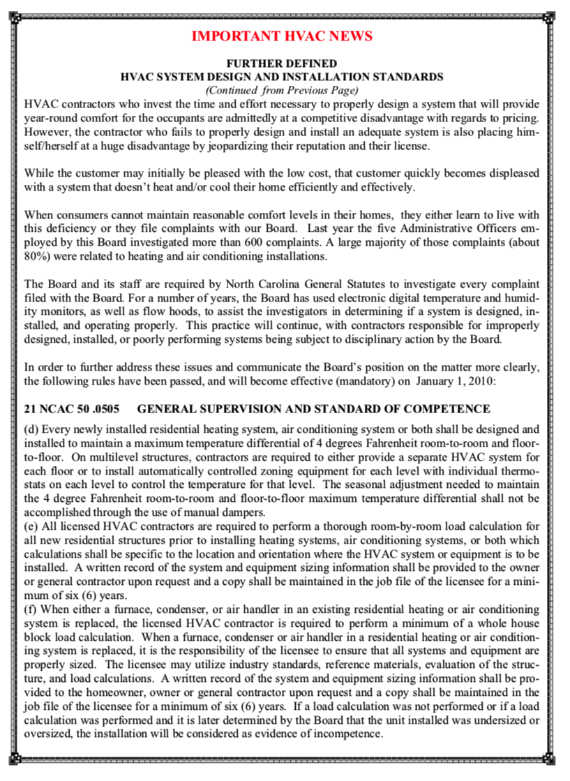

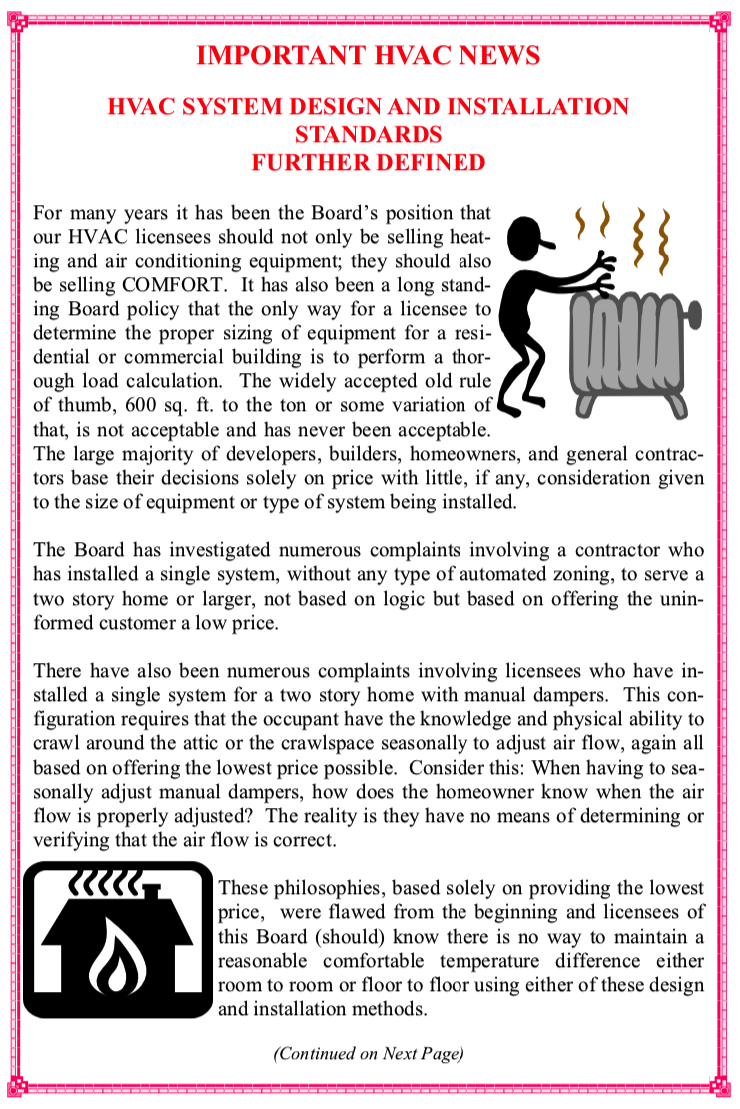

Yes, you're correct, it does sound like a problem being built into a new house. Generally speaking, newer custom homes being built NOW do address these problems with moisture in crawl spaces if a crawl space is used. That said, when I first move to NC I dated a girl from Raleigh. Her brother lived in nice single home cookie cutter development, nice two story homes that had basically 3 models of homes in the entire development that all had gas packs on the outside of them. The flex duct ran under the house into spyder box with flex, that was then run to the second floor.
Since her brother knew I was in HVAC, he asked me about temperature issues he was having upstairs. Issue was he had one t-stat on the first floor, and 10' high ceilings on both floors. I basically told him he was screwed because if you looked at zoning the system, the ductwork would still have a hard time getting the air where he needed upstairs and he'd be spending a lot in labor and materials for a solution that would basically be a long term bandaid (to redo the entire ductwork system properly would cost an arm and a leg in labor alone because you couldn't rebuild the house and had to deal with the structure itself for ductwork). All these homes were built in the mid to late 90's in this development, and I couldn't believe someone would build a nice home like that using the HVAC system / layout they did.
Guess what finally happend in 2009? Read below. Long story short, became code to maintain no more than 4 degree differential in any areas of the home per new building codes pertaining to HVAC (keep in mind, doesn't affect all the homes that were built previously). On a sidenote, this only one of many reasons why a "professional license contractor" in a trade will generally be more expensive that your neighbor who knows a babys moma who lives with a guy who can do the work cheaper:laughing:
As for crawl spaces, welcome to the Southeast. Heck, I didn't really know what a crawl space was living in the northeast. As I mentioned before, I always thought package units were meant to go on a roof, not on the side of a house:laughing:
