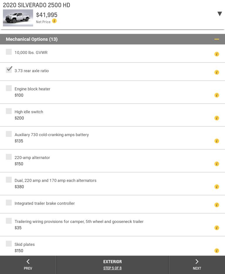

It's interesting though that GM chooses to give it's 2500 truck a 11,350 GVWR. Seems like they would be screwing themselves on fleet sales.
I think you are incorrect about the GM/CHEVY 2500. It is definitely available with 10,000 GVWR. I have seen them on local dealer lots. Chevy Options2020.jpeg

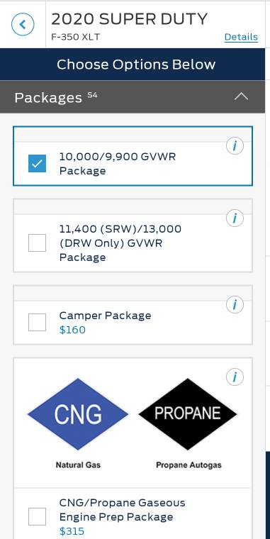

P.S. You can also order an F350 SRW with 10,000 GVWR if that better meets your needs.F350%20Options%202020.jpeg

I think you are incorrect about the GM/CHEVY 2500. It is definitely available with 10,000 GVWR. I have seen them on local dealer lots.View attachment 663725
That's interesting, because the folks at my local Chevy dealership, commercial vehicle department, aren't aware of it. Too bad for them, because I went out and bought a Ford F250 longbed based on their lack of knowledge and will likely remain with Fords from here on out (unless I have problems with it). Actually, I'm pretty impressed with the Ford. I just did a weeklong trip and put the first 700 miles on it, with an average of 19.6 MPG. It has more road noise and a more jittery ride then my 2016 Chevy 3500 DRW, but part of the road noise is the Ford tires are more AT than the street Michelins on the Chevy.
