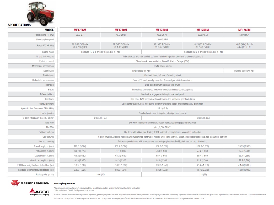

This is the 1735M Cab you mentioned. Some Mfgr's keep the same frame, wheelbase etc throughout the series just upping the ponies. Massey however does not. You will get a slightly larger machine when you 'up' through the hp models. I believe my ordered 1740M to have about a 2" longer wheelbase than this 1735M model, but, both of these use the same attachment series. Now the 50 gets the larger/heavier loader, backhoe etc. all up-sized a bit to match the upsized tractor. This did interest me, but I had to draw the line in the sand as this can can just go on and on... basically you put yourself in a "up-sell fever".
1735M...... [click thumbnail to expand]

When I bought my 1735M my dealer told me the only difference was the ponies, then I pointed out the same longer wheelbase as you mentioned. He had both right there on the floor and we measured them and they were the exact same, but...maybe we didn't measure correctly or in the correct spot. We measured from center of front wheel to center of rear wheel. The 1740M had skinnier tires, but that should not have mattered.

The wheelbase for the 1740 is listed as being 1-3/8" longer. I have no idea why it would be longer since the everything but the HP is the same. Maybe a larger front axle???

My dealer had the 1750 there, definitely a bigger machine than my 40. I have to believe that OEM chart as correct.

This attachment won't open for me, but I am new to the forum. Does it work for others?

Yes, the 1750M was bigger
