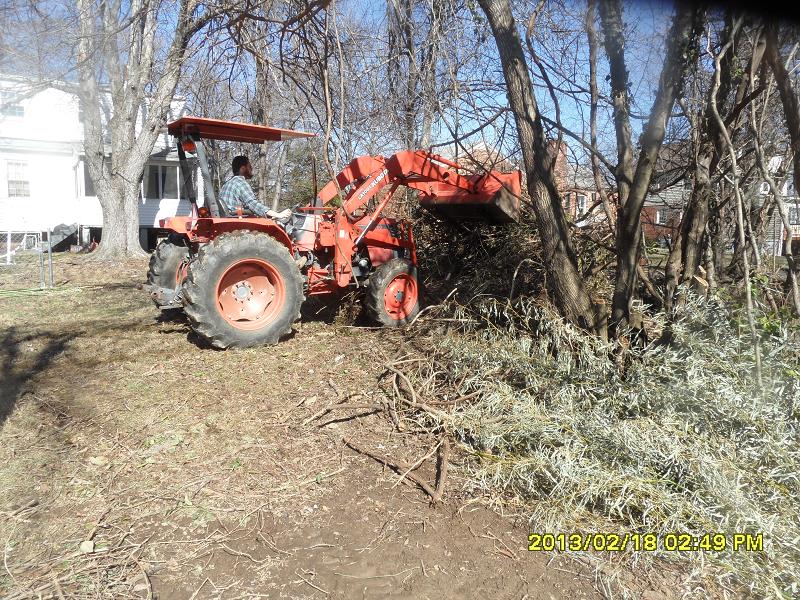

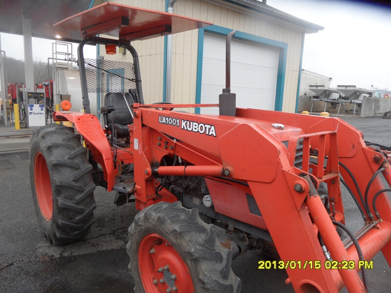

M4700, 4WD, LA1001 loader, son
These are pics of my 1998 M4700, 1400 hrs, 51HP maintained by the Leesburg maintenance shop, $12K out the door. Looking at a new one it probably would have been about $25K after discount. Sure it's not shiny, but the left over $$ will buy the wife two dormers in our retirement house and a few implements.
There are 3 at http://www.tractorhouse.com/list/list.aspx?manu=KUBOTA&mdltxt=M4700 for similar, slightly higher prices. And they are not Tier 4.
Based on past experience with my B7610 I'll be able to use it for years with minimum maintenance. I won't be working it 1,000 hours a year (of course Leesburg only worked it about 100 hours/year), if I was I'd buy new, pay a lot more and expect it to pay me back. I admit it's a little big for my 1/2 acre lot :) but it's due to migrate down to Mississippi in a few months.
