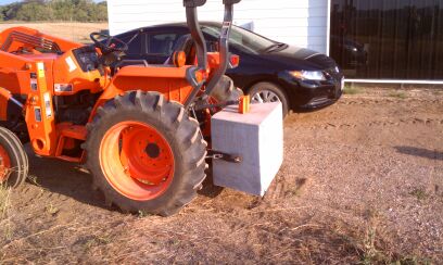

RNR has the best advice, go drive some. You might even ask one of the dealers to let you demo a machine on your site. I drove tractors for a week at various dealers before making my decision. Customer service helped put the Kubota dealer at the top of the list.
Mine is a 2wd gear model with FEL. It is light in the rear end without ballast on the hitch but I haven't gotten it stuck even on theses red clay hills during the winter. Does it spin some? sure it does but so does the 4wd Kubota M5700.
My FIL farmed these red clay hills for nearly 50 years with 2wd tractors and never got one stuck and I have yet to get one stuck (24 years). My personal opinion is that 4wd is over rated for hobby farming. For those of you doing extensive loader work or moving snow on a regular basis it IS essential.
To say 2wd tractors for loader work are obsolete goes a little too far. Mine works fine with ballast on the 3pt hitch.
I built a 1,000 lb counter weight and wow...what a difference!
While I admire your inventiveness, there have been MANY times I have tried to move a large rock with the FEL on my Deere and if I didn't have MFWD there was no way I could move it. Now, about your counterweight...you don't state how often you actually have it on your tractor or for what purpose you use it for. On my tractor the MFWD option adds 300 lbs. of weight and I cannot remove it. HOWEVER, it is ALWAYS available, I don't have to (bleep) around installing or removing it, and best of all I still have the option of installing an implement (blade, plow, disc, etc.) on the rear 3 point. And as far as fuel economy goes, I would rather haul around 300 extra lbs. all the time than 1,000 pounds some of the time, especially when I don't have to waste time installing and removing a rear counterweight.
   / Compact 4wd v. Larger 2wd utility tractor? #84
That sort of overlooks the fact that to take full advantage of the FEL you're going to need a counterweight regardless of 2wd or 4wd, so you still wind up hauling extra weight around, and have to mess around removing and installing it with some regularity. Hanging an implement off the back helps, but that's not usually enough weight to truly max the FEL potential.
   / Compact 4wd v. Larger 2wd utility tractor? #85
And if you're going to have a counterweight why not consider a gannon or similar boxblade with top and tilt- right around a 1000lbs. right where you need it and very handy for motorcycle trails, driveways and many other uses...
