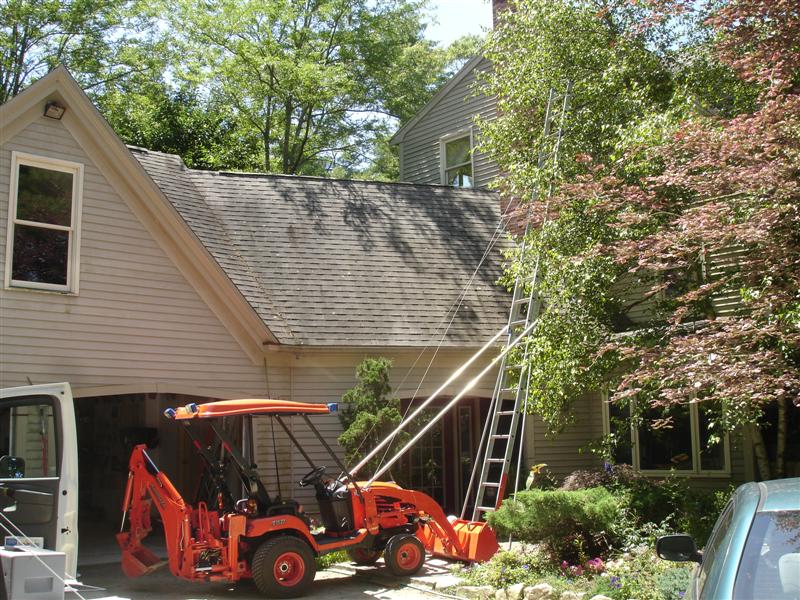

   / Compact BX24 BH Dolly #17
Thanks RMAN, excellent idea on being able to drop the carrier - I will build the subframe like a fork setup with a couple pins to lock the carrier portion in place and will go tall also vs deep as the woods are pretty tight here. By the way, thought I knew every square inch of this tractor but found this under the toplink mount today - any takers?
Dave
no problem. FYI I built my firewood carrier around my harbor frieght quick hitch so when its loaded, I can back up to it and lift and swing locking arms down and GO! Same with dropping it off. One thing I learned the hard way is that the carrier needs to be at least 2 inches higher then lowest point of 3 pt. Reason is the weight of the wood does funny things to metal and I couldn't drop and go. I had to cut and reweld the 3 pt connections on carrier.:mad:
As for the red button, don't quote me on it but I believe its a overflow vent for hydro. I have same "button" and its not pressable, but the red portion is spinable. ;)
#18
RMAN - have to thank you again - I am in Chatham Ma for the last couple days and the next week for work (120m round trip = dangerous amount of time to plan monster garage projects) - am glad I went with your subframe idea with a detachable carrier. Could add all kinds of stuff to it like a back blade or even . . . . . . . . .. . . another ladder :confused2:
