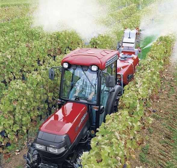

Most/all of the vineyard tractors have more hydraulic capacity the compacts (12gpm vs. 8gpm or so). important for running hedgers and other implements. Was expecting to see compact with a shuttle shift have more implement flow than the comparable hydro. Doesn't seem to be the case? Anyone know why that is?
Because compact tractors are not designed for operating hydraulic powered equipment. Large capacity hydraulics requires more than just a bigger pump. They need larger hydraulic oil reservoir, increased cooling, more power to run the pump and so on. It gets expensive fast so that is why compact tractors doesn’t have it. For a new member asking for advice you might want to check the attitude at the door. You asked for advice and people are giving it. If you don’t like the answers, don’t expect people to give you different answers to satisfy your predetermined specifications.

I truly appreciate your time and efforts to provide information. Don't mean to sound ungrateful in the least. That being said, there are some things (like needing a loader) that I cannot change. I am trying to find a tractor with most of the characteristics of a narrow tractor but need to meet a few other goals.
Was looking at the Kioti NX line. Hydraulic flow is 16.5 (shuttle), 65" wide (w/o loader). Probably only 10gpm to the implements- not great. It does have a cruise and PTO cruise (?) which would likely be nice for spraying, etc.

Thousands of acres of vineyards around me. The professionals go with vineyard models which usually start around 60 hp. and go up from there. All are cabbed because of the large amount of spraying; most are 4wd even though the land is pretty flat. They also tend towards Ag tires. While there is every sort of dealer in the area most of what I see in the vineyards is Case-NH or Deere, a few Masseys. As previously mentioned narrow tractors and loaders don't go together well, I would be leery of any dealer selling that combination unless it was a smaller, lower hp model intended for the play farmers. That will rule out air blast sprayers which are a necessity for larger operations.
I do have a narrow, small, low horsepower Deere for maintaining 15 miles of Christmas tree rows. Good for a small brush hog, lousy for spraying. The R4s aren't my first choice as this land gets very greasy. If you opt for a small tractor that doesn't weigh much Ag tires might be the better choice. I think it will be hard to find everything you want in one machine.

To OP - My spouse and I farm a 5 acre vineyard with the idea to expand to 10 acres out of a 42 acre site. We are spaced 7' by 4'(double Guyot) and 7' by 3'(single Guyot). We have a ~50hp Landini Mistral 16spd(of which 4 creeper), MFWD, open station, 3SCVs, and it's non-hydro which we purchased for $12.5K with 375hrs on it. It's been a great little tractor with a bigger capability compared to many others in this class. That said it rides a bit high to deal with side hills comfortably. If you're thinking wide rows there are many stable choices in tractors out there. One you might consider is a used Landini Rex in the lower ride height, Ithink they call it a GS configuration. It's heavier than my Mistral and can lift more in the rear. Downside of low tractors is they don't lift as high from the ground up. Such as if you need to use a post hole auger it might not clear it from the ground. As far as sprayers go the CIMA is a fine sprayer and many near me have that one. I'm working my way up to a tilting recovery panel sprayer that will work one row at a time from both sides. With slight side hills on narrow rows the sprayer nozzles/tips on conventional one side two row sprayers without tilt do not get parallel to the spray surface. With the CIMA I think you have good control of spray to canopy distance and height. My preference on sprayers would be to tow it and not carry it. For our 5 acre vineyard in early season I probably use 40-75gallons of spray mixture. Late in the season like now I use 140-150gal which is a reload for me with our 100gal PakTank. One thing with respect to spraying if you can plant similar(harvest timing wise) varieties near each other then you can spray similar chemicals in blocks. For instance right now I am close to harvest for auxerrois and chardonnay and have to use chemicals with short PHI whereas for my chenin blanc, cabernet sauvignon, cabernet franc, and barbera are much later so I may use different fungicides with longer PHIs. One other point with using only one vineyard tractor, like I do, one needs to be prepared to get it fixed and back up and running in short order. I have a smaller Deere 455 garden tractor that mows the alleys, spools out bird side netting, carries tools and supplies anywhere in the vineyard. I also have a Deere 5325 with loader and backhoe that I use to unload deliveries and take care of heavier property maintenance tasks. We plan to get a second vineyard tractor next year and most like a used electric golf cart to quickly run tasks in the vineyard. Good luck with your endeavor. If you have questions fire away but be forewarned that the season is getting super busy right now and my response might be delayed. Cheers
