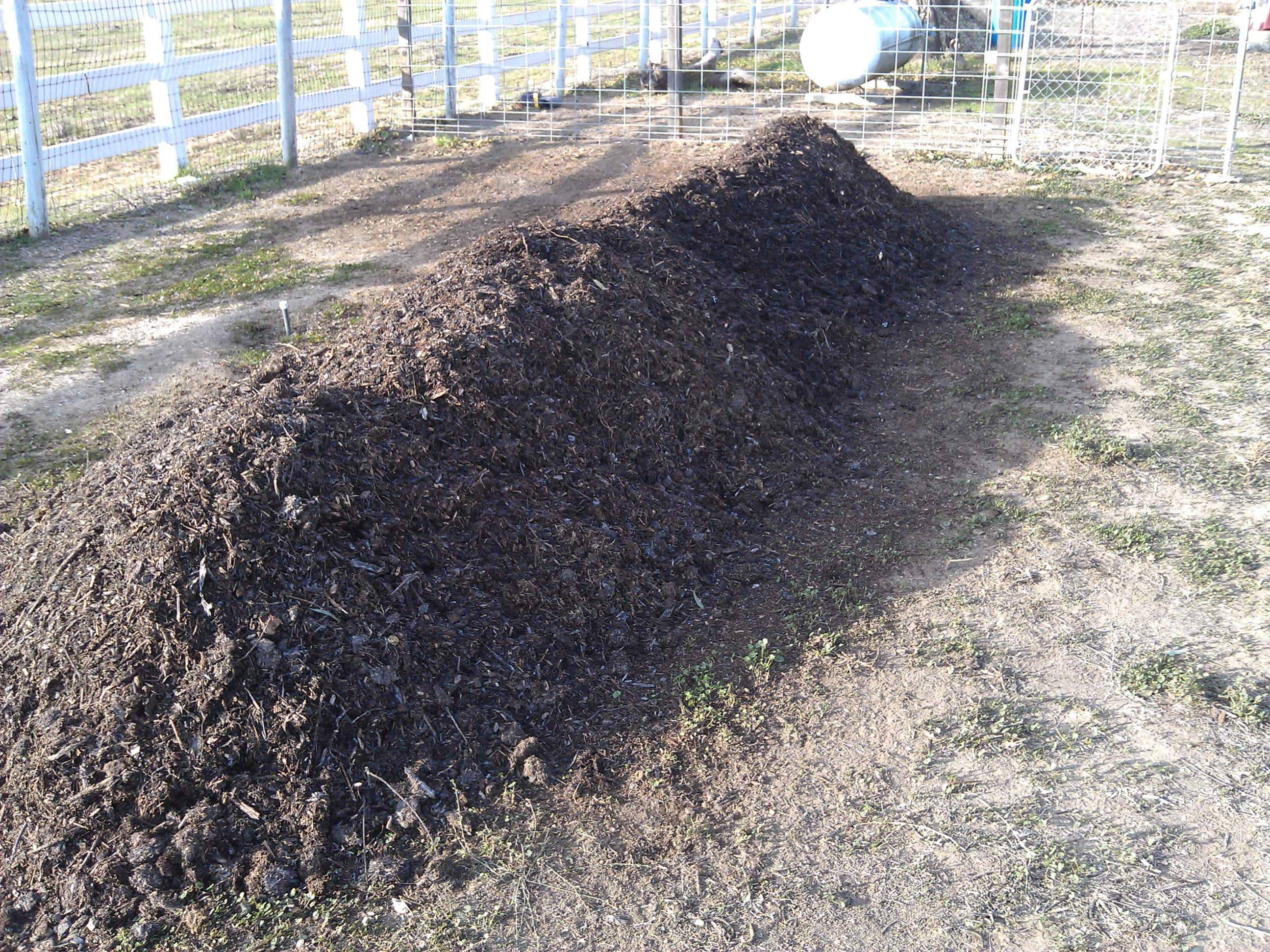

IMAG0335.jpgHas anyone tried to build a compact compost turner of approximate dims 36-40" wide x 24-30" high. I like the look of the Frontier but it is too big and cost too great for me. I have been turning wood chips, leaves, grass and horse manue into compost with great success but turning with pitchfork is now taking to long and demanding on my body. I have a basic concept of frame to mount 30 gallon barrell on side with right angle gearbox under frame turning six inch tube with 6-8" tynes on center converging auger pattern enclosed in a 36" long tunnel of dimensions above. If the wife gives me some help I'll try to upload a short video tonight to YouTube to show my stacks.

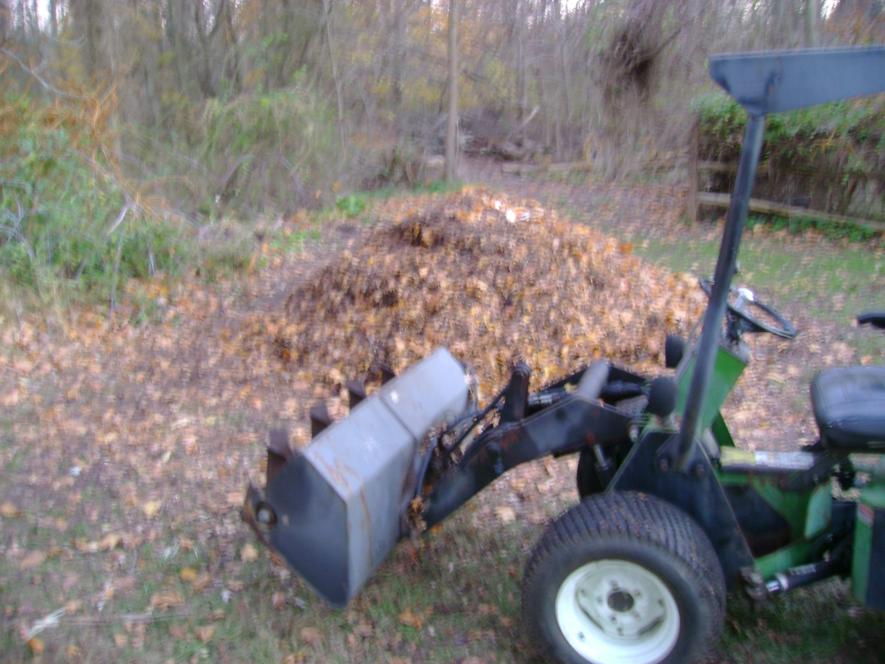

I use my front loader mounted tiller on my power trac. I can roll back all the way and it works similar to the compost turners That is what my Avitar is a picture of. Works great12-2-08 002.jpg
