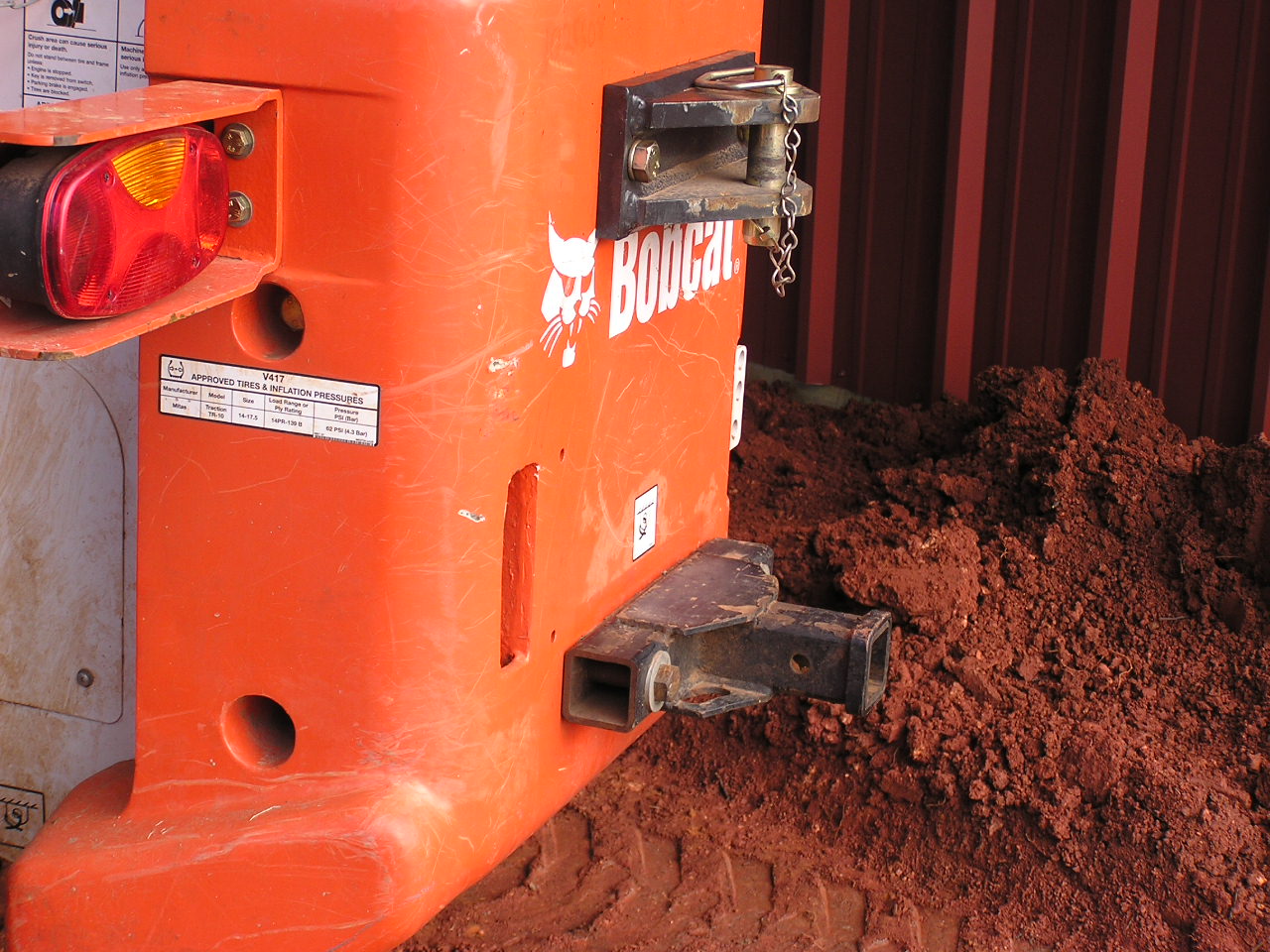

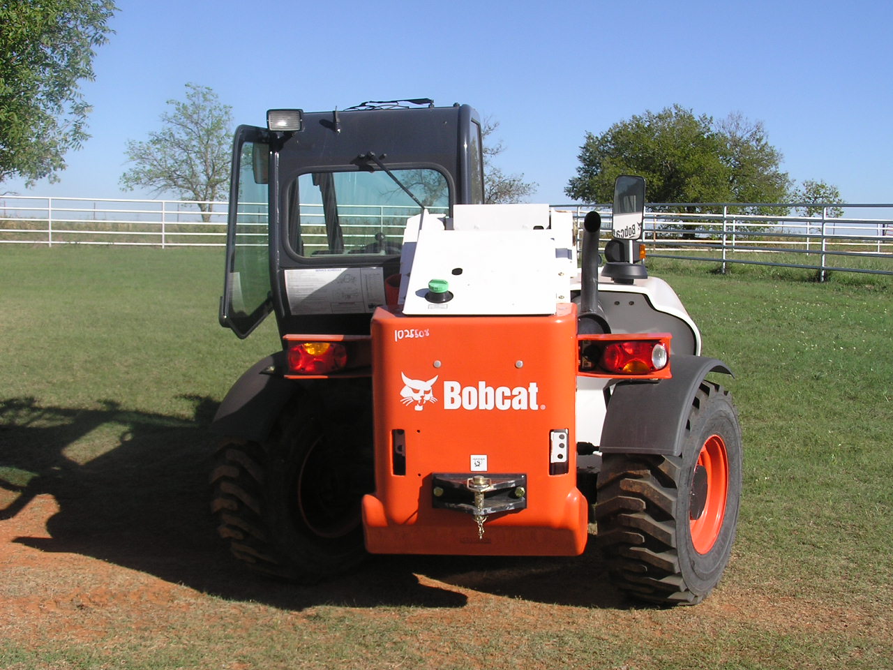

Xfaxman, what is that metal white box behind the rear tail light on your rig?
/ Compact telehandler #387
It is an old ammo box that someone painted before I bought it.
Use it for chain and strap storage:
And another chain storage spot:
And shovel storage place above the box:

Re: tire pressure. I had a tire come off the rim and the guy who dealt with it said it was underinflated and messed up the stem(no good anymore).
I had Haulet SKS 14-17.5 14 PR all around(came with them) and they used the Bobcat 17.5 NHS for the replacement.
Everywhere im looking says 80psi for both types.
Is that correct?
Thanks!
Haulet sks wide wall 14-17.5 14PR

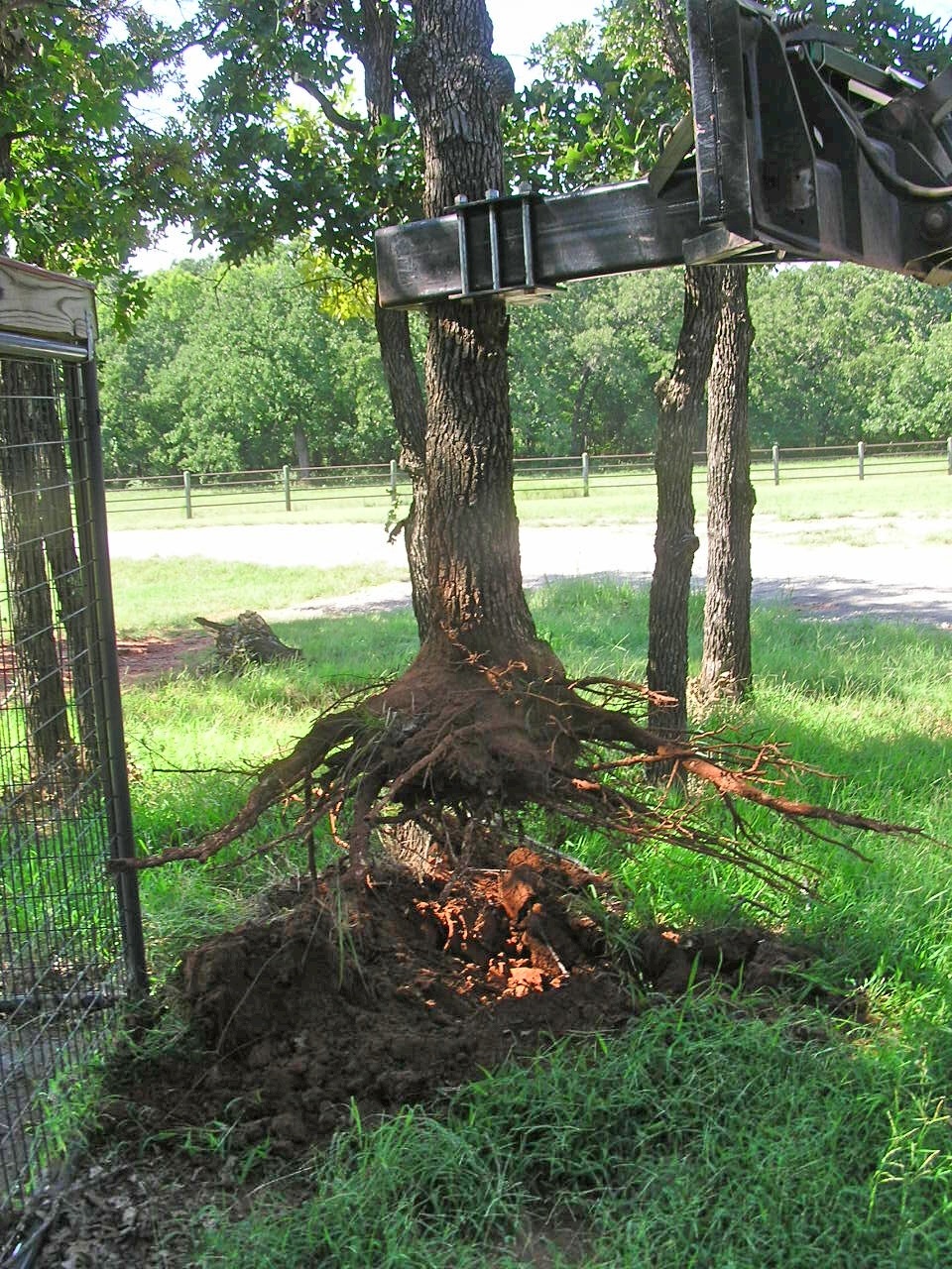

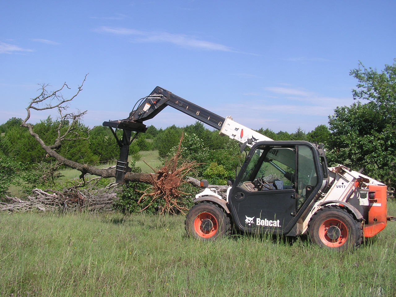

Hooked the chain to the tree I pushed over two months ago:
Dragged it out of the woods:
Pulled it to the brush pile:
Picked it up with the grapple:
View from the seat, pulled forward and extended the boom to put it out over the pile:
Opened the dual lids and gravity grabbed it:
