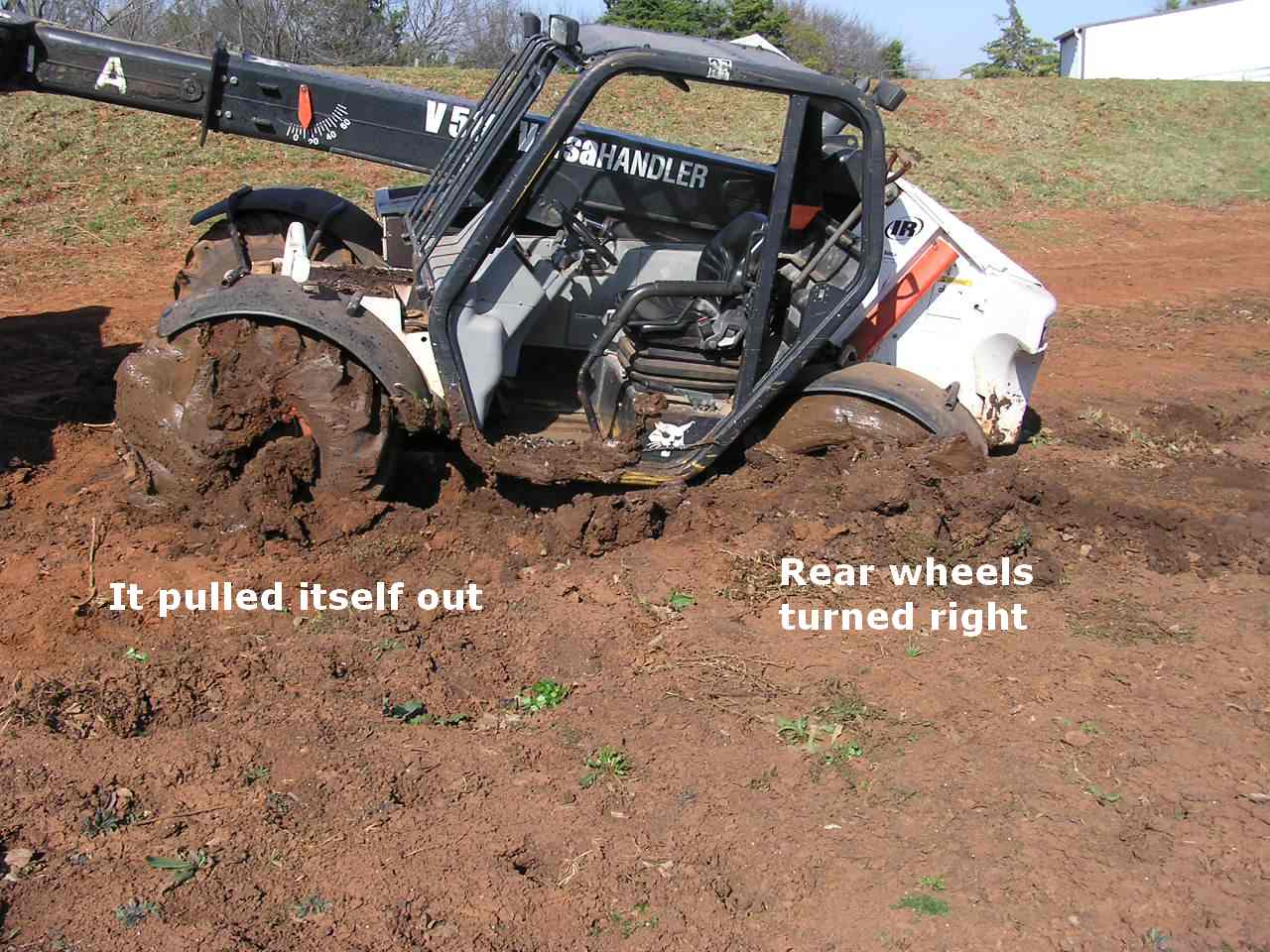

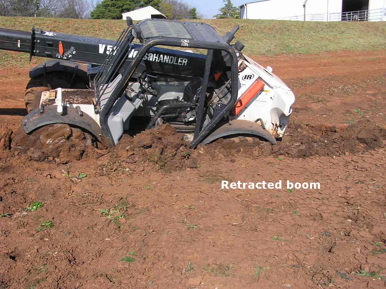

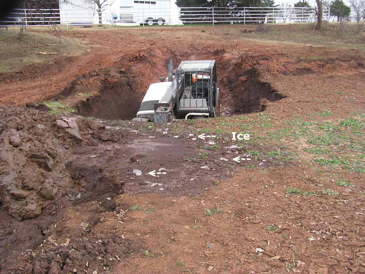

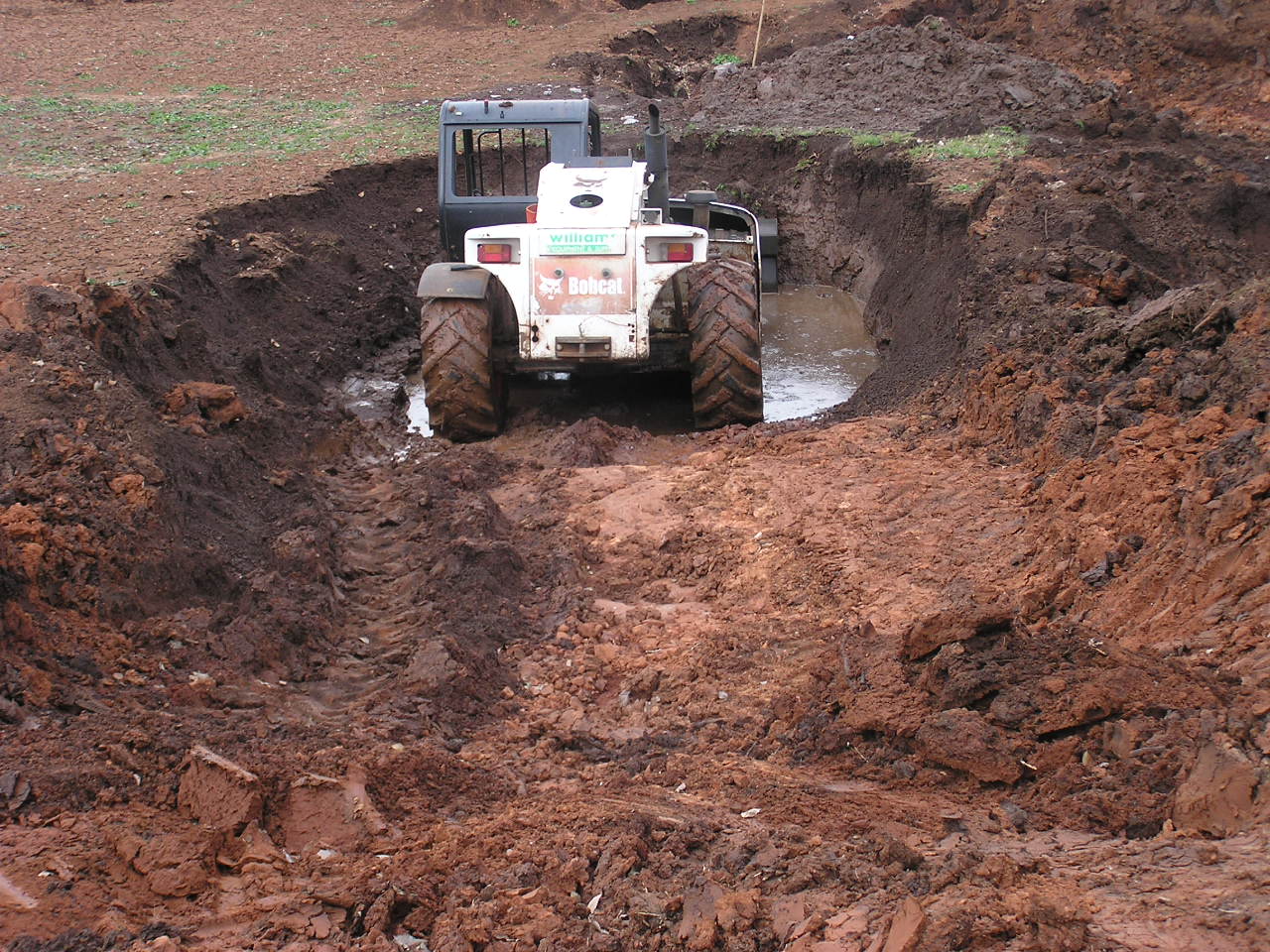

A lot of guys aren't familiar with these machines, so thought I would revive this three year old thread, since it is the only thread that I found searching for Versahandler in this forum.
The Bobcat V518 and smaller V417 Compact Telehandlers are designed for ground engaging attachments. They will definitley out dig a skid steer. They also can extricate themselves from any stuck situation, if the motor is still running.
PB220003.JPG PB220005.JPG PB220010.JPG PB220012.JPG PB220013.JPG PB220014.JPG

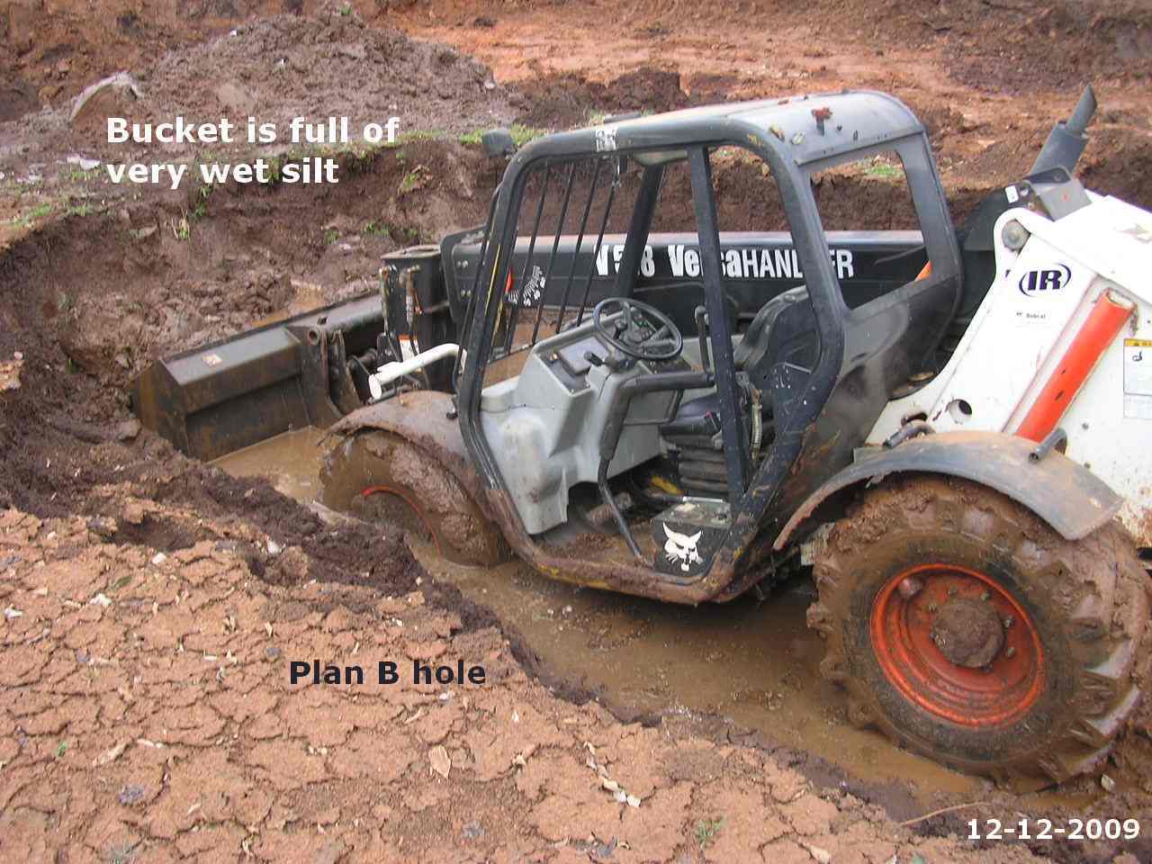

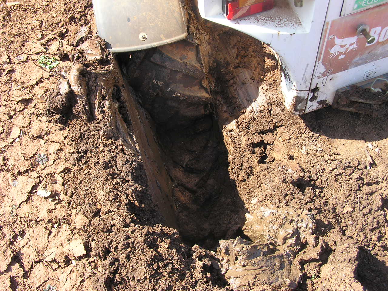

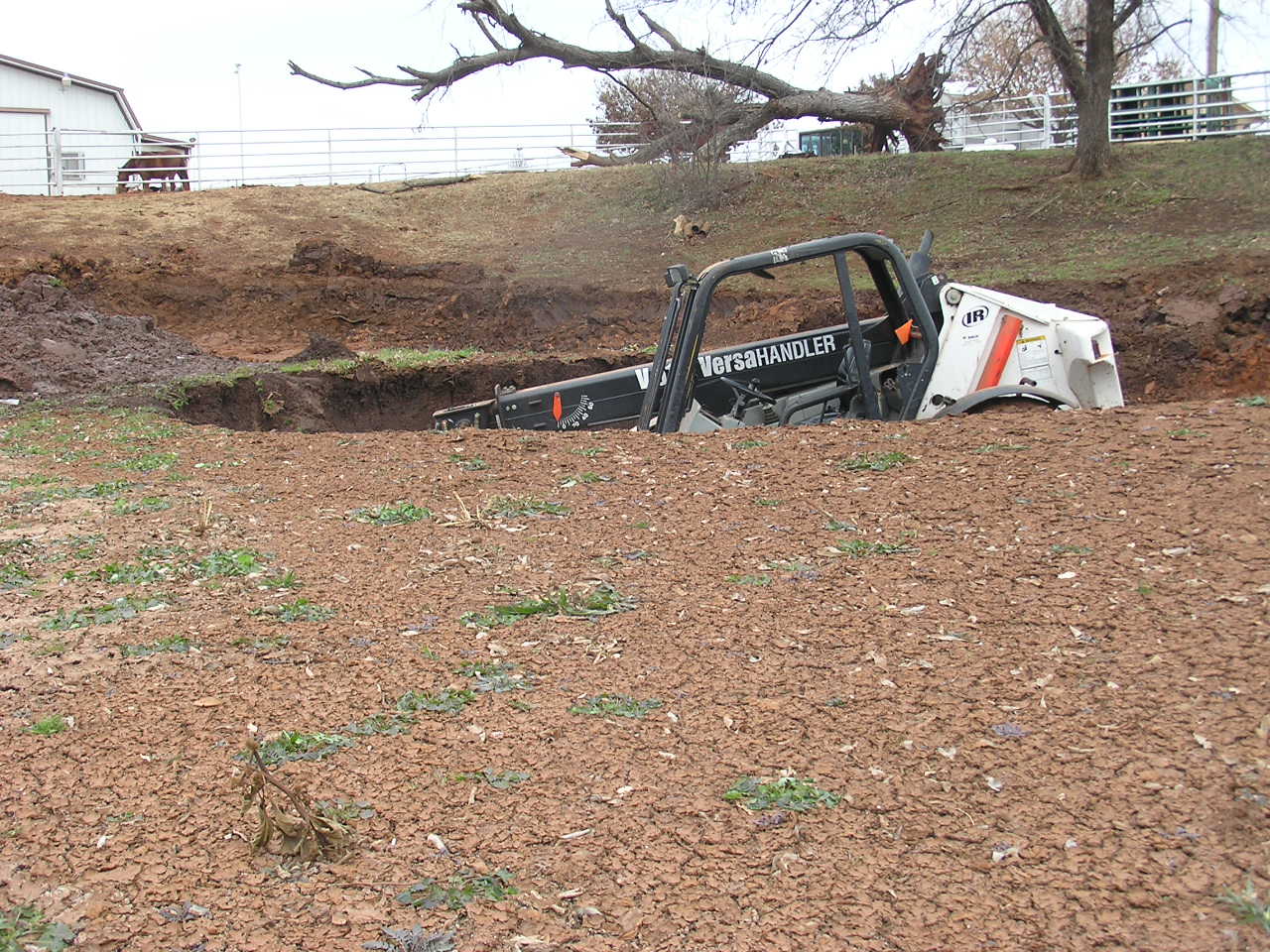

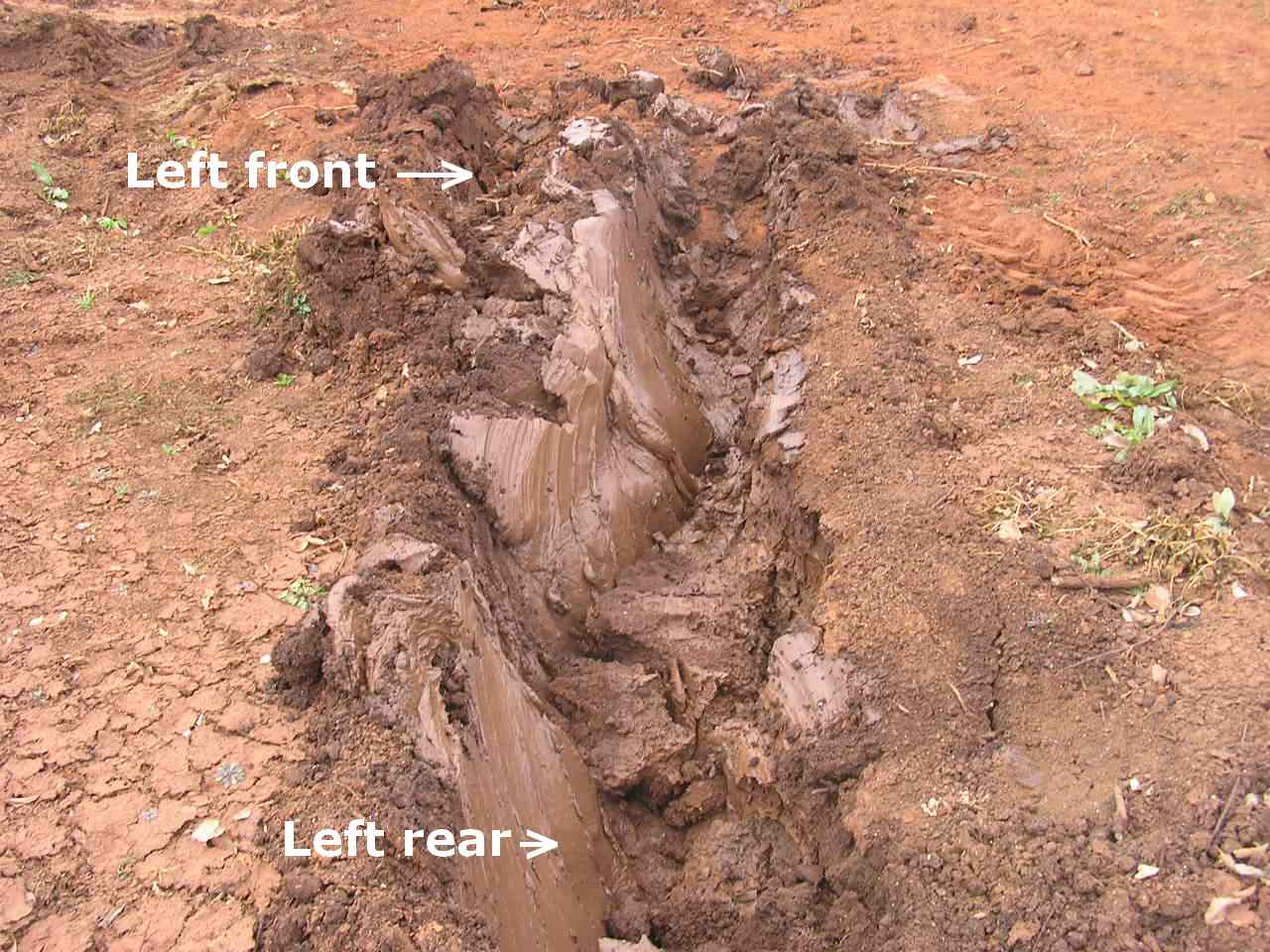

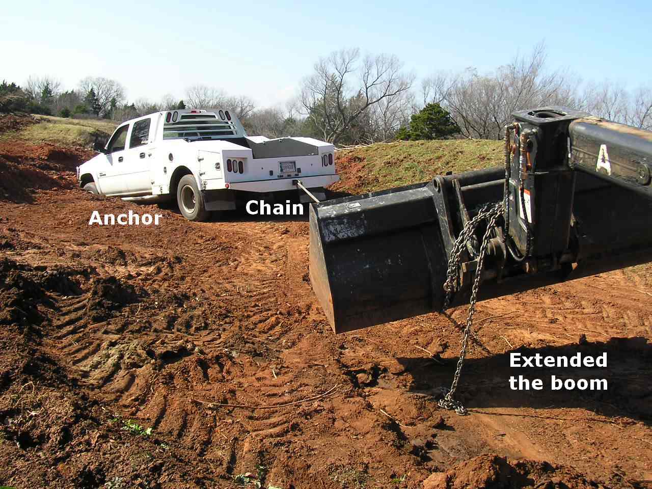

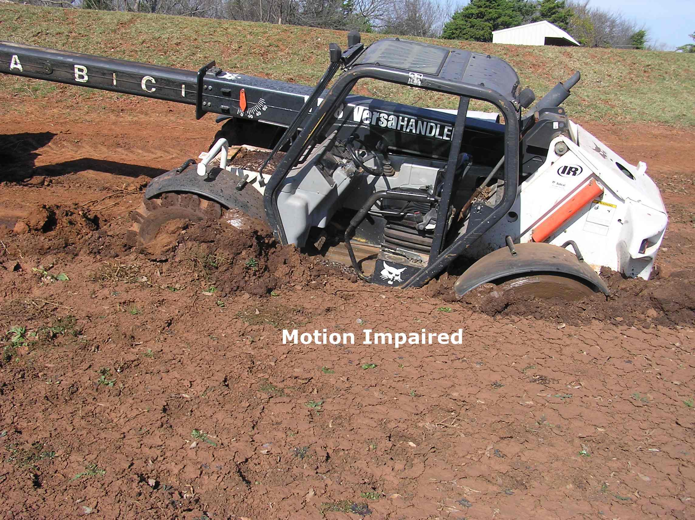

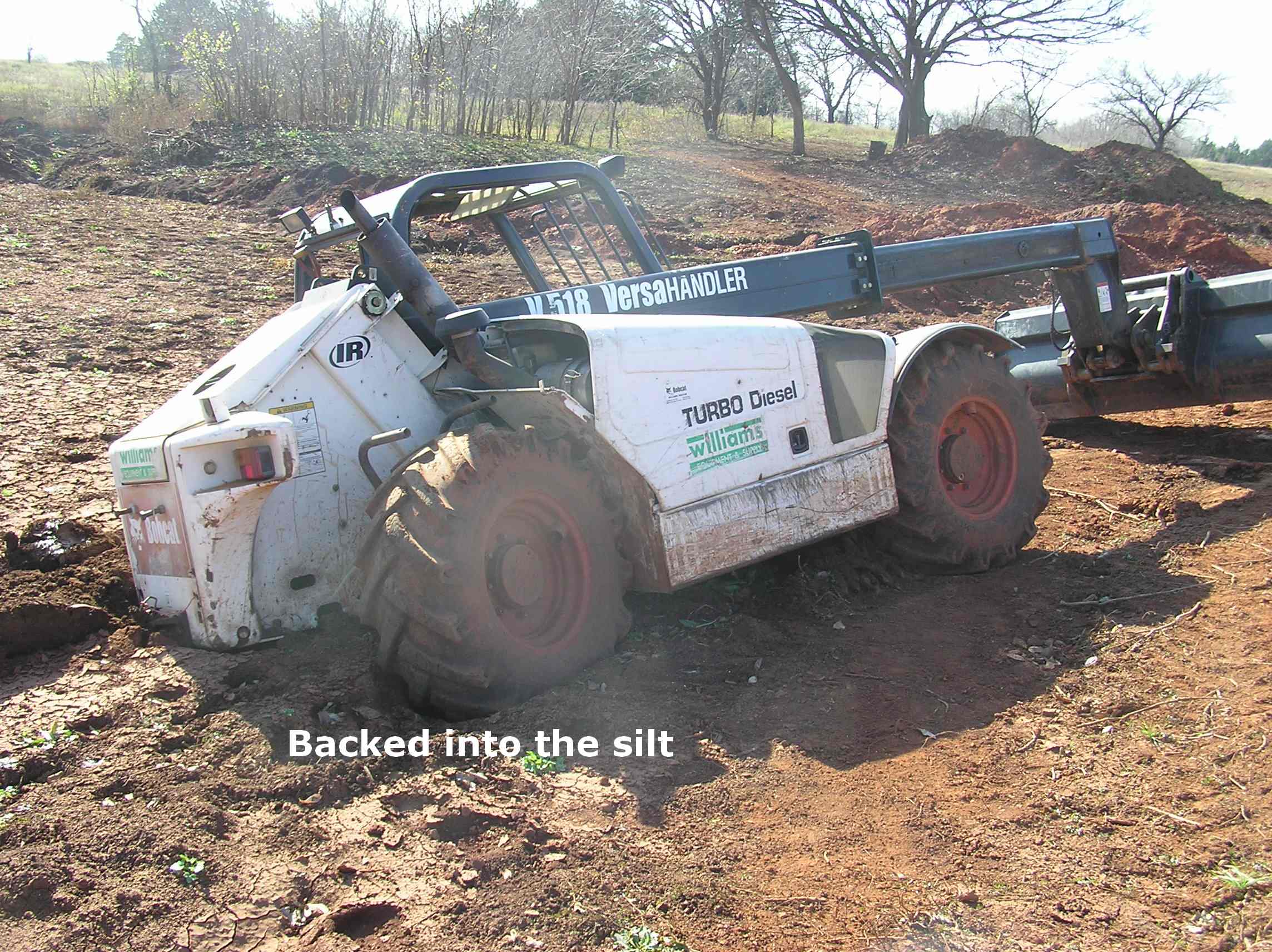

Notice how dry the silt is on top, but under the top crust it is like pudding. I had driven across it with our UTV, no problem.

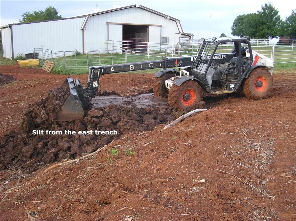

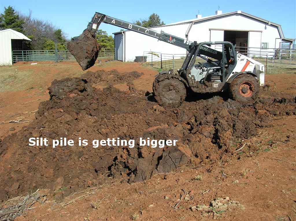

In September 2009 I bought a used V518, to clean out our 30 year old 2 acre pond. The silt was 5' deep, the plan was to dump the silt on the backside of the dam.
The silt pile.

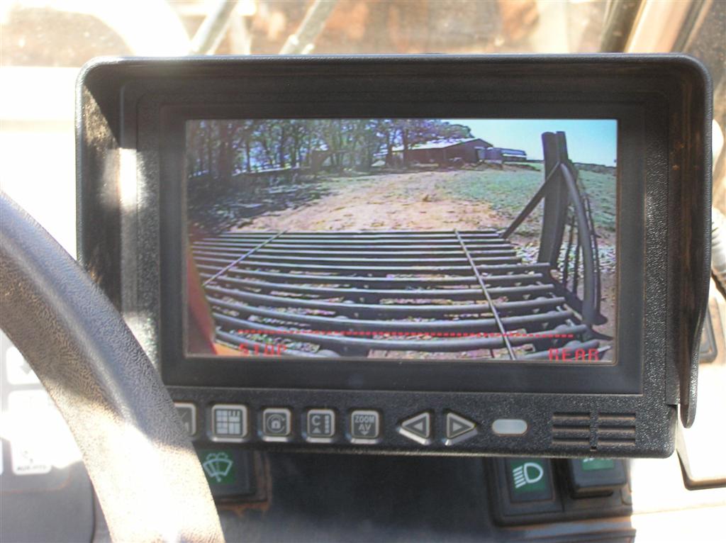

I have thought about adding a wireless camera to my monitor, but don't need it that often for the stuff I do.
P9090001 (Large).JPG P9020005.JPG P9090012 (Large).JPG P9090013 (Large).JPG P9090014 (Large).JPG
It switches to the rear camera when I pull the reverse lever.

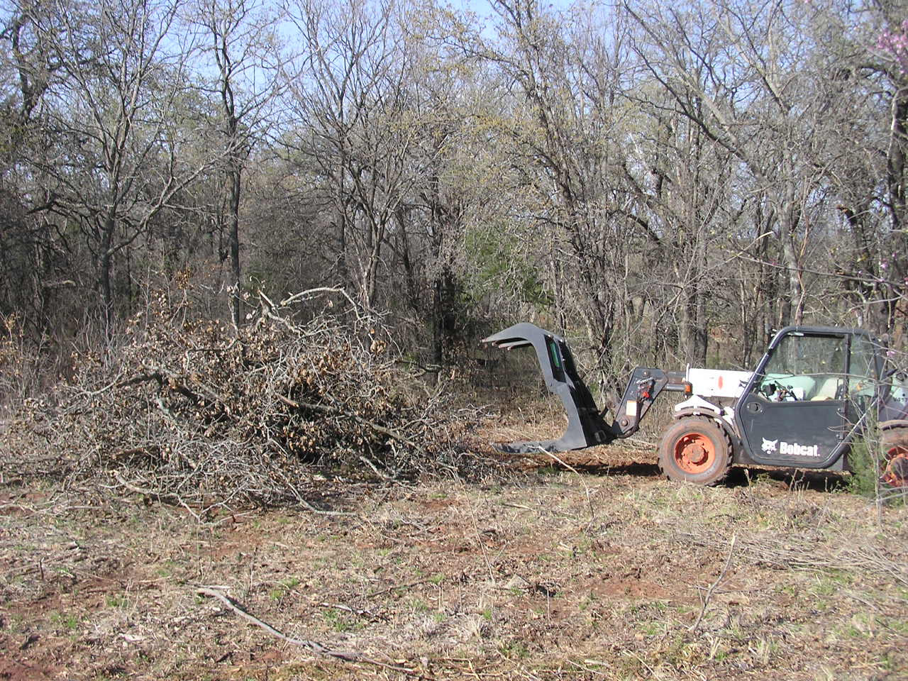

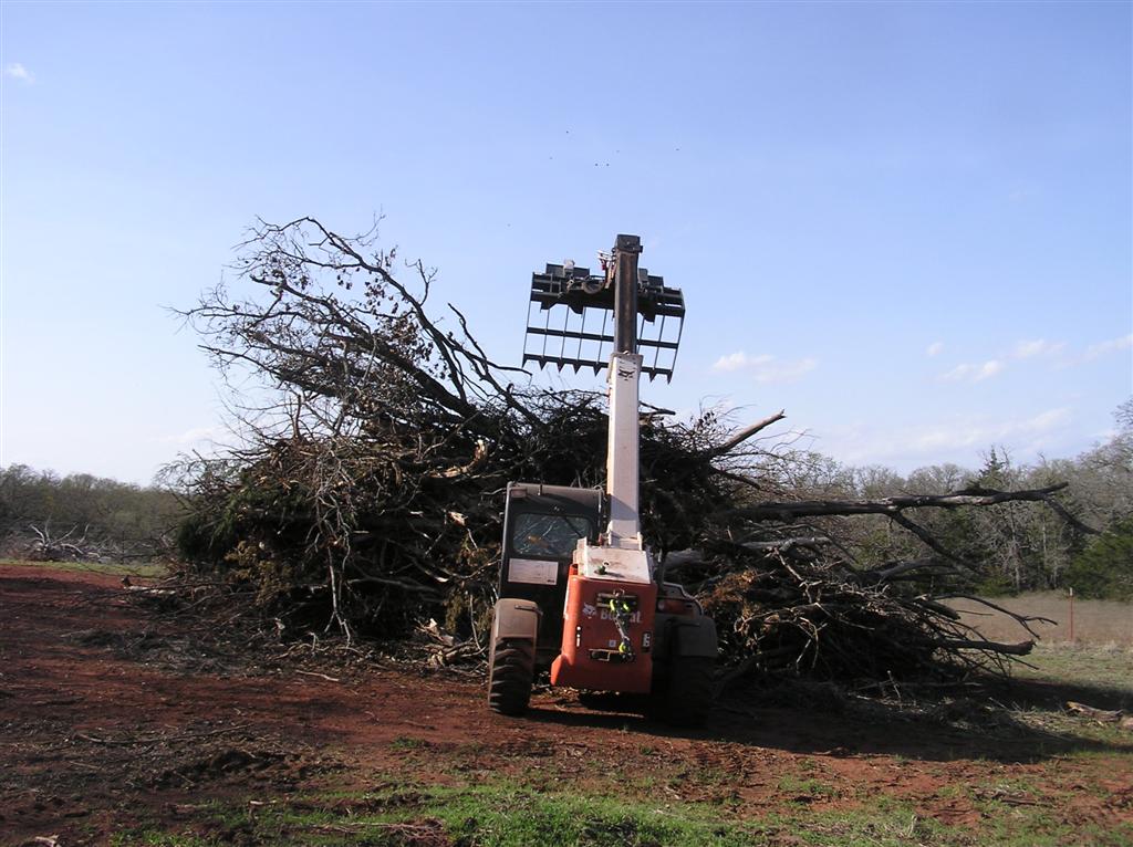

Moving brush with the 6' Monster Grapple, on the V417.
It is a big bite, the opening is 51 inches.
Another big bite.

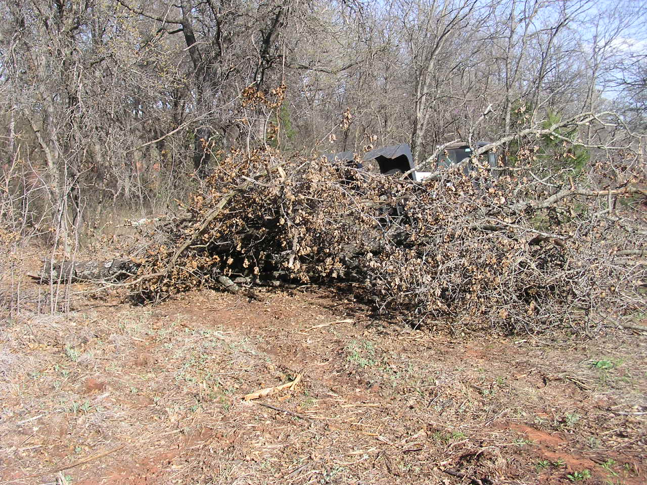

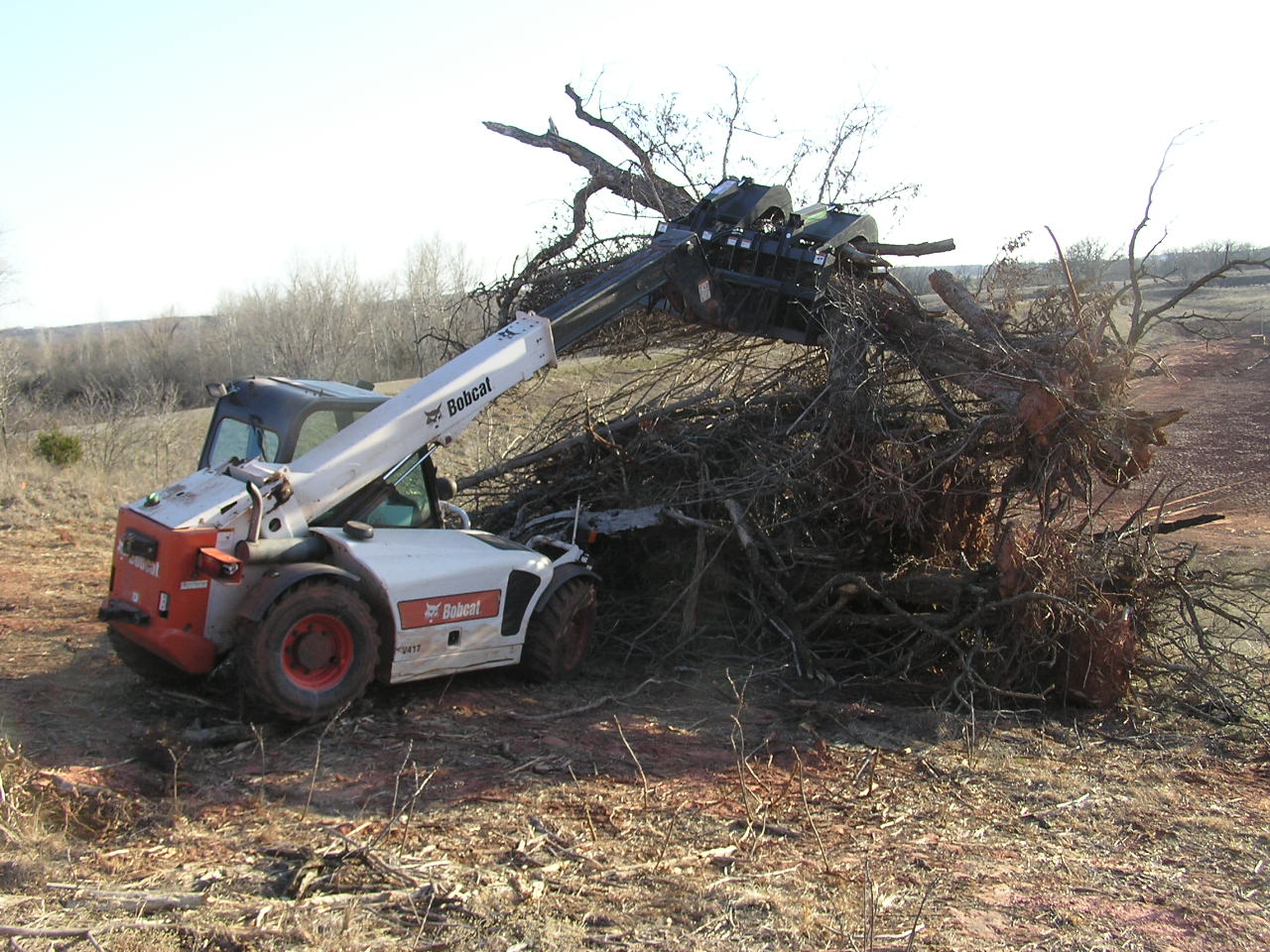

Moving more brush with the V417.
The pile.

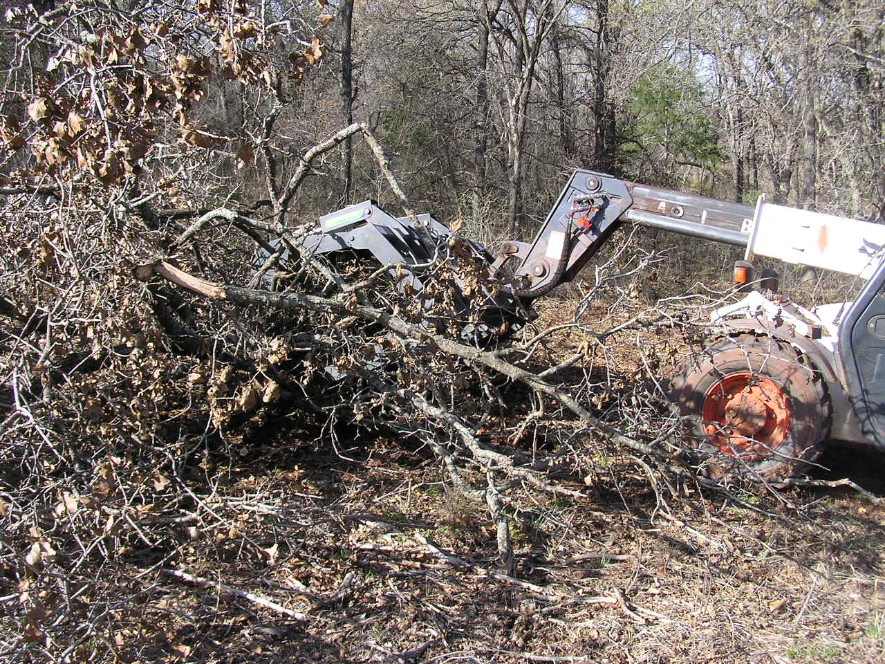

Getting ahold of it.
Picked it up, headed for the brush pile.
At the pile, 15' up.
Dropped it. Big pile

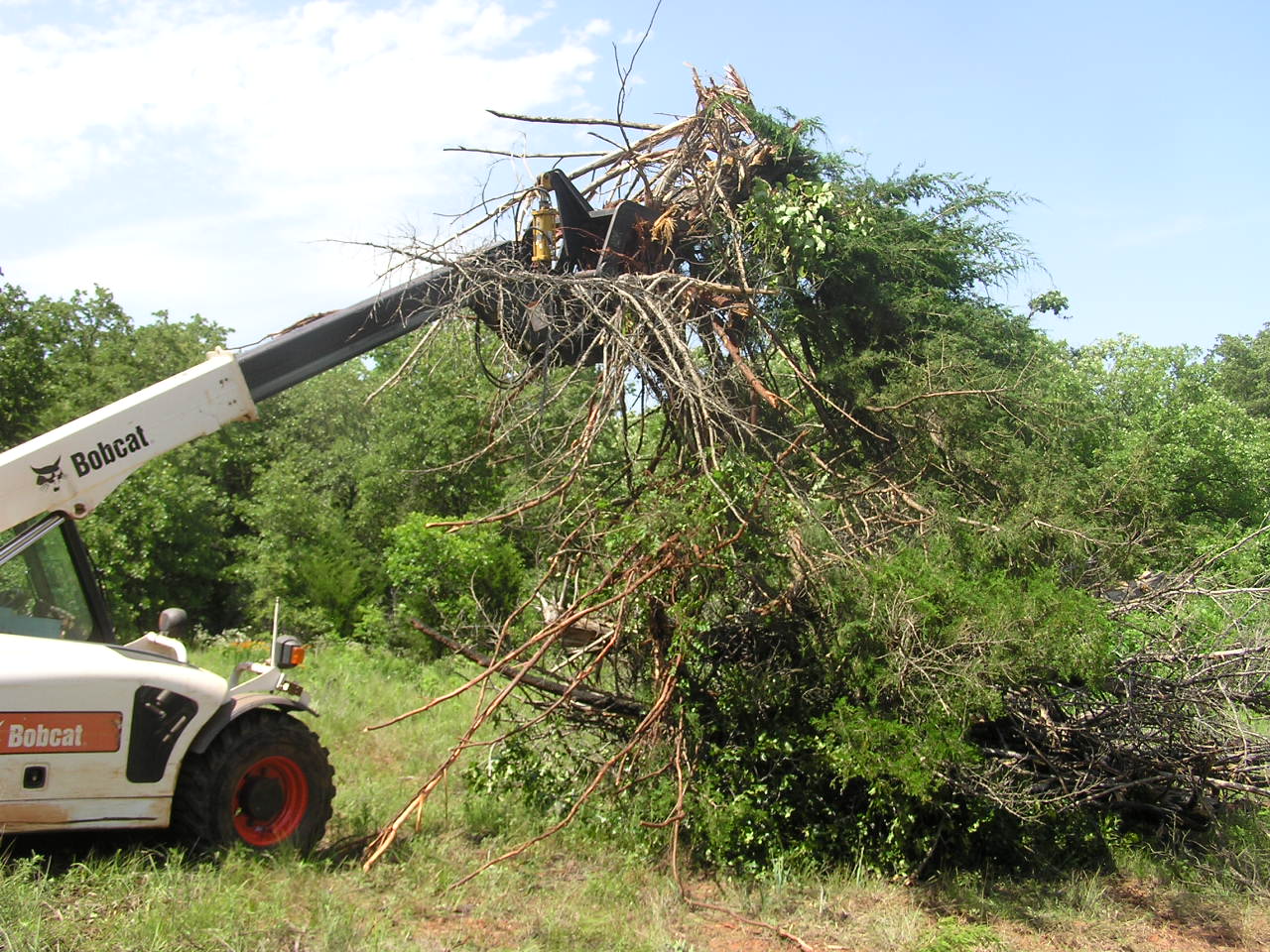

View from the seat of a 4' high cedar stump.

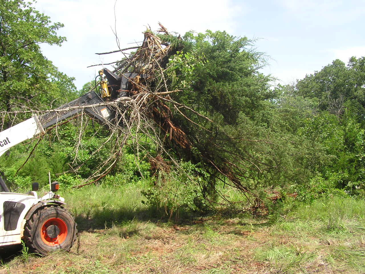

Pushed it over with the grapple.
Picked it up, it has live growth on the back side. I thought that was a little cedar growing back there.
Put it on the pile.

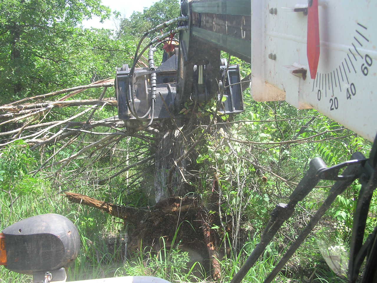

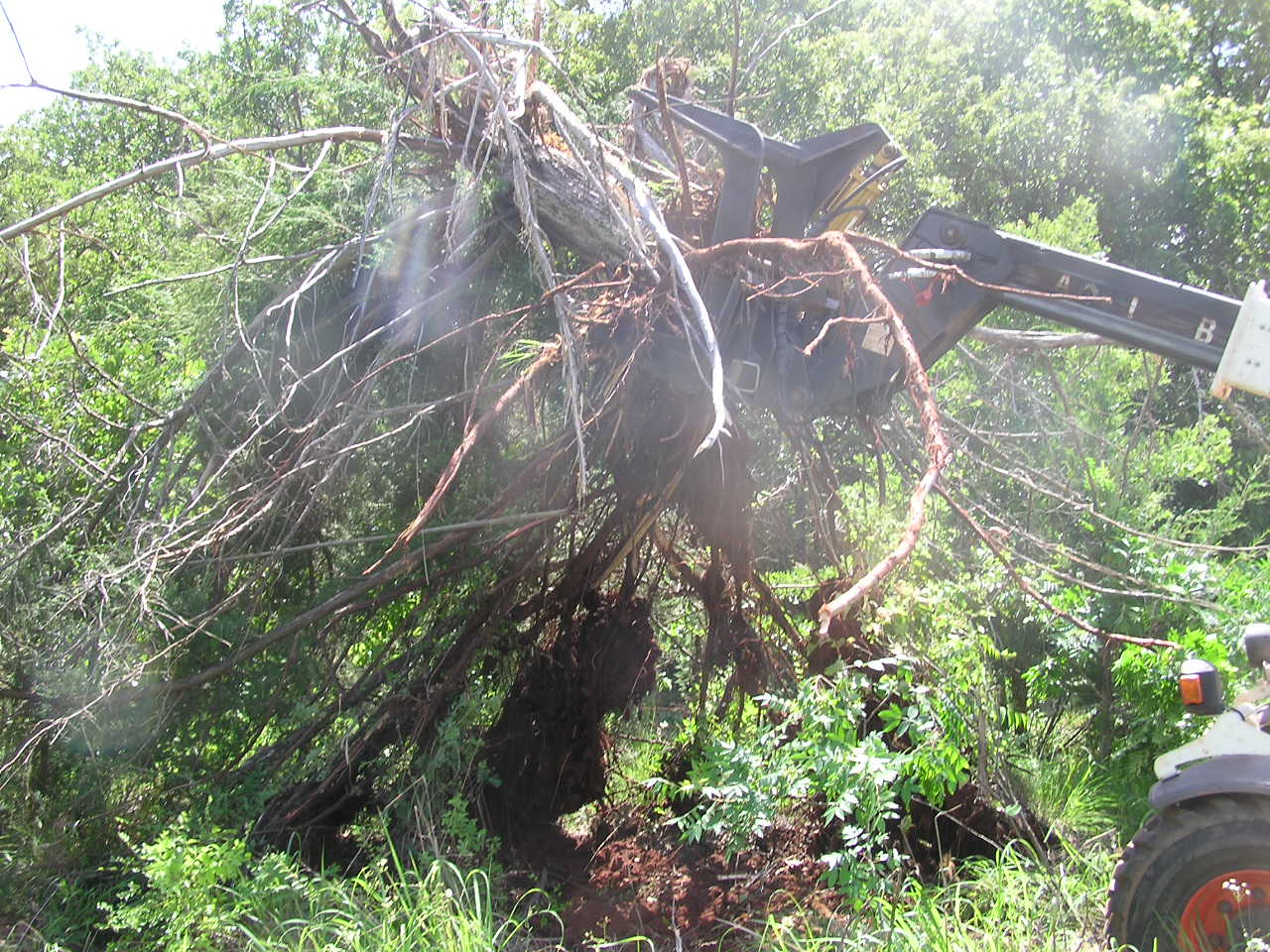

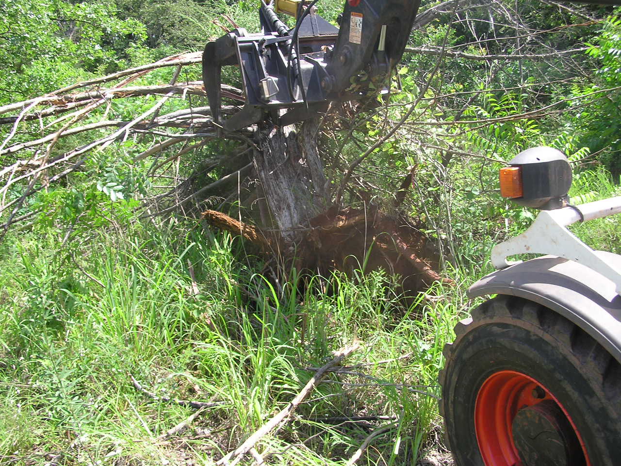

My newest tool, the long arm tree puller.
View from the seat.
So much quicker and easier than pulling them with a chain! :D :thumbsup:
