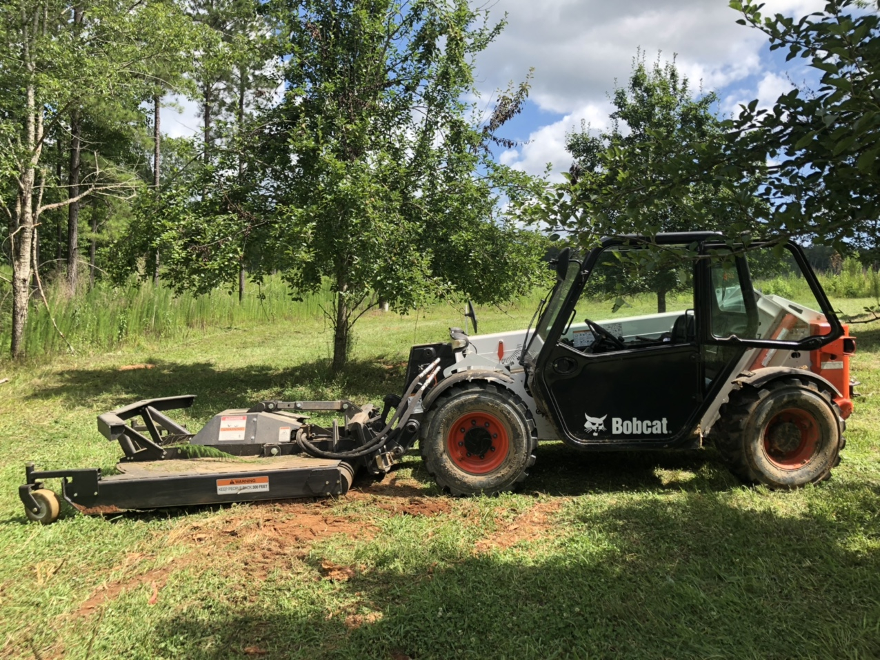

Mine is running warm, up to the yellow. Its a 2016 with 319 hours and a recent 250 hr service. Notice it when running the mower, after about 2 hours of mowing it starts creeping up. I have enough radiator fluid and engine compartment is clean of debris. Any ideas? Its too new to be doing this imo.
Blow the dust out of the radiator core: car radiator cleaning air tool - Image Search

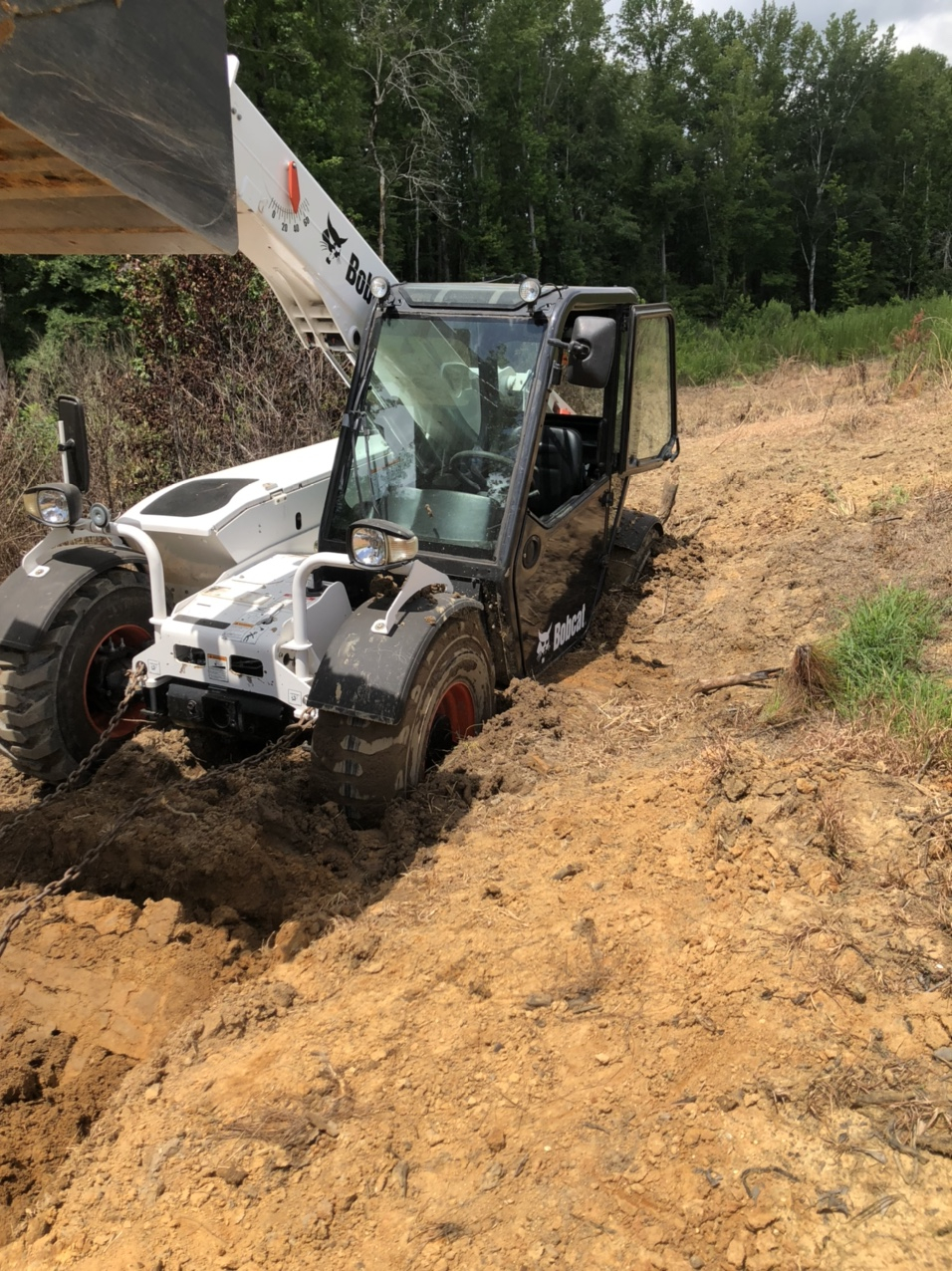

Hooked the chain to the tree I pushed over two months ago:
Dragged it out of the woods:

Errgh…its still running hot. I get about 30 mins of mowing before its at yellow. Hydrolics start slowing down. Turning off AUX keeps it from getting hotter. Plus/minus on running the AC as far as temp influence. I hate to have someone check it out.
Last time they found a “leak” in the gas tank and had to replace it-took them a year to get it back to me bec of Covid supply issues, meanwhile it sat outside uncovered for a year(i keep all my equipment covered). Anyways, if i can figure it out itll save me from them getting it.
Any other ideas on why it would be running hot?
Thanks!
   / Compact telehandler #394
I blew out the radiator, oil condensor, and the silver condensor i assume is for the AC.
It did help some-more non running hot time. Though the heat index is 100F, i just thought it wouldnt be give me this kind of trouble
Do you think i need to do a radiator flush?
If so, i think the radiator plug is underneath, right?
