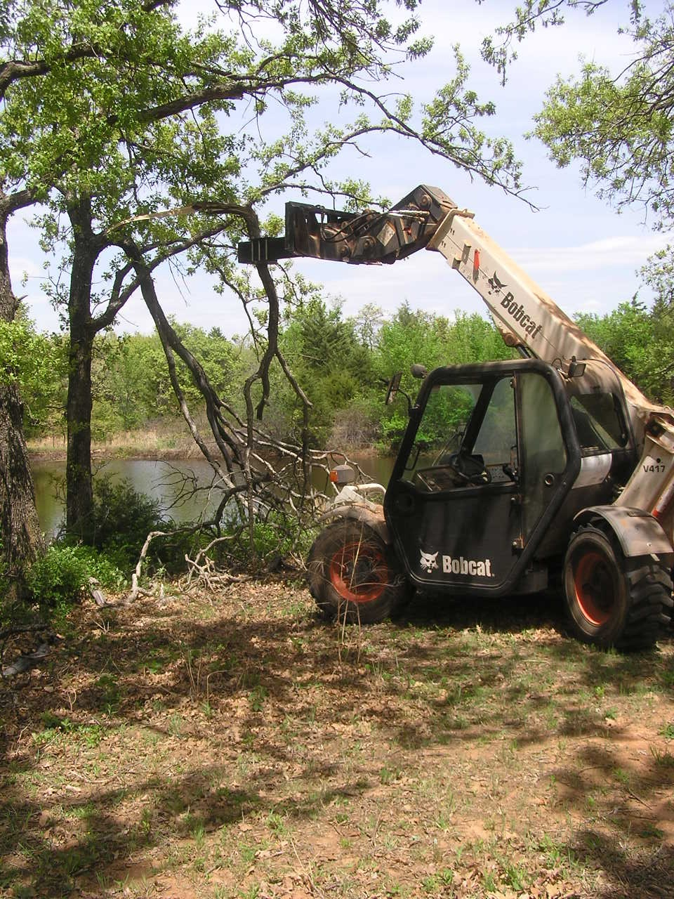

Hooked the chain to the tree I pushed over two months ago:
Dragged it out of the woods:
Pulled it to the brush pile:
Picked it up with the grapple:
View from the seat, pulled forward and extended the boom to put it out over the pile:
Opened the dual lids and gravity grabbed it:
