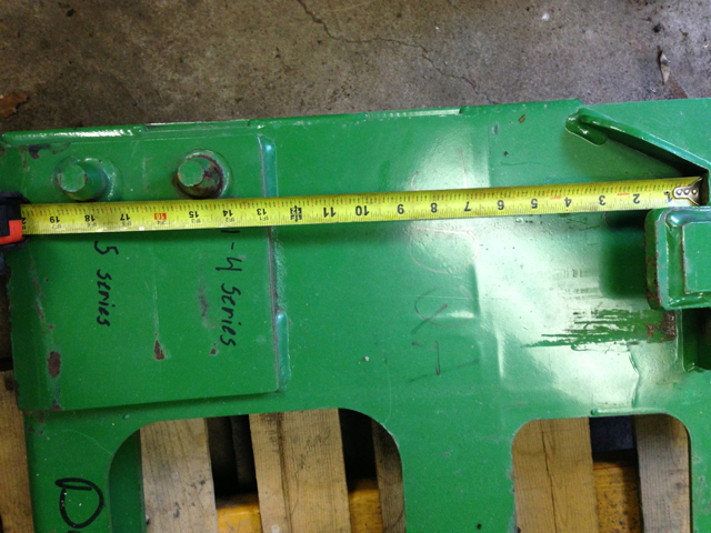

Anybody have any ideas of how to attach a compact tractor attachment to a utility tractor loader?
The pins on the attachment are 3" higher than the holes on the loader.

Does it use this style quick attach?
/ Compact to utility attachment #3
If it is not a matching ‘quick attach’ format on both sides (loader, attachment) then it is a ‘pin on’ attachment and none of those pin spacings are really standardized so it would be nearly a miracle if anything even came close to lining up. Pin diameters, width between loader arms, width of said arms (and bucket cyl rod ends), etc. The radius from the loader arm pivot to the bucket cyl rod attachment point can vary but if the loader relies on something about the stock bucket bracketry to prevent it from bending the rods of the bucket cyls during the extension, or simply over-centering the bucket and getting everything stuck, then you may run into bad news just cycling the levers after you get it hooked up.
Basically, pin on loader attachments usually dont swap between different loader models/brands and if you did get one hooked up you need to rotate it through its travel very slowly, preferably with a spotter standing to the side, to avoid any possible damage to your bucket cyls on the very first try, from an interference issue you weren’t aware of.

After thinking about the question some more and wondering why Xfaxman asked what he did, i belatedly realized he is spot-on (tip o the hat..), vs me who had missed important context clues: There are different pin locations on JDQA for different size attachments!
In which case the answer is: weld on your own new ones. You can buy those specific pins online or buy some longer same-diameter pins from Tractor Supply etc and cut them to length for the purpose.
/ Compact to utility attachment #8
The OP has a 5055E which depending on year and configuration would have a loader with either the JD500, Global/Euro/DIN, or skid loader QA setups. Based on what he said with the lower pins being located higher on the attachment than the loader, his loader has the JD500 QA setup and an attachment with the JD100-400 QA mounting setup. The picture you posted, as well as the right picture Xfaxman posted show attachments with both the JD100-400 and JD500 mounting pins. The JD500 QA has the lower pins mounted 3" lower than the JD100-400 QA but is otherwise identical, the top hooks and their horizontal spacing are identical, and the lower pins are the same diameter and have the same horizontal spacing.
What the OP should do depends on whether or not he could fit another set of lower pins 3" below the existing lower pins on the attachment or not. If they would fit, he should get a set of JDQA lower pins and weld them on, he can get a pair of them for about $20. If the lower pins are already within 3" of the bottom of the attachment, he has three practical options.
1. Custom fab or have somebody custom fab a JD500 to JD100-400 QA adapter. I have not been able to find anybody making one of these adapters as an off the shelf item. This would only make sense if the OP has a bunch of JD100-400 attachments as I would guess this would be at least a grand to have somebody fab up.
2. Sell the JD100-400 QA attachment and get one with the JD500 QA. This probably makes the most sense if there is only one JD100-400 attachment.
3. Cut off the JD100-400 QA and weld on a plate with the JD500 QA like Xfaxman posted, so that the bottom of the plate is not below the bottom of the attachment and the top hooks now are located higher up than before.

Just getting back to work and see that I've missed a lot. The first picture above is
just about what my tractor looks like. The stump bucket that I want to attach fits
the top tabs fine, but the bottom pins on the bucket are exactly 3" too high (or my
holes are 3" too low), and the pins on the bucket are at the bottom edge - - nothing
below to weld on to. I will try to send a picture tomorrow.

This is what it looks like. I'm thinking about having the pin removed and
putting a longer one, then getting a plate with a hole added above the lower hole.
Not elegant, but it should work.
/ Compact to utility attachment #13
Thanks for the picture. (y)
This is what it looks like. I'm thinking about having the pin removed and putting a longer one, then getting a plate with a hole added above the lower hole.
Looks like a plate with a hole could be fitted and still use the original pin.
/ Compact to utility attachment #14
Since you are unlikely to ever need to push the bucket ‘flat bottom’ across the ground, i would just add some brackets to the bottom of the stump bucket and move those pin locations downward. BUT, si ce you may run into this problem over and over if you plan to continue buying JDQA attachments, it may be worth the trouble to modify your loader with the extra pin location. But it may result your loader brackets hanging below the bottom of some implements. Usually the heel of the attachment is not exposed to anything dangerous so that may be a non issue.

This is my SSQA stump bucket side view:
Notice that the bottom of the stump bucket is lower than the SSQA.

Here are top and side views. You can see why I would need a longer pin.
I think I'll let the welder decide which is easier: adding plate and pin to
the bucket, or plate and new hole to the loader arm.
This is one-time thing. Wouldn't have ordered this if I'd known it was for
a compact tractor. Thanks for the input, guys.

This offset hitting the ground when using it concerns me:
If you add a plate and pin to the bucket it might have to be cut off to work on a compact John Deere, but I guess that would be someone else's problem.
Please keep us updated on your solution. I am sure it will help someone in the future.
