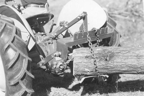

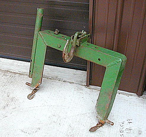

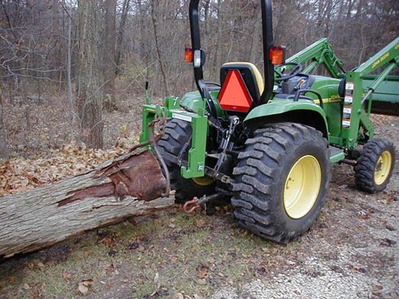

I had the log tongs already that I've used for 40+ years. With the iMatch and that top hook, I sold my previous "arch" that had a large top hook. (first pic) Then using the iMatch, and the third pic is one on the old 8N Ford. The slots would accept a log chain. Sometimes with a big log, had to have two riding the front hood of the 8N to keep it down. :) In low gear, there was plenty of time to counter it raising up too far (and wasn't fast as some want others to believe). ;)
