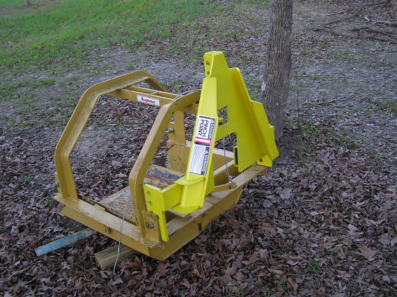

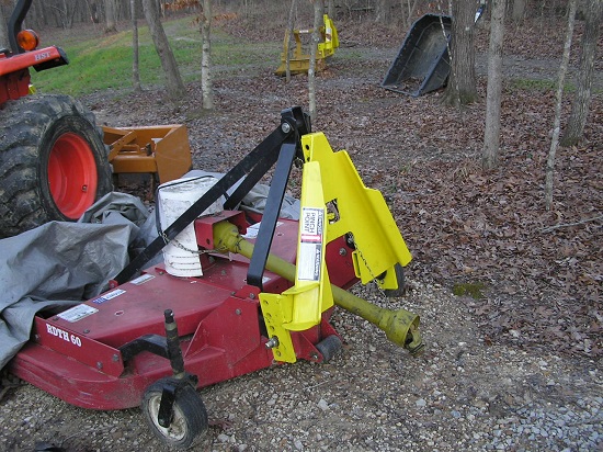

While I'm not quite as fast as that 15 second hookup time, I'd also be surprised if it takes me more than a minute to hook-up the 3pt with my tractor - and after having seen videos of fixed end lift arms, and used a quick hitch I've decided I'll never buy a modern tractor without telescoping link-ends on the 3pt (buying an older one with the old Farmall fast hitch is something I'd very much consider though). In all I may really need to time how long it takes me at some point.... though for me it's tends to be a relatively relaxing activity (plus it allows me to make a quick/casual visual inspection of the item before I start using it).

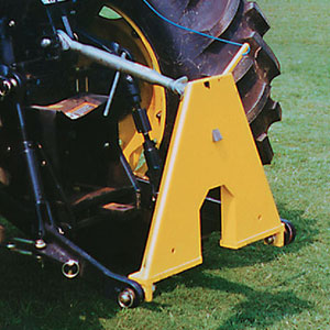

What really surprises me about 3pt hitches is the lack of a standard quick attach these days. It has to be purchased separately. If I still had a 3pt, I'd definately convert all of my stuff to use a quick attach.
So let me ask you this... While you are good at changing 3pt implements, and it takes not too much time, do you look forward to changing implements? Do you plan your projects so that you don't have to change implments? Or do you in the back of your mind think, crud, I've got to change an implement again? :laughing:
I know a lot, and I mean a LOT of people have multiple tractors just so that they don't have to switch implements.
I know when I had my IH2500b, I did not enjoy dropping my brush hog and switching to my box blade and vice versa. If the thing wasn't set down on even ground, it was going to be a pain. And that's back when I was big and strong and could just pick up the end of the box blade, or grab the side of the brush hog, lift them up and move it over to where I needed it. It was still a pain in just the aggravation VS the Power Trac's quick attach.
There used to be a product called the Delta Hitch. That looked promising. But I can't find them anymore. Don't know if they're still in business.
   / Compact Tractors are Designed All Wrong #253
It is "Delta Hook": Alexander Equipment - Home
And an old thread: https://www.tractorbynet.com/forums/attachments/118718-introducing-delta-hook-rapid-hitch.html
