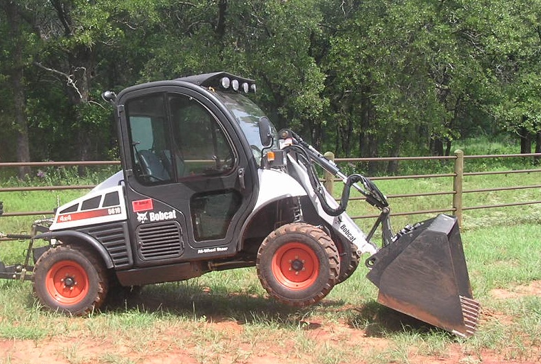

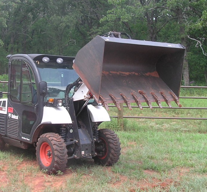

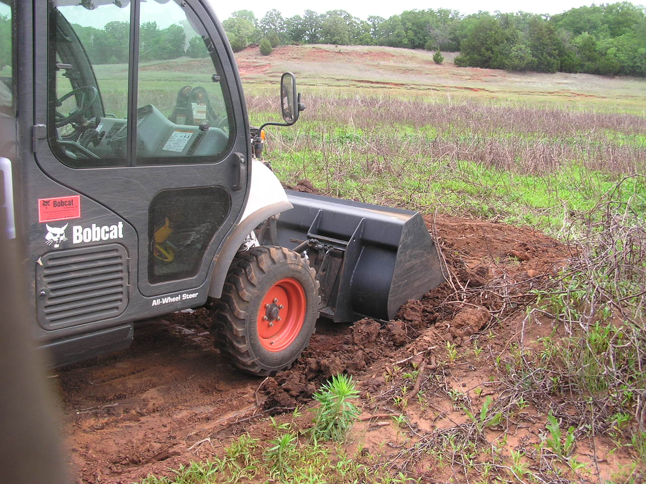

Yep, the Toolcat is 5' wide and the 1 cubic yard bucket is 6' wide, and has bolt on teeth:

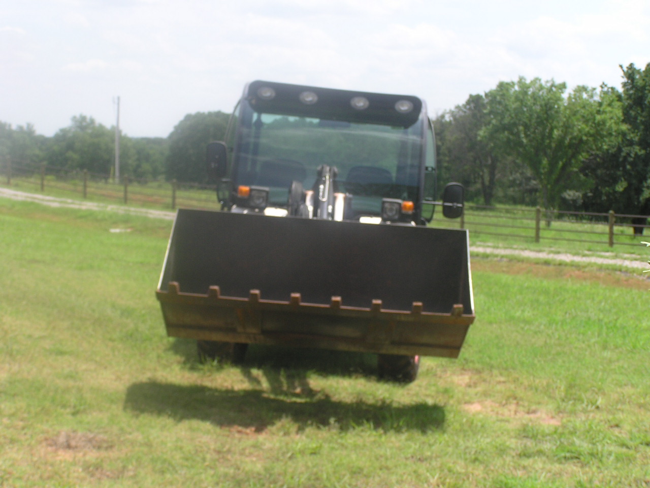

And how much weight can you bring to bear on those teeth if the front wheels are off the ground? Tons! :thumbsup:
   / Compact Tractors are Designed All Wrong #366
Right. 👍
Not very much. Most loaders aren’t very heavy on the front end. I doubt my Kubota CTL has 500 pounds on the front end plus the bucket. My buddies gehl SS was even lighter. Without a bucket on you have to make easy moves or it wheelies.
