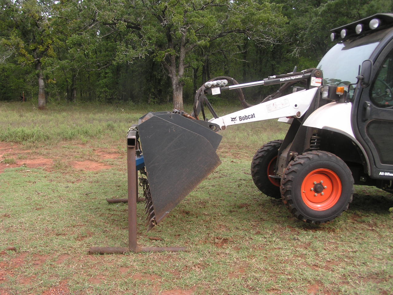

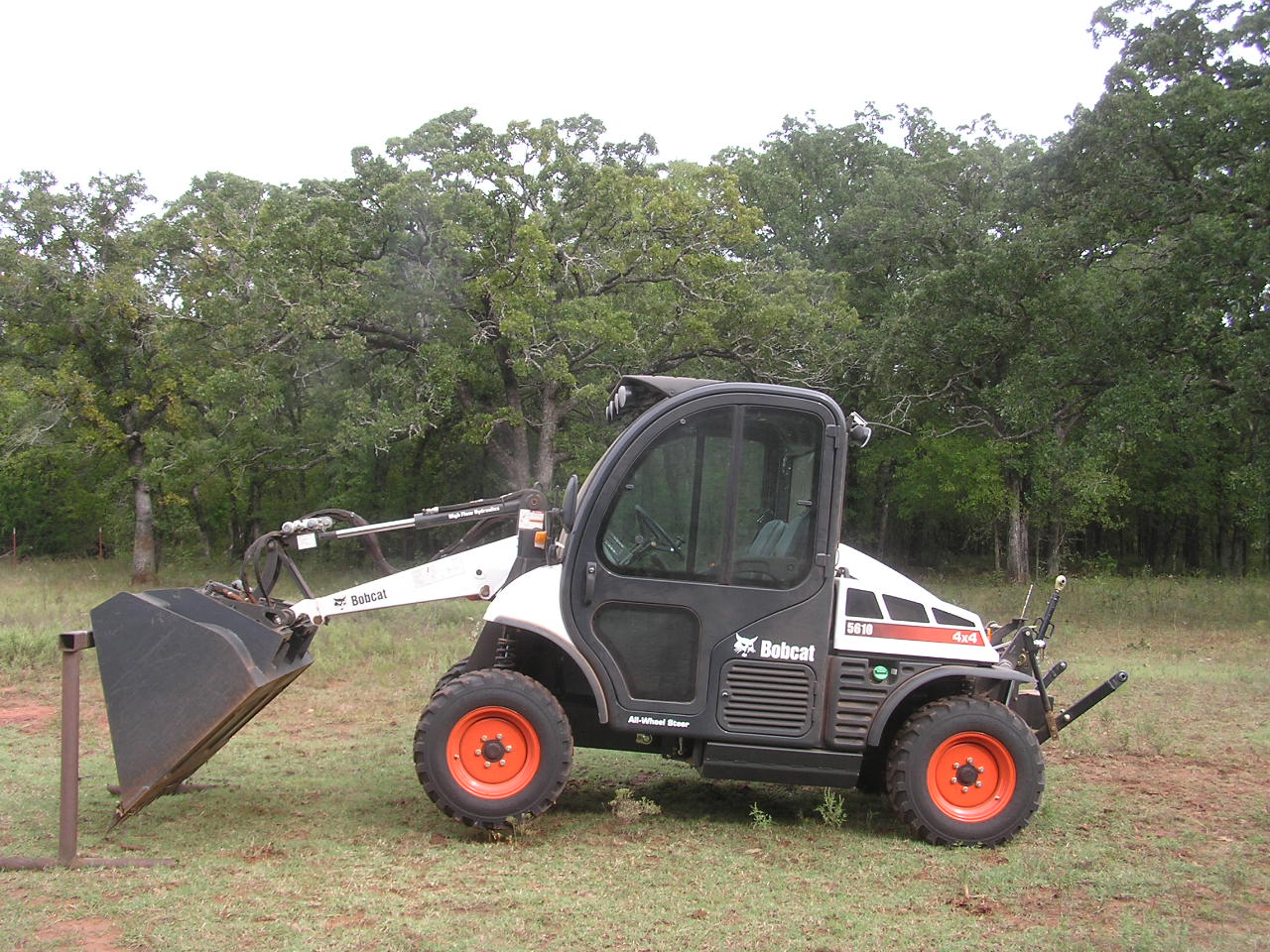

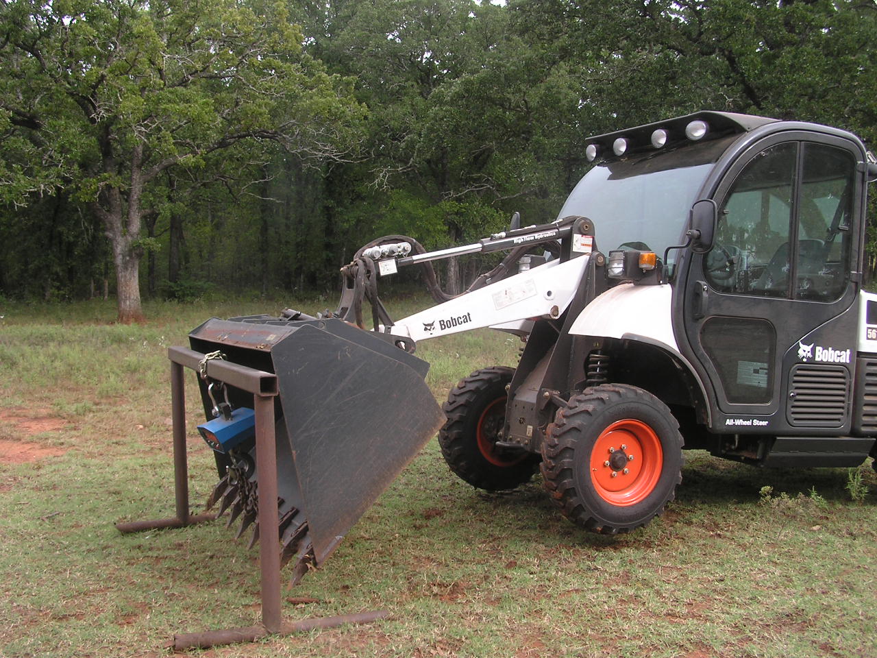

And how much weight can you bring to bear on those teeth if the front wheels are off the ground? Tons! 👍
Decided to update this, since the thread became active again.
Used the crane scale to measure the weight on the bucket teeth:
2,383 pounds, not as much as I expected:

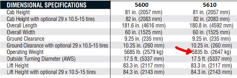

The bucket weighs 818 pounds and the Toolcat weighs 5835 pounds:
