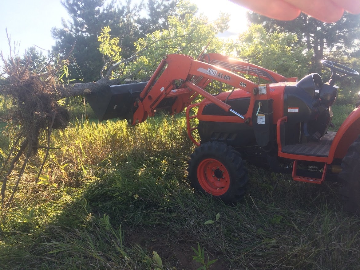

I find for brush I just push stuff around with my bucket or even the back of the box blade, but I'm nearly never operating on grass around the house, so sliding stuff over the ground and scuffing it up isn't a big deal. I do have manure forks which do lift a bigger pile of brush, but most of the time now I cut the roots of the whole tree on one side with the bucket, push it over and scoop the stump up and push the whole thing into the woods or out of the way.
I guess if your place is more like a golf course, a gapple would be very nice. Mine is pretty natural, so just crunching a small tree down out of sight, or pushing a pile of brush 100' on the ground with the bucket seems pretty easy.
You'll find the loader bucket pretty useful and with the 4 bar linkage on the curl there is a big range of motion. This was a pesky tree in the middle of a hay field and I was pretty pleased with removing a tree like this without getting off the tractor. I cut some roots with the bucket, pushed and scooped the bottom out and I stuffed it behind another tree in the fence row. I then scooped a patch of sod from over there and dropped it in the small hole.
