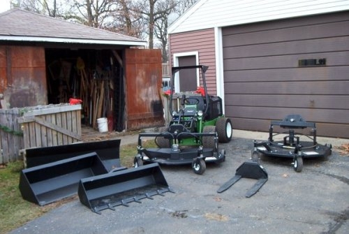

So I went the "one machine to do it all" route about 2001 when I bought our PowerTrac PT425. In a nutshell, it's a little articulated loader where all of the attachments mount to a quick attach on the end of the FEL.
Buckets
Mowers
Brush cutter
Power angle snow blade (curls,too)
Forks.
They make about 40 different attachments.
For our uses, it's perfect.
There are drawbacks with these types of tool carrier type machines when comparing them to an AG style tractor. For example, it will not pull like a tractor, say plowing a field or pulling a stump. But it WILL run circles around an AG style tractor doing FEL work, hauling material from point A to point B. It's great at mucking horse stalls as well. It can get into tighter spaces with a mower. But a farm tractor just has better gearing and traction.
It has a nice cut and all, but it's not a zero turn.
It'll stack snow over 6' high, but it's not a snow blower.
Stuff like that.
A purpose-built machine will almost always be better at a task than a do-it-all machine. But a do-it-all machine means one less machine to maintain.
If I hadn't bought this machine, my next choice back then would have been a New Holland TC21D. It had a great ergonomic feel and I'm sure it would have suited us as well.
So poke around, look at different machine types and try and get some seat time on everything you possibly can. Good luck in your search.

Moss, just curious, do you ever hit your head on the little roof mounted to the roll bar when mounting/dismounting? It seems like you would, but maybe it's higher than it looks.
   / One Tractor To Do It All? #50
Absolutely! :ROFLMAO:
