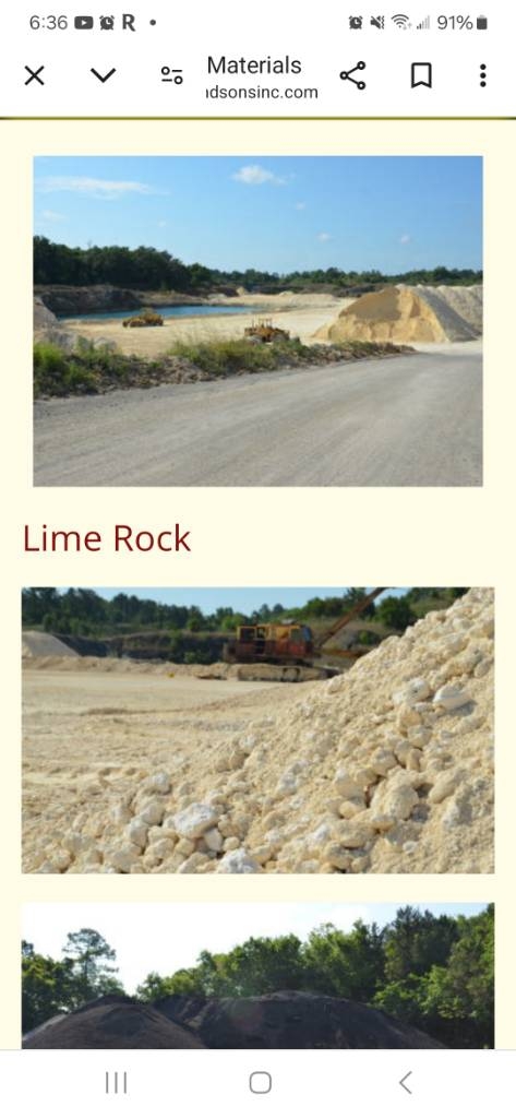

So the naming conventions get weird; we don't use gravel, crushed stone, or crusher run here; we use limerock roadbase. It is a soft rock that is mined either by blasting, drag line, or plain track hoe, and is very soft for the most part, and runs from powder upto fist sized. There are also granular base materials, almost never used, and the normal #57/83/ect washed rock, clean 'gravel' that is a hard rock that is cracked, and fines washed off, for use in concrete, or as a non-compacting pipe backfill or other specific applications. Although not really available around here, you also have smooth, river rock type gravel, that frankly is suitable for landscaping. Being all marbles, and no fractured sides, not suitable for a roadbase, driveway, or use it concrete.

Picture of our standard base material, picture stolen from V.E. Whitehurst, a company of great good old boys.

Locally, "gravel" or #57 stone, is almost never a good choice for a driveway or a base material; it is Far more expensive than limerock, doesn't bond together, ect. It does however resist washing unlike limerock.
