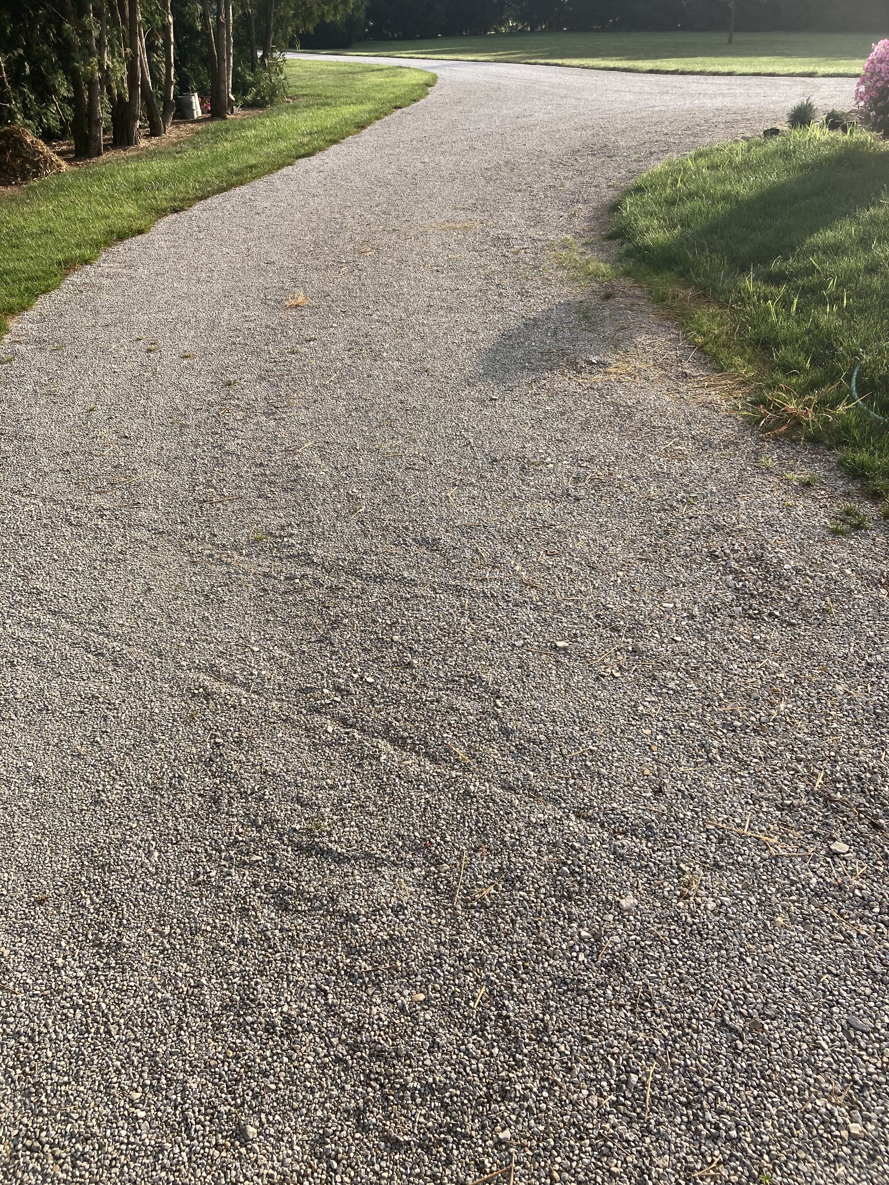

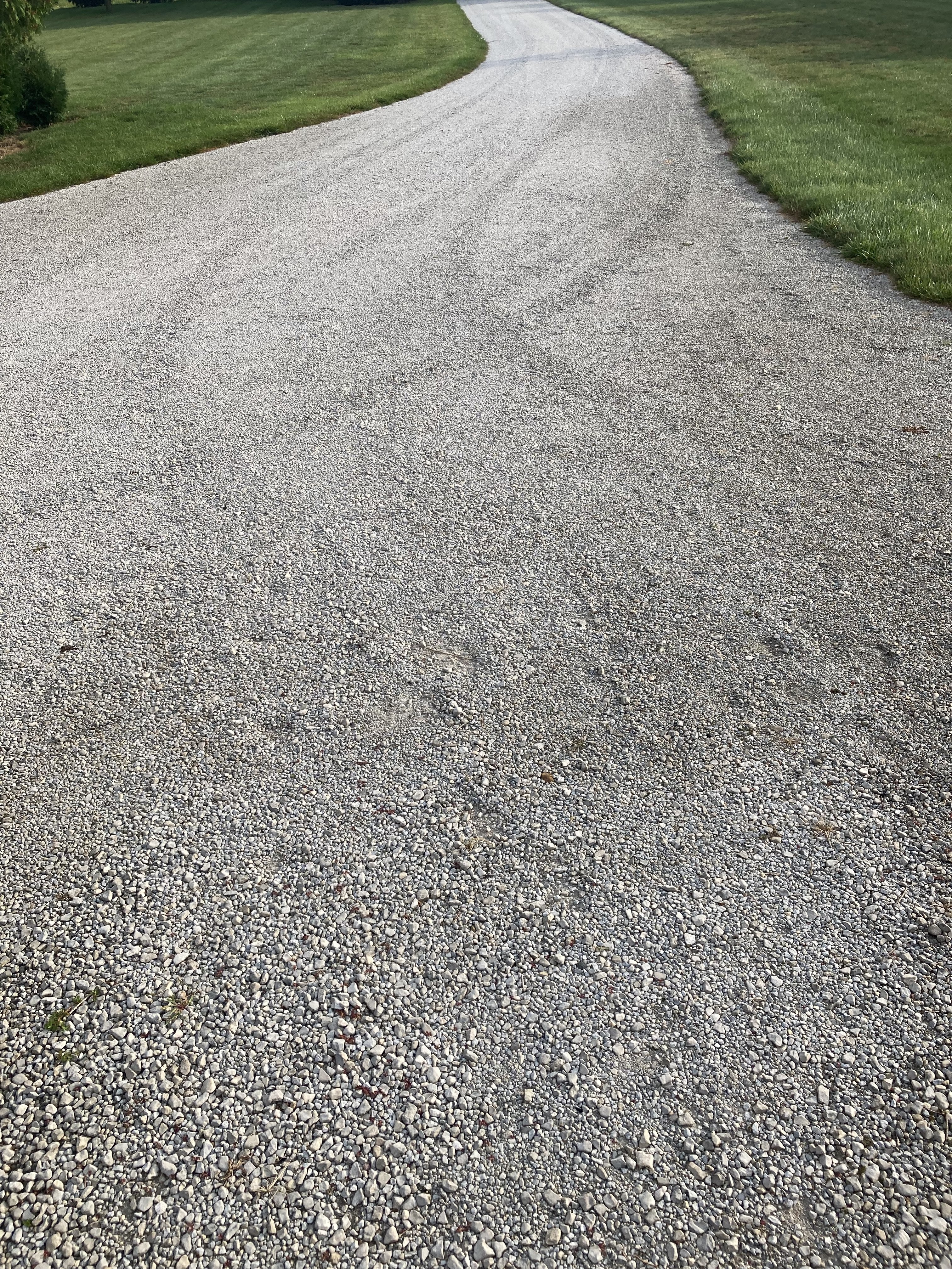

I pack my own 3/8"- 1/2" crushed driveway every few years only because I can but it's a waste of time.
The only time I gained was when I accidentally packed it wet. Five years later I can still see where it got packed and it looks like the same small gravel pushed down into the fines. New gravel still slides on top. I have a great base underneath and a guy in a slow moving dump spreads an inch or so every 5 years.
My drive looks good because I don't drive down the center every time. I drive with one wheel on one edge one time and the other side next time. I mix it up and drive slowly.
Visitors may drive down the center but I have found it takes the pressure off developing center tire tracks. My driveway is flat, slight crown, minimal gravel and no holes or anything after 25 years.
I drive 5 ton and 10 ton+ equipment--off center- on a regular basis in dry weather. I keep a minimal surface amount of gravel and no sharp turns or high speed. No thick amounts of gravel to push off or cause problems.
In pics below there are some rarely seen tracks because my elderly neighbor floors it. The lines in the other photo is where the hose was driven over for a month. All ok if infrequent and dry.

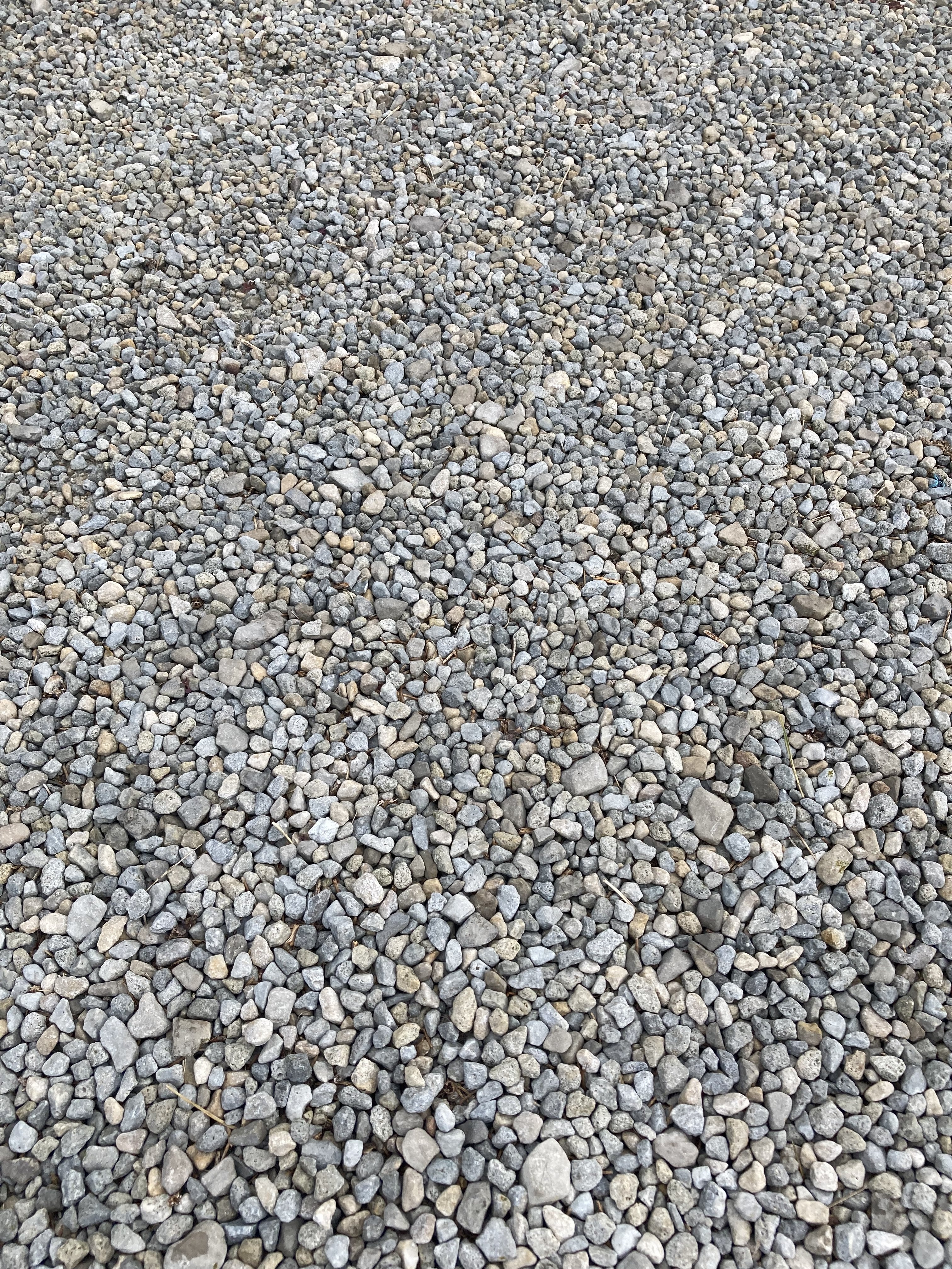

View attachment 918663View attachment 918661View attachment 918660
