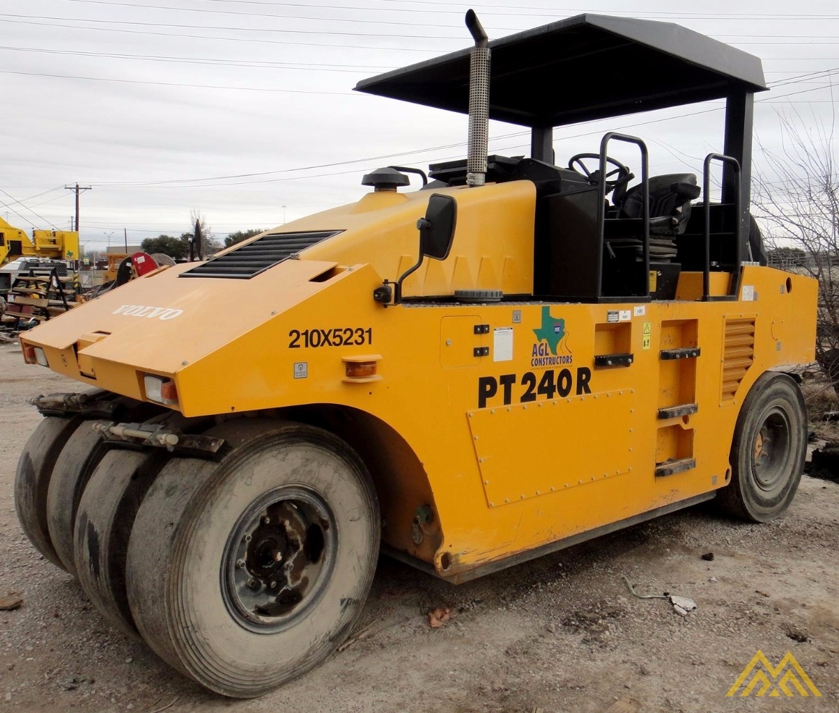

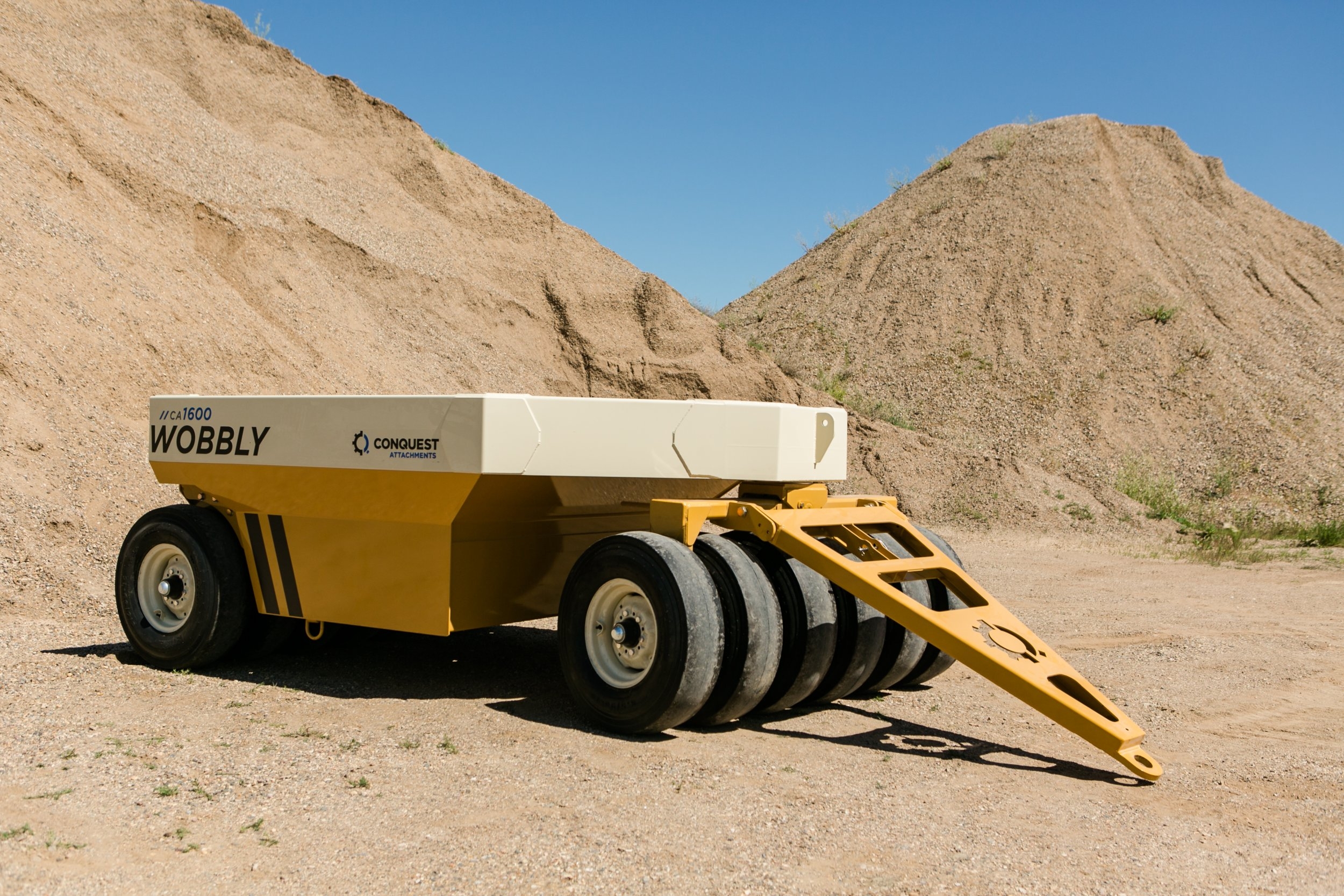

If you really want to do a good job compacting a gravel driveway, use a compactor like this or even a self propelled rubber tired compactor. They will do a better job then the steel drum compactors.

Depending on size of gravel and if it has dust or not. It wont pack even with a compactor.
Say #57 crushed limestone sure you can run over and "compact" it with a roller but once a car runs on it and turns it's tires that gravel is no longer compacted.
