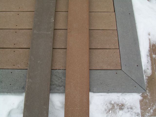

Replaced our treated wood deck with Trex 8 to 10 years ago. We love it. Sweep off mud with a broom and shovel off the snow. Other than that, have not done a thing to it. It is south facing and gets sunlight all day long. It is the "saddle" color - a light brown. It did fade some, which I expected. Used some gray Trex as an outline on a higher deck and it is still the same color as the day I installed it - but it probably needs a good washing. No splinters, no staining necessary.

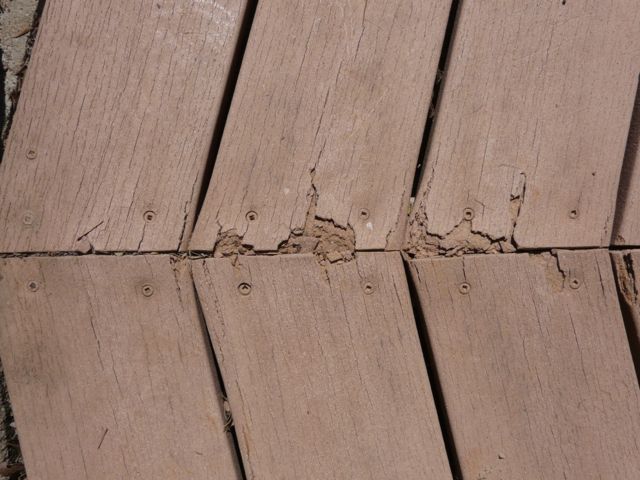

I was the unlucky one and got a defective batch of "weather best" decking. Pictured is mine after 3 years, it just started to turn to powder. I joined the class action lawsuit and my deck was replaced free - decking and labor, with Trek. Make sure you do all the warranty work right and put the receipts in a safe place. Inspectors came out and measured the spacing of the joist and the space in-between the decking - if I had not installed it exactly to the instructions they would not have had to replace it.
On the plus side I loved working with this material - better than wood - no splitting. This install was around a chlorinated pool in direct sunlight. The decking not exposed to sun had no damage. This material is great to walk on barefoot - no splinters but during the hottest days in direct sunlight it does get hot and there is a need to spray water on it or wear shoes.

Here is a photo of the saddle (brown) and grey trex somewhat new and installed about 8 years ago. The "new" are a couple pieces I had left over and are in my barn. It does fade, but there still quite a bit of color.
