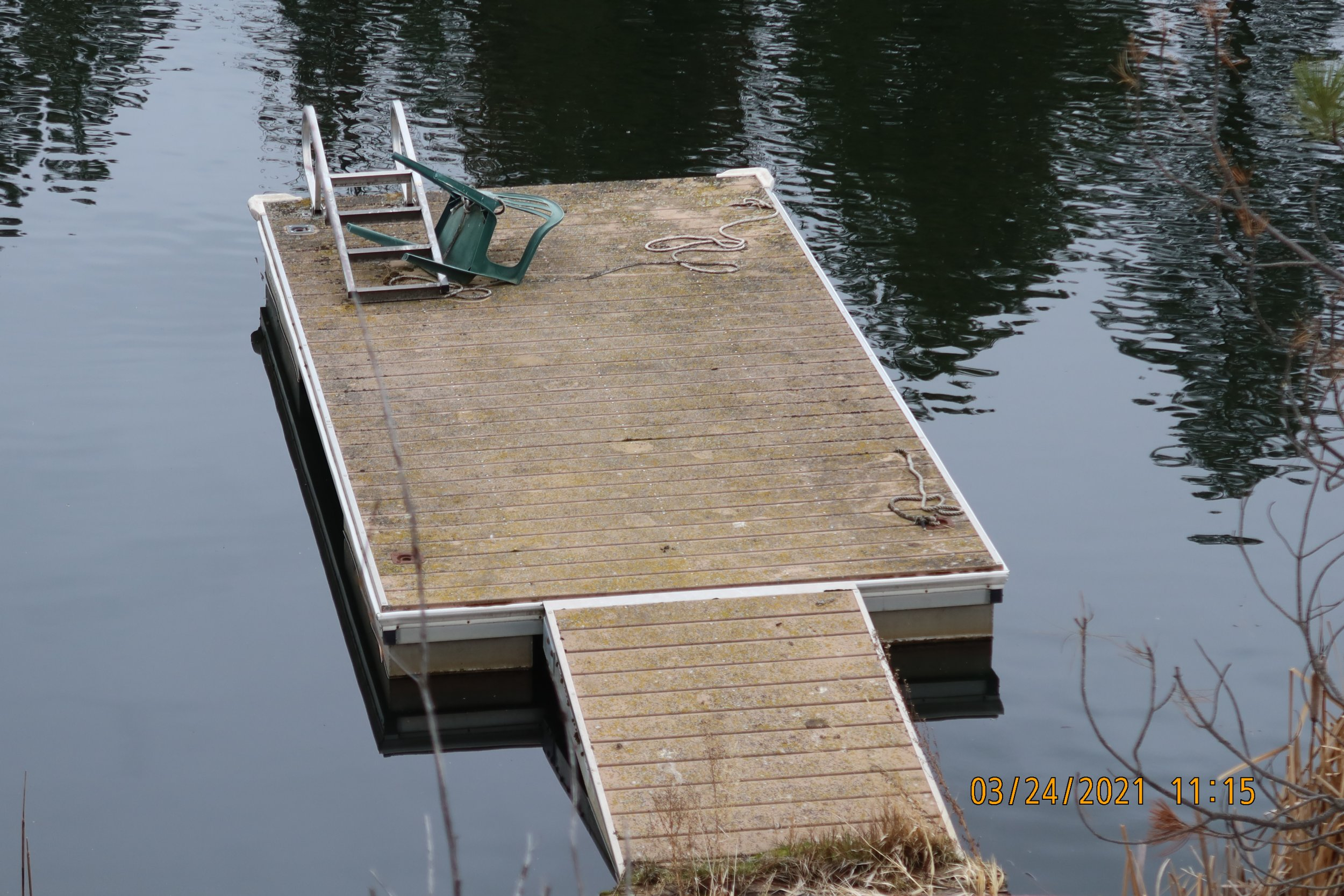

My dock with its Trek decking has been in place for 17 years now. Still as good as new - still have to wash off the goose poop every so often. It's light tan and does get hotter than blazes in the afternoon sun. What you see in this picture is wind blown dirt and silt.
It's just too darn dry hereabouts for any type of mold.
