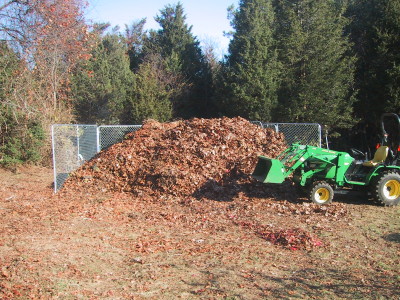

I was working on my bin today, and I'll try to add a photo of it tomorrow. My bin is a 12'x12'x6' high kennel kit from HD, except that I leave it open to 24'x12'x6'. Tall is better than wide, as the pile compresses during decomposition. And each time the pile drops a foot or two I use the fel to turn the bottom to the top.

Here's the pile this morning. The chain link fence sections keep the pile contained but can be moved easily to let me turn the pile with the fel.

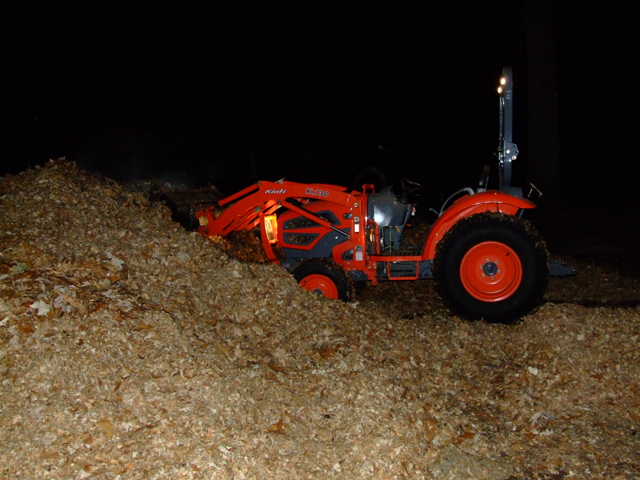

I've had an ongoing compost pile for many years. I always try to save a small pile from the previous year to use as a compost-starter for the next year. I harvest some of the first fallen leaves and get them turned into the existing compost pile to get the process jump started. I've used fertilizer and ashes from the grill or camp fire to get a "fresh" pile started.
This is how I tell if my compost pile is cooking. I go out on a cool evening after dark (5:30-6:00pm /forums/images/graemlins/frown.gif ). Today was perfect.
I drive the tractor out to the compost pile. (see attachment)
Picture 1 of 3.

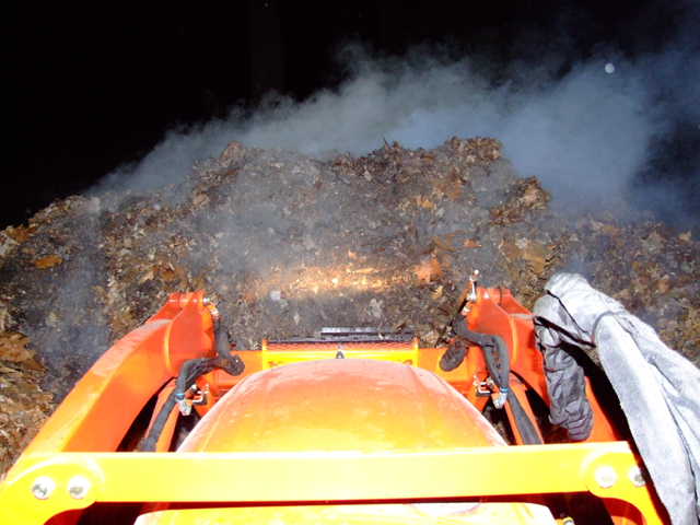

   / compost pile #10
Then I drive the bucket into the base of the pile, making sure I get good bite, lift and dump.....and if I see....(click on the attachment)
I know it's doing what compost piles are supposed to do.
