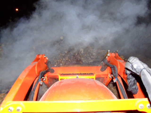

If you're getting an over abundance of steam,
you may want to check your radiator hose. /forums/images/graemlins/tongue.gif
More often than not it'll be the compost pile
lettin' you know it's doing its thing. /forums/images/graemlins/smirk.gif
Picture 3 of 3

Don't think I would recommend smoking during this exercise, some methane gas may be present.

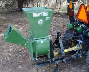

I just make a pile. Needs to be at least 4' tall for it not to lose too much heat to allow it to "cook". Attached is a look at my pile behind my new MacKissic shredder/chipper.
I get a lot of sawdust from my cabinet man. For each 2 barrels of sawdust, a bag of 10-10-10 is needed to bring the C:N ratio down to around 30. I just sprinkle it around over the sawdust once I've dumped it, spread a soaker hose over it and let it run for about 30 minutes. You could use some organic sources of N, but obtaining their N content is not always easy, particularly for correcting from about 300-500 down to 30 like for sawdust.
I use the MacKissic to shred up prunings and to grind up leaves that the town folks just give away. They're so kind to bag them up and leave them at the curb. Have gotten about 6-10 pickup loads (15 bags/load) so far.
A fellow master gardener also does theirs as a pile. Think he has a JD 4300 to toss his. I've a little JD 4010.
I don't really care if mine composts. Even if it doesn't, I spread the mulch around my veggies for weed and moisture control. It turns to dirt for the next season. Been doing this for nearly 30 years. Main benefit of composting is it'll kill weed seeds.
You just need to get your C:N ratio to around 25-30, a little bit of brown, a little bit of green, some moisture and some enzymes (available in a little bit of dirt). There are some good articles to be found by searching on the internet.

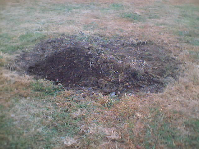

I don't use bins either. I just make a pile and add to it over the course of the season. For me it makes turning w/the FEL easier. I turn the older over the newer to get the fresh cuts into the middle. The pictured compost is all thats left over from last years grass & leaf clippings and it was gone shortly later. It was my 1st batch /forums/images/graemlins/grin.gif
All the Mrs's plants got side dressed with it this year.
It was dark brown, moist and with a somewhat pleasent aroma, just like I'd heard it would be. This years pile is about double last years.
