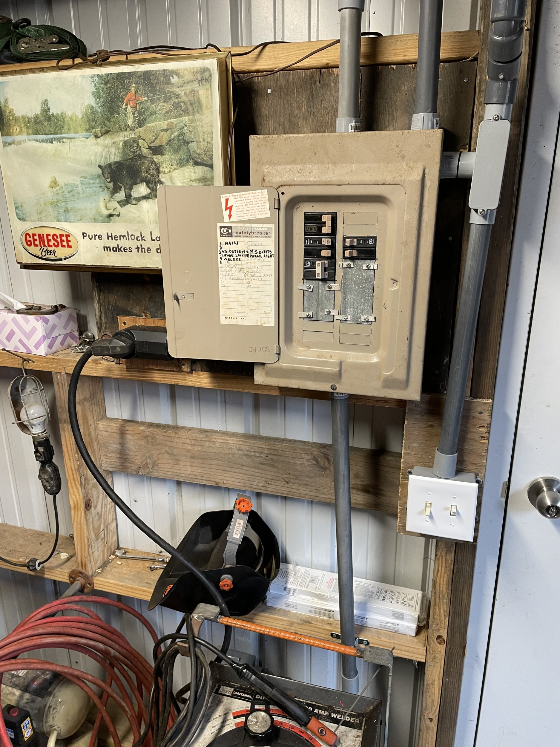

I simply added a power switch with pilot light by the man door, that turns system on when needed. Then added a manual shut off valve at tank next to the air dryer. I personally have no need to keep system pressurized so i dont. If i know i will be needing air, i simply flip on switch as i enter building.
I tied it to the lights simply because I had teenage boys. :) If I look out of the house and see the lights on.... I also put a limit switch on the large bay door as well as a timer on the propane furnace. Door open, no heat. You only get one hour of heat max and the system shuts off or turn the dial again (I have a personal key override). The only addition I would have made in retrospect is a coin operated timer for the furnace.... :)
