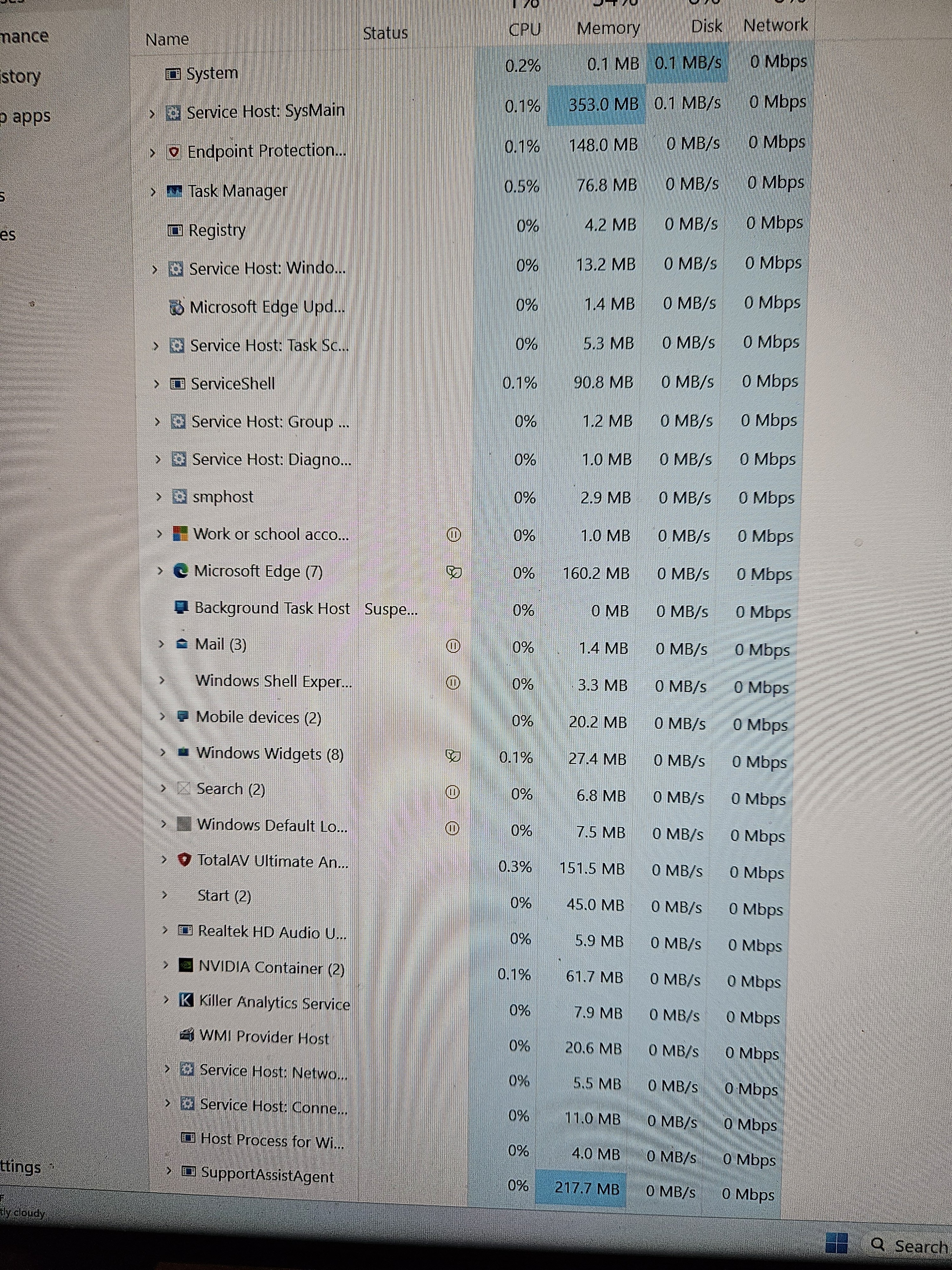

Need help from you computer gurus. I've had a desktop computer since 1997 and should know more than I do. I have nothing stored on my C-drive, but as soon as I open a browser or my email it will go up to 100% usage. With just my task manager open, my memory will show 11 gb of usage.
I had windows defender and ran it on my whole computer, then only C-drive and it would stop at about 95% and quit.
I disabled windows defender and downloaded TotalAV, I ran it on the whole computer and then C-drive, it worked, but found nothing.
This use to happen once in a while for a short period, but not like this.
I don't know, but I'm thinking that my C-drive is just failing on me.
Thanks for any help.

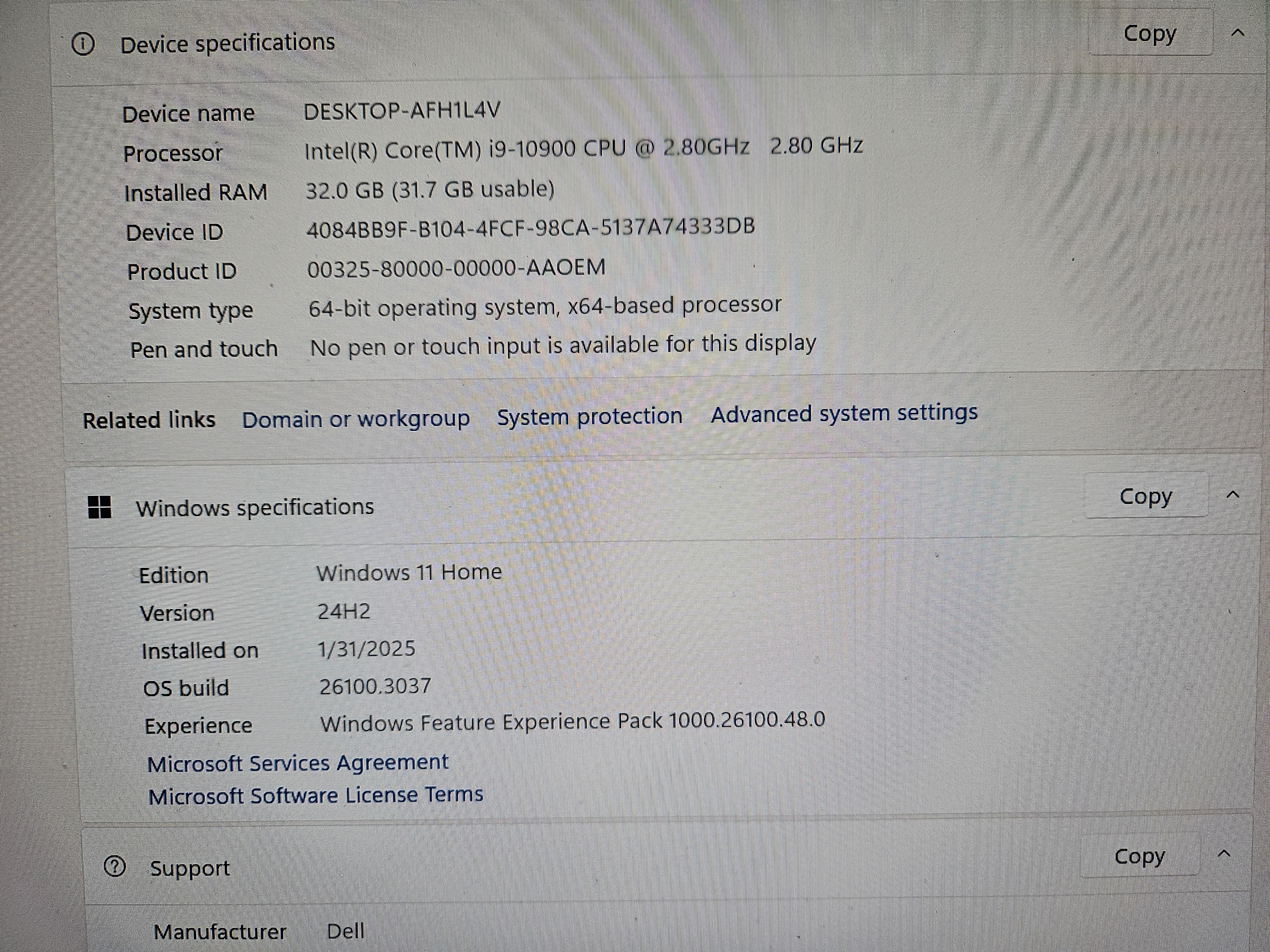

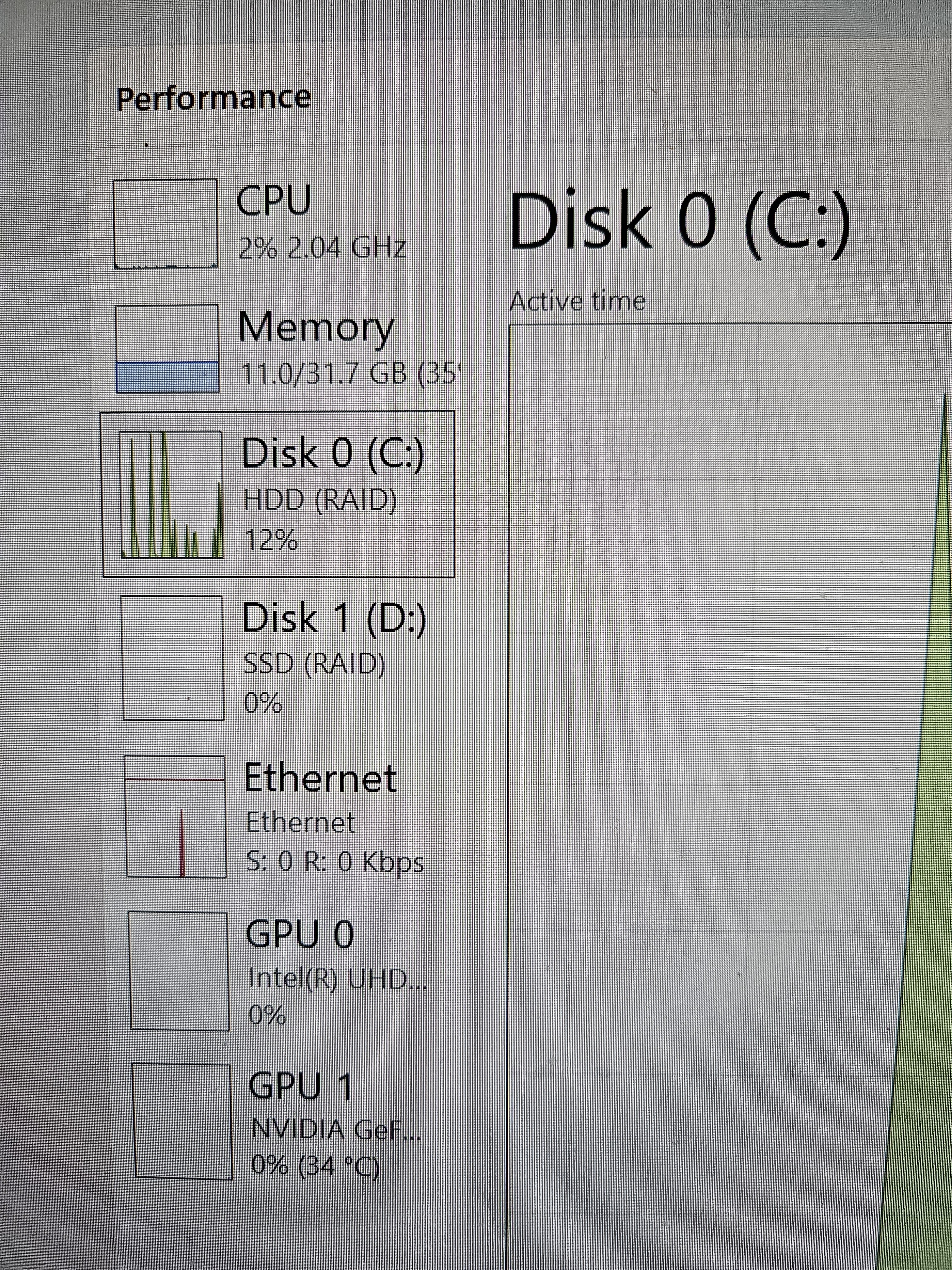

you need to check SMART, the raid indication is a slight concern, what kind of computer is this, are you actually running raid? why is disk 1 an ssd, but not 0 where the os lives?
if its a ssd, need to check wear as well
run this
/ Computer problem. #4
If you've had that computer since 1997 I have serious doubts it is able to run Windows 11 and it should not have been able to complete the "upgrade". For that matter I'm not sure Dell was even making computers in 1997 and unless you've added the SSD more recently it's really confusing as there was no SSD in 1997.

This system has a hard disk and an SSD, HD for OS and SSD for data.
Maybe HD is running out of space?
Take a look at disk space to see if at least 10% free on C: and D: (or in this case the RAID combined drive, not sure how file explorer will show this.

According to the first screen you installed this OS version on 1/25, so could just be doing a massive update, those can be pretty intrusive and take a while.

Yes you're right, it would be tough putting 32 gb of ram, 64 bit operating system and windows 11 on a 1997 Dell desktop.
My first desktop was a 1997 Dell 286 processer (ram, don't remember) and 40 mb hard drive. This is probably my 6th or 7th
desktop computer. This desktop computer is a 3 year old Dell.

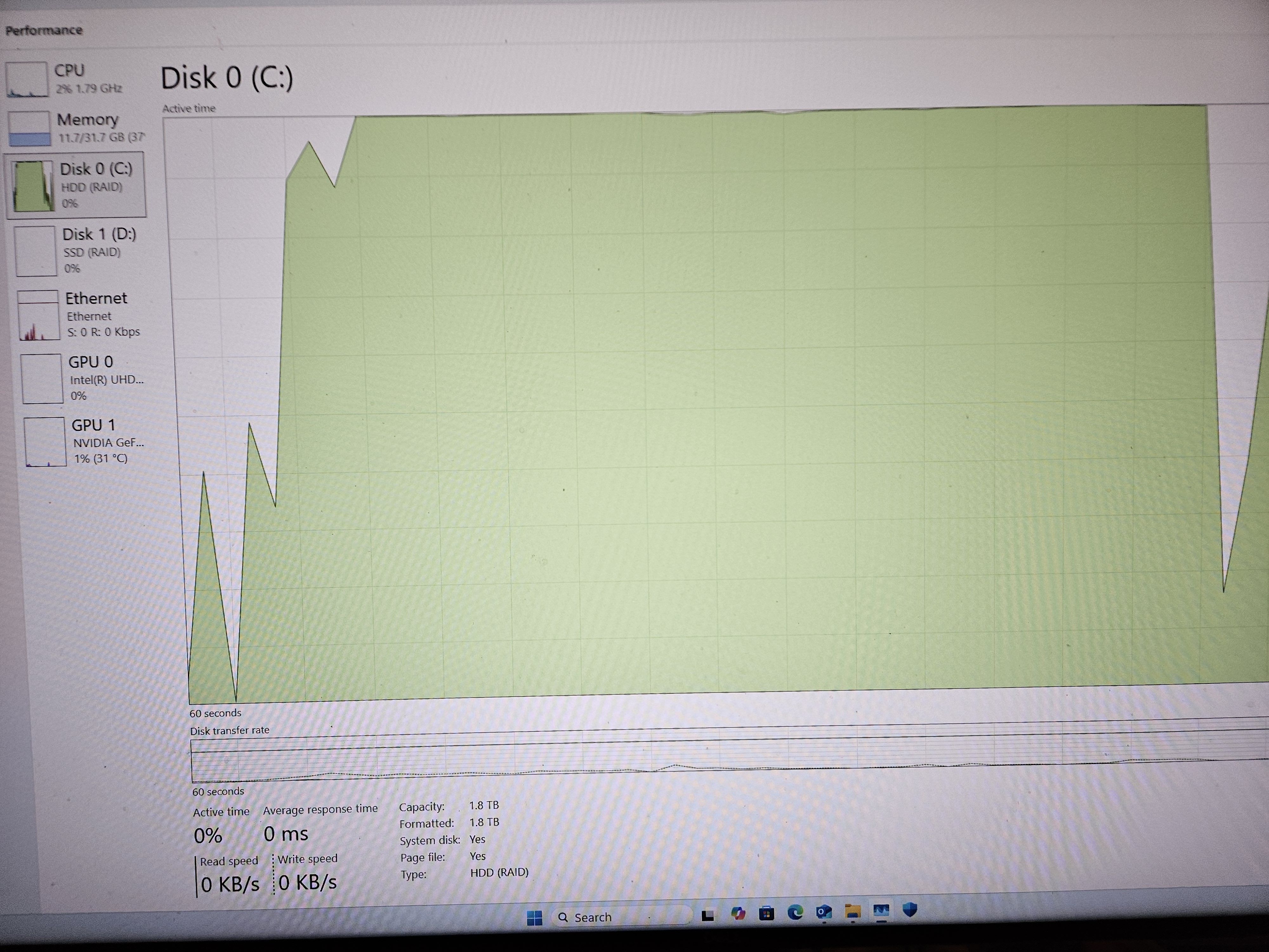

I am not downloading any apps, not running any apps. C-drive is just nuts. Of course it's slow as hell, like not having
enough ram.
I ran check disk from C-drive properties-check disk, no problems. I ran every option on my TotalAV and nothing.
Now with this problem, in the one picture I only have the task manager open, but it is using 11 gb of ram. Normally when I
turn on my computer and have one window open and the task manager it will show about 5.7 gb of ram used.
In the other picture where C-drive is 100% utilized I only had the task manager and one browser open.
I think my next step is to replace my hard drive with a new Dell drive.

Ok problem solved. Went to buy a new hard drive from Dell, he said why not talk to Dell techs first. No cost to talk to them, but for a diagnosis it's $99.00.
It took two techs and some time, but they figured it out. I had a new hard drive installed a couple of years ago by a contracted company working for Dell.
He installed my hard drive backwards, It looks like windows was installed on C-drive (512 gb) and storage was D-drive (2 tb), but they were installed in the wrong positions.
D-drive was in the first position and C-drive was in the second position. Look at the thumb on post #15.
You Gurus will know why that's a problem.
Edit: I just looked at my D-drive (2 tb) 2nd position and it's empty. The contractor tech must have installed windows on D-drive (2 tb) too, which is why the computer would still operate, but very slow at times.
All I know is that my computer is completely normal and nothing is slowing it down anymore.
So which drive had the OS on it, C or D? Both are labeled as the OS drive in the screenshot you posted.
I've never had an issue with which drive was in what physical position, can't say I've ever installed the OS on D so I don't know how that would work.
