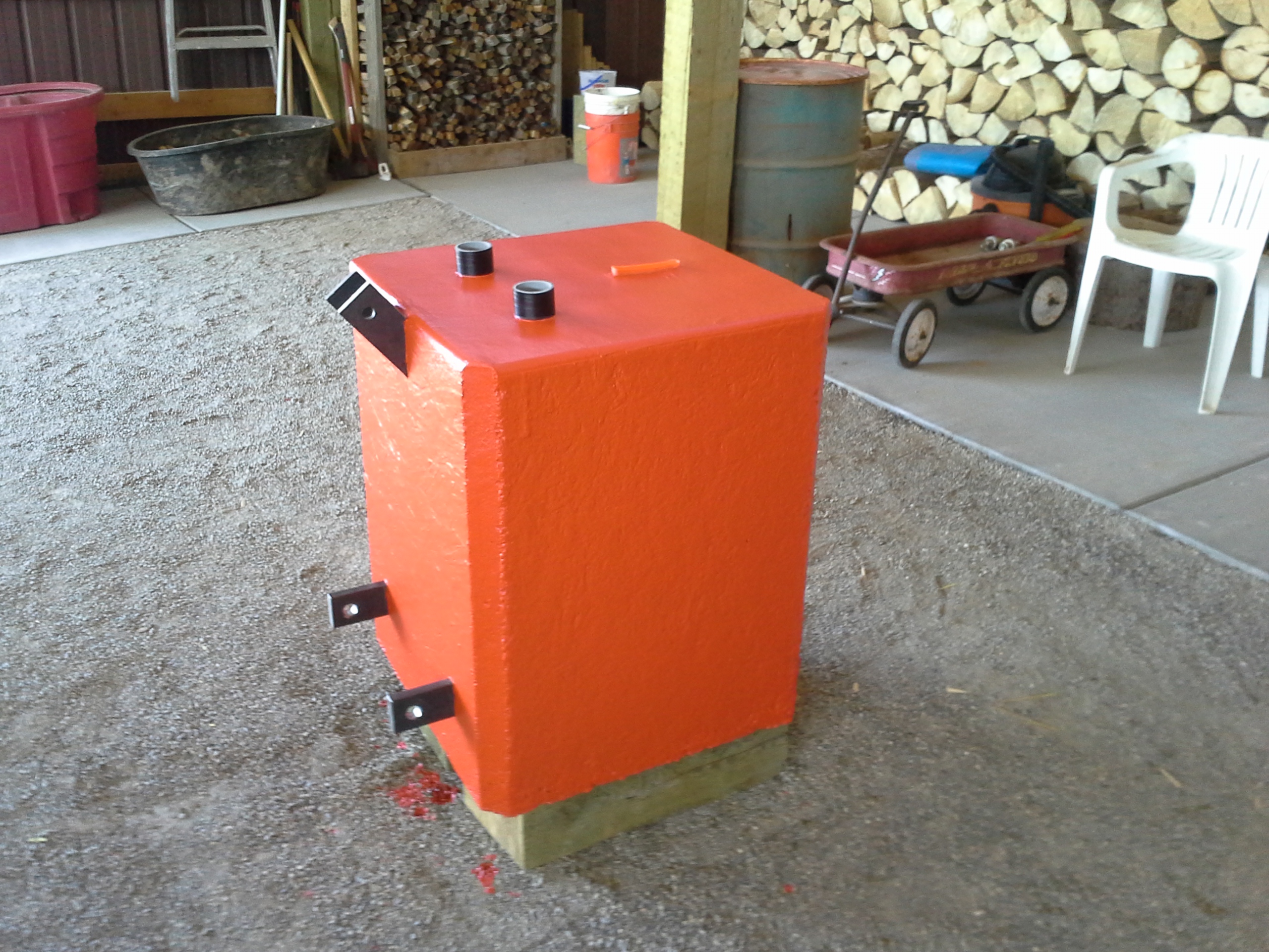

Here is one I built this year. Tips the scale between 1500 & 1600 pounds. Sounds like it's what you are looking for. Nothing is welded inside. It's all drilled and bolted together with all thread.
Just realized I have responded to you about ballast boxes in your tractor thread.:laughing:
   / Concrete barrel ballast box idea
#17
View attachment 522554View attachment 522551View attachment 522552View attachment 522553
Yes sir, that's awesome. I'm going to private message you with some questions later today.

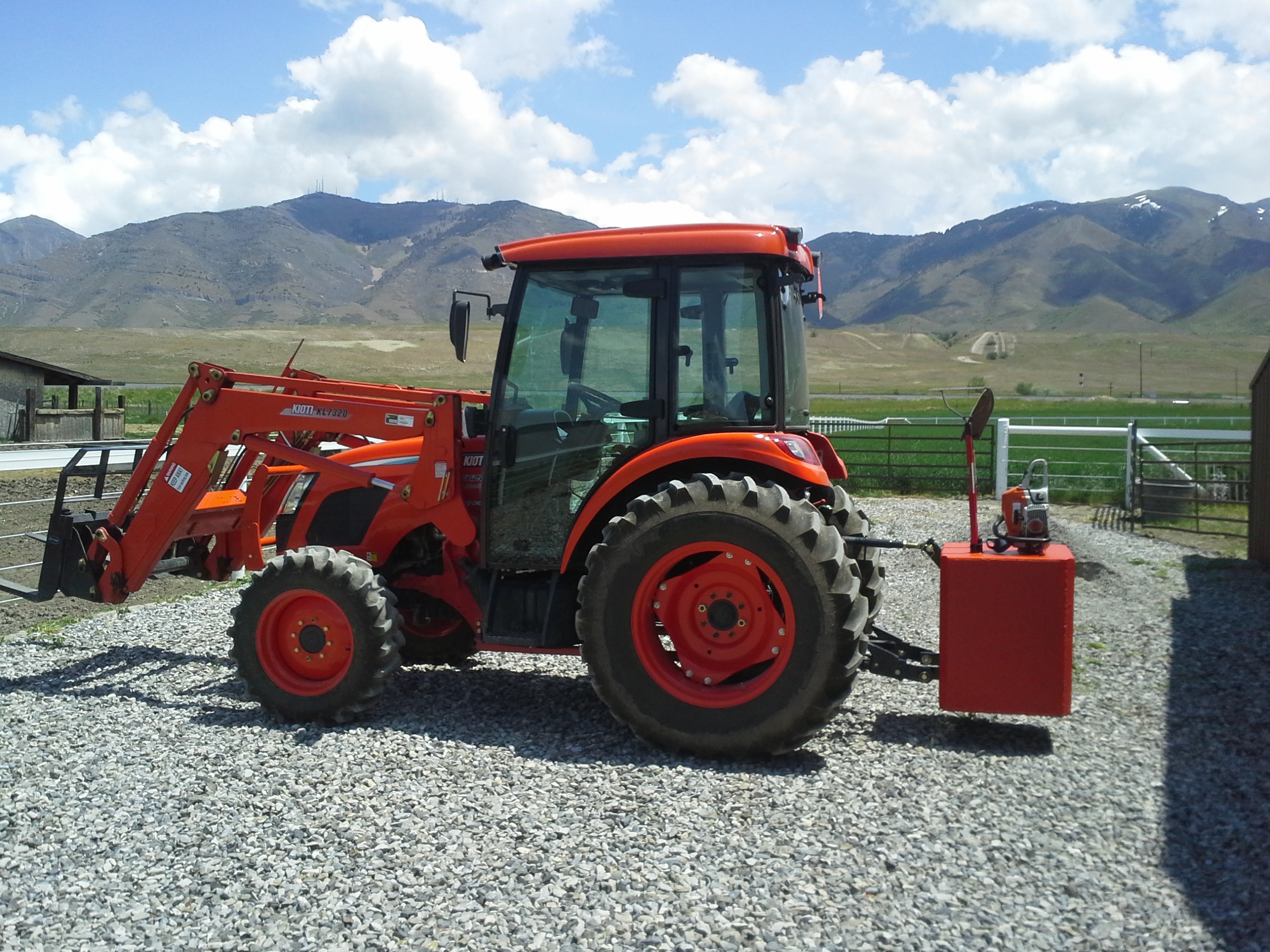

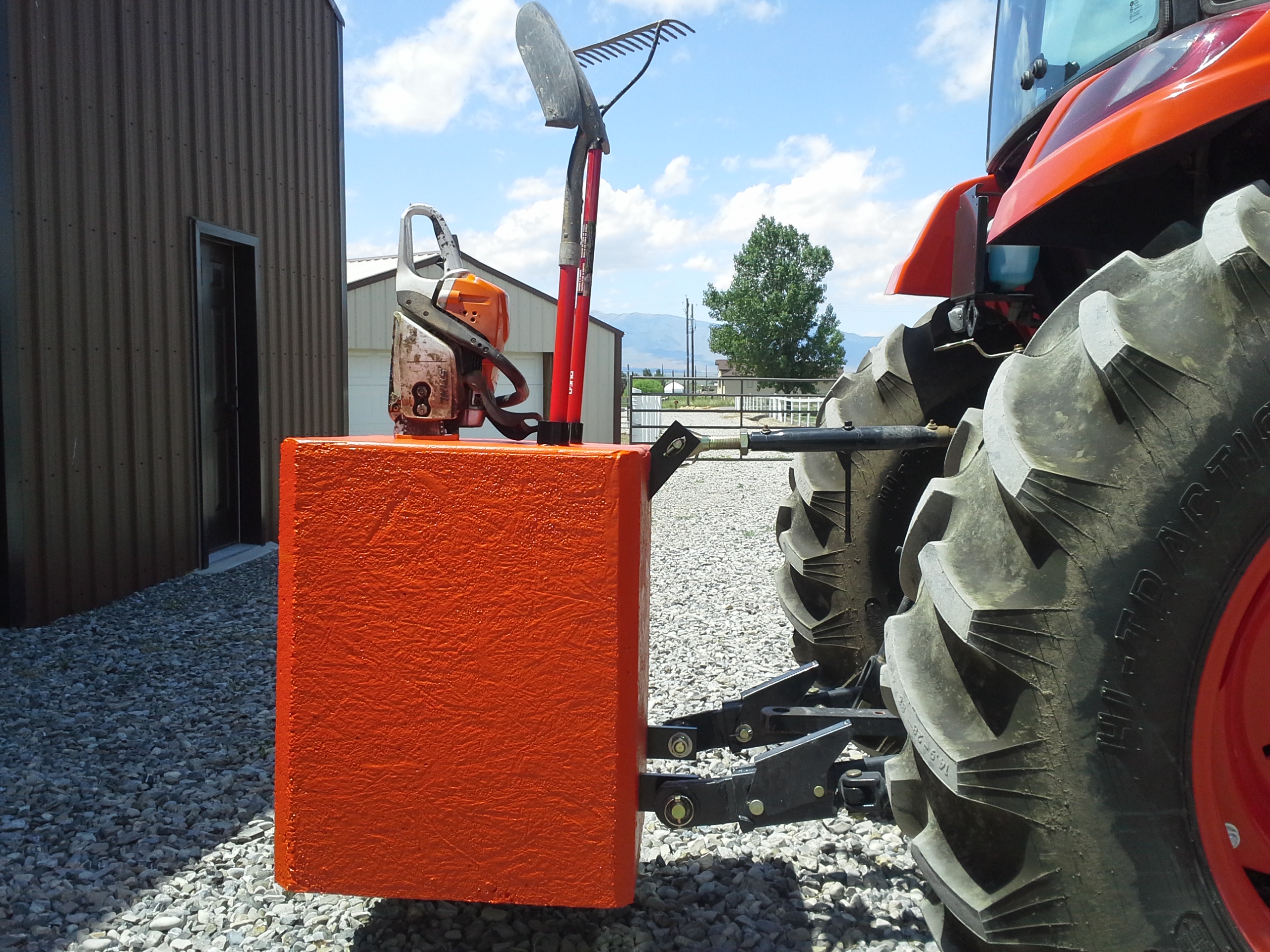

The good thing about building your own is designing it to fit your needs.
BMan (or anyone for that matter) needs to make a checklist of potential needs/uses, then make the Ballast box to fit those needs. Crazyal's needs are different than mine for sure.
Here is a shot of the main reason for my needing a ballast box, aside from the occasional dirt or gravel moving.
Hard to see the box, but it's back there.:)
#20

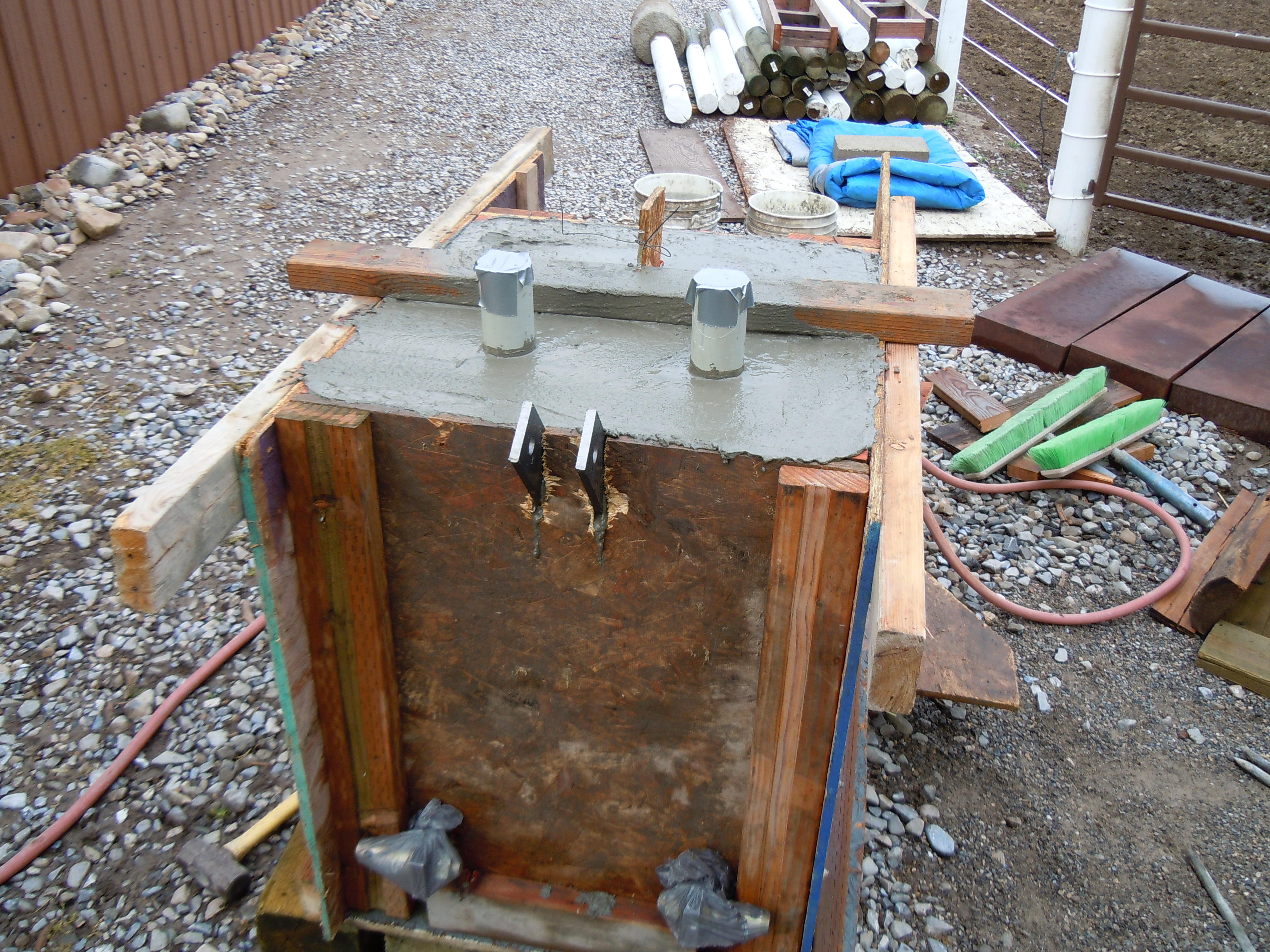

Cat fever, I went over to that thread and looked at how you constructed your box. That's pretty dang creative man and gave me a good base line on how to build mine. I'm going to still use a plastic 55 gal drum because I have one on hand, it'll be a permanent exterior mold, and I can leave the top several inches open to throw stuff in it. I'll definitely mold a chainsaw scabbard in it, a must since usually if I have that ballast on I'll be clearing place on our land. But this gave me something to go buy to put my 3 pt to the front of the ballast putting the weight farther back. I think you saw some of the stuff I was lifting in my other thread about the tractor, plus when I unload and stack round bales of hay it'll really keep the rear planted.
