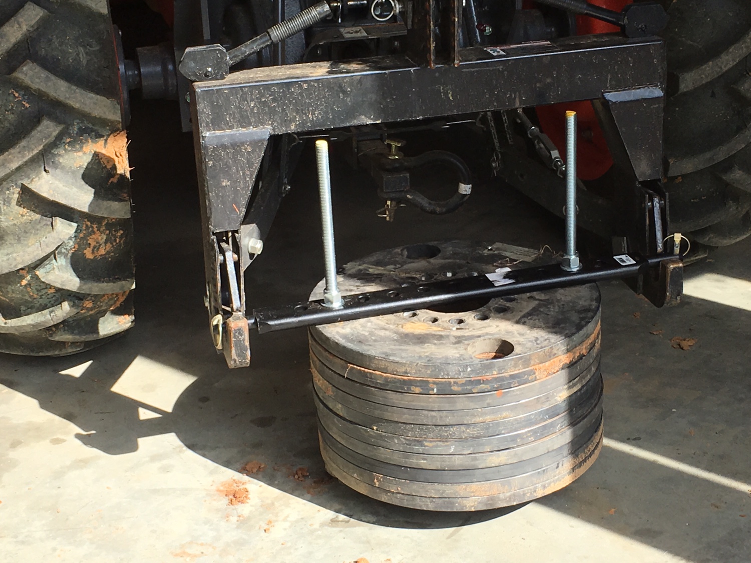

Here's mine. About 650 lbs currently but going to put a few more disks (64lbs each) on the all threads. Hence the long length sticking out. I'll prob put a few of the disks on top this time to keep it compact as possible.
Fast hookup and drop!

That's a great solution with low CG & easy on/off!
What are those disks - wheel spacers, free weights?

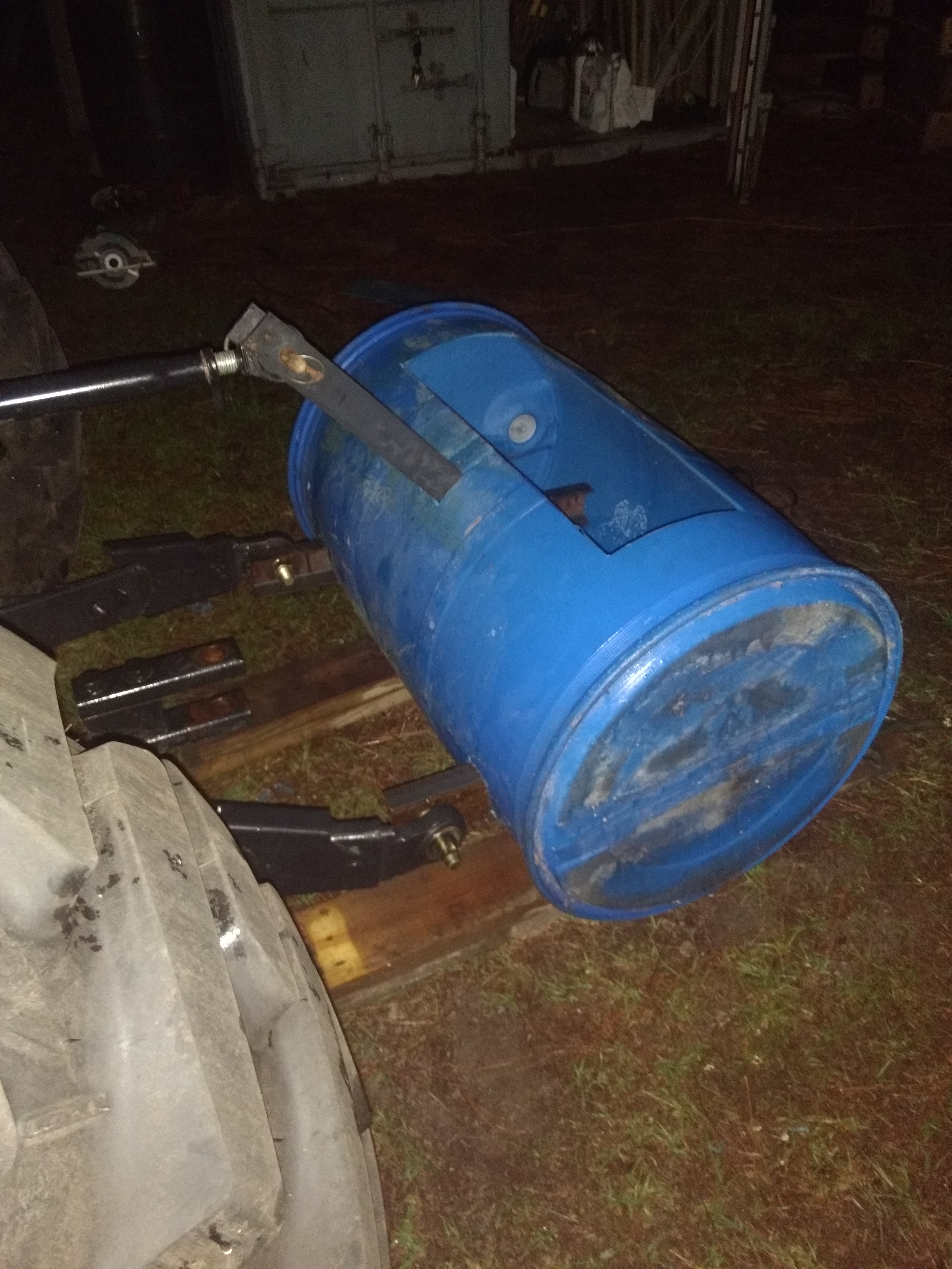

   / Concrete barrel ballast box idea
#35

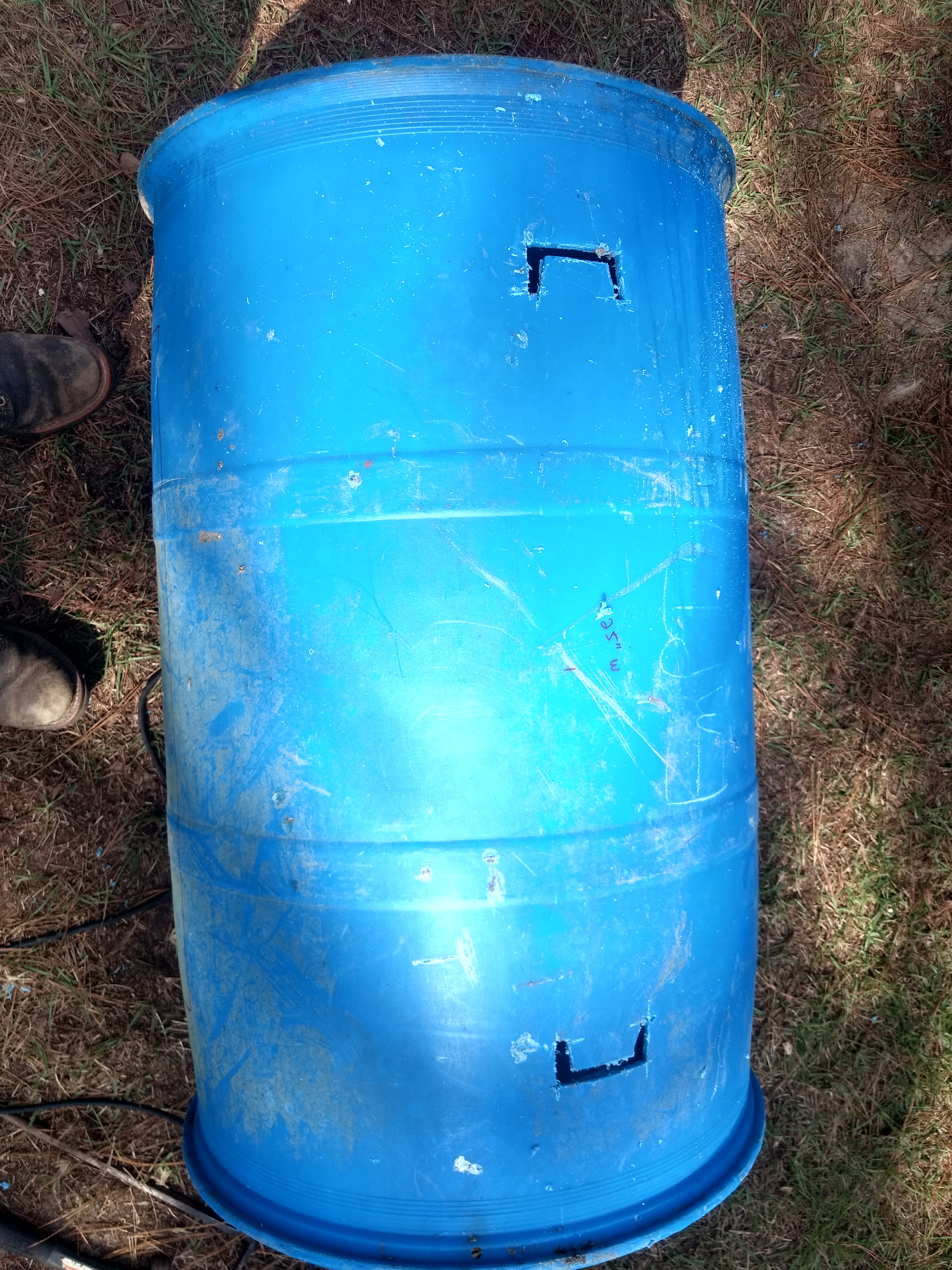

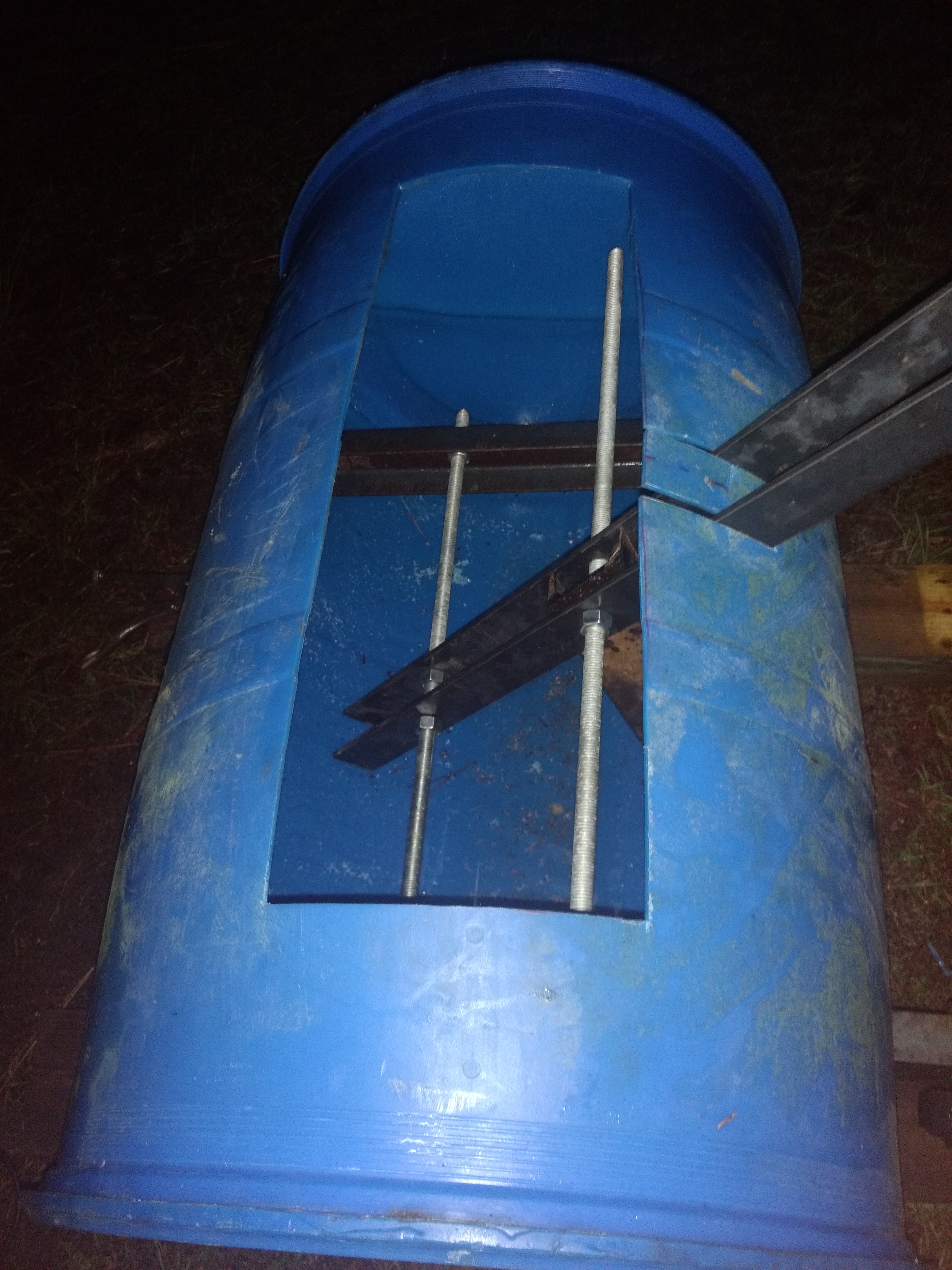

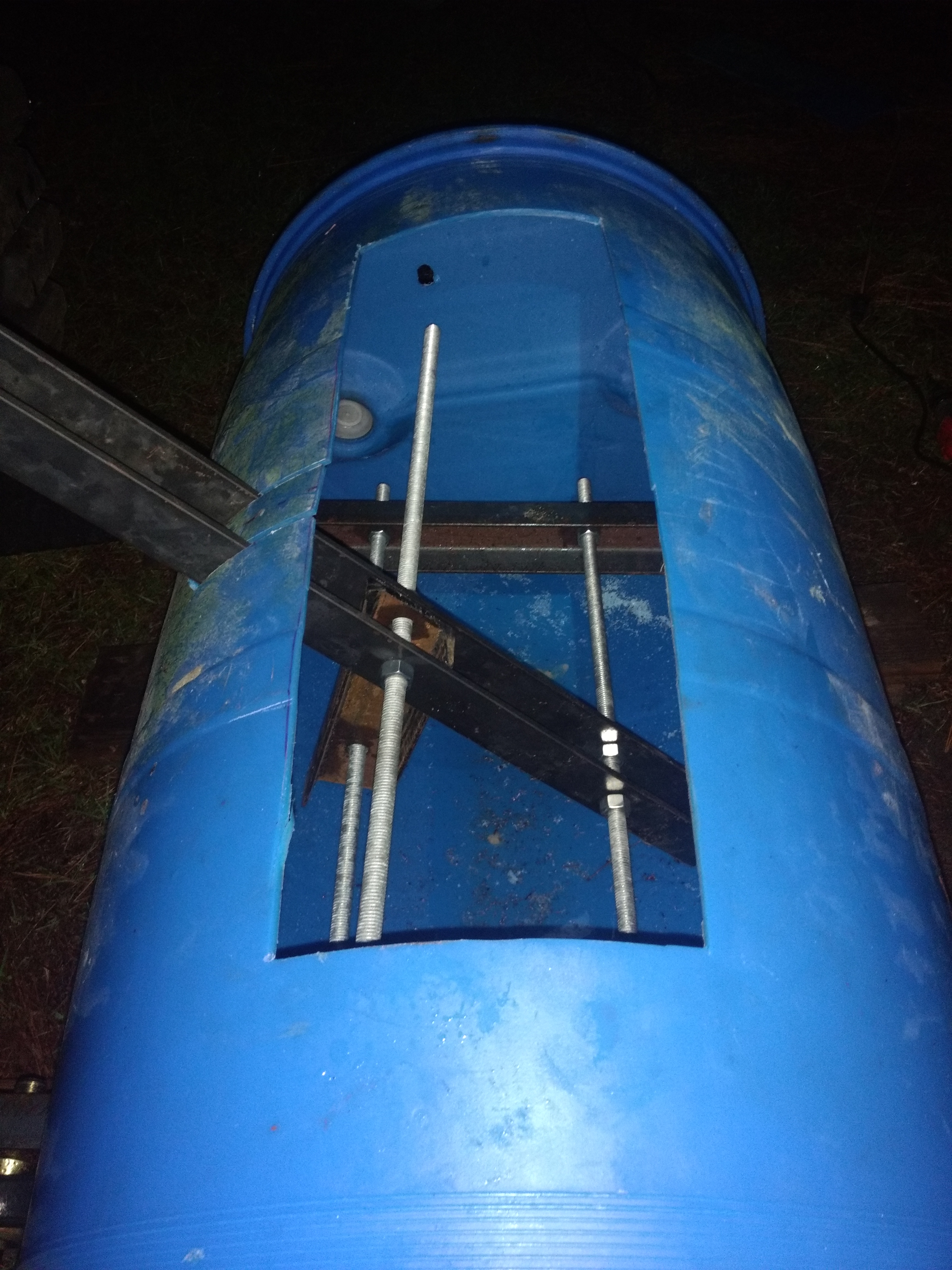

Started my build this evening after work & pretty much finished with the frame to the ballast. I was going to just build a custom box using plywood but I didn't have quite enough for the frame and wouldn't make since to buy any and add more cost to the box so I ended up thinking about it used the barrel. After some measuring and thinking about the final build I got started cutting. I kept the top to the barrel where I cut it out, think I'm going to buy a hinge, and add a weather seal to use it to keep the elements (rain) from getting in my top storage I'll be leaving. Going to use some scrap wood to fabricate it up before filling with concrete. More pics to come & appreciate these ideas!

   / Concrete barrel ballast box idea #36
You want a drain for everything going into the concrete. Water and below freezing temperatures equals poor mans dynamite.
#37
So you think I should drill some random drain holes in the barrel after the concrete has cured also?

Ready for concrete

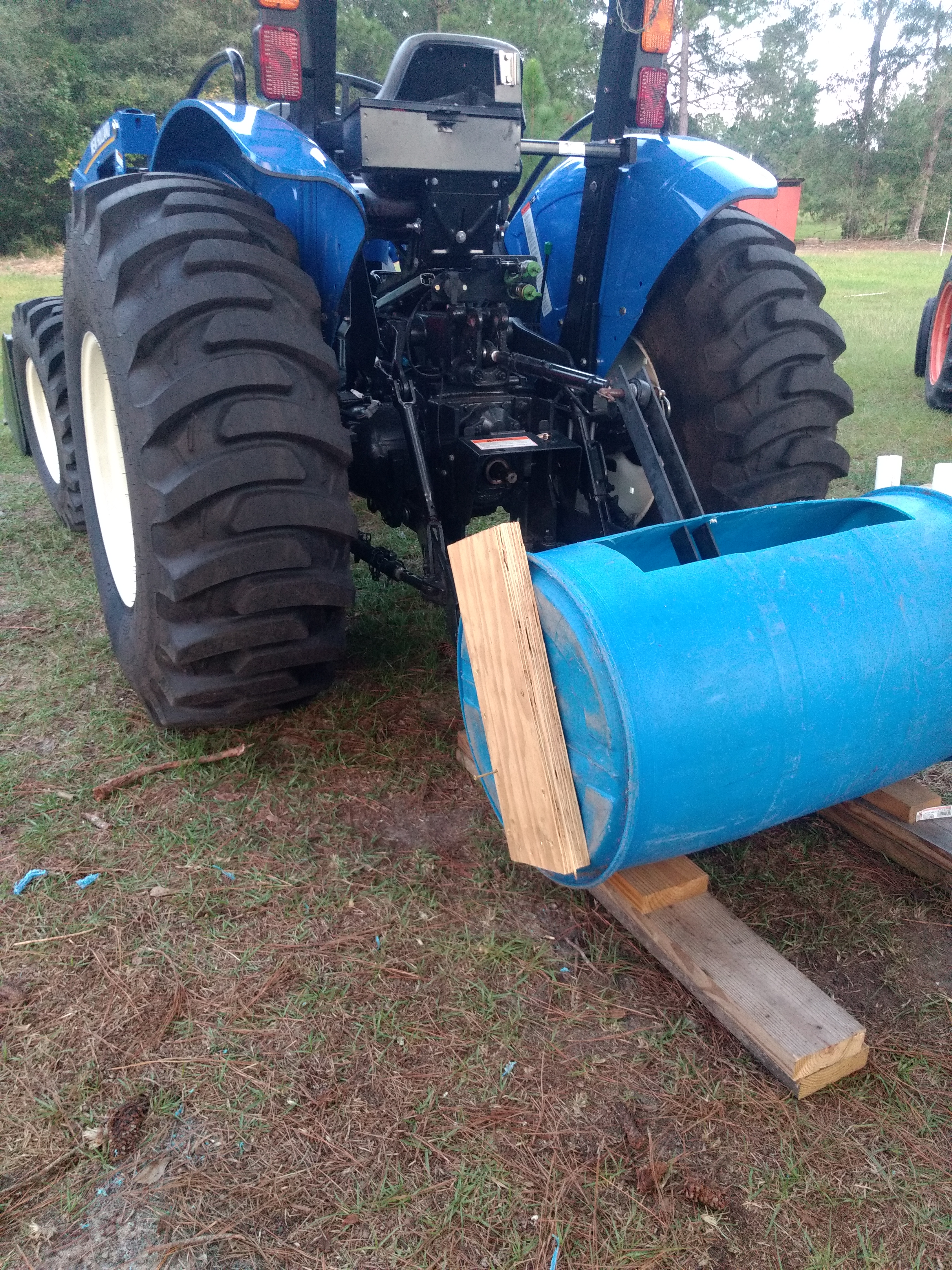

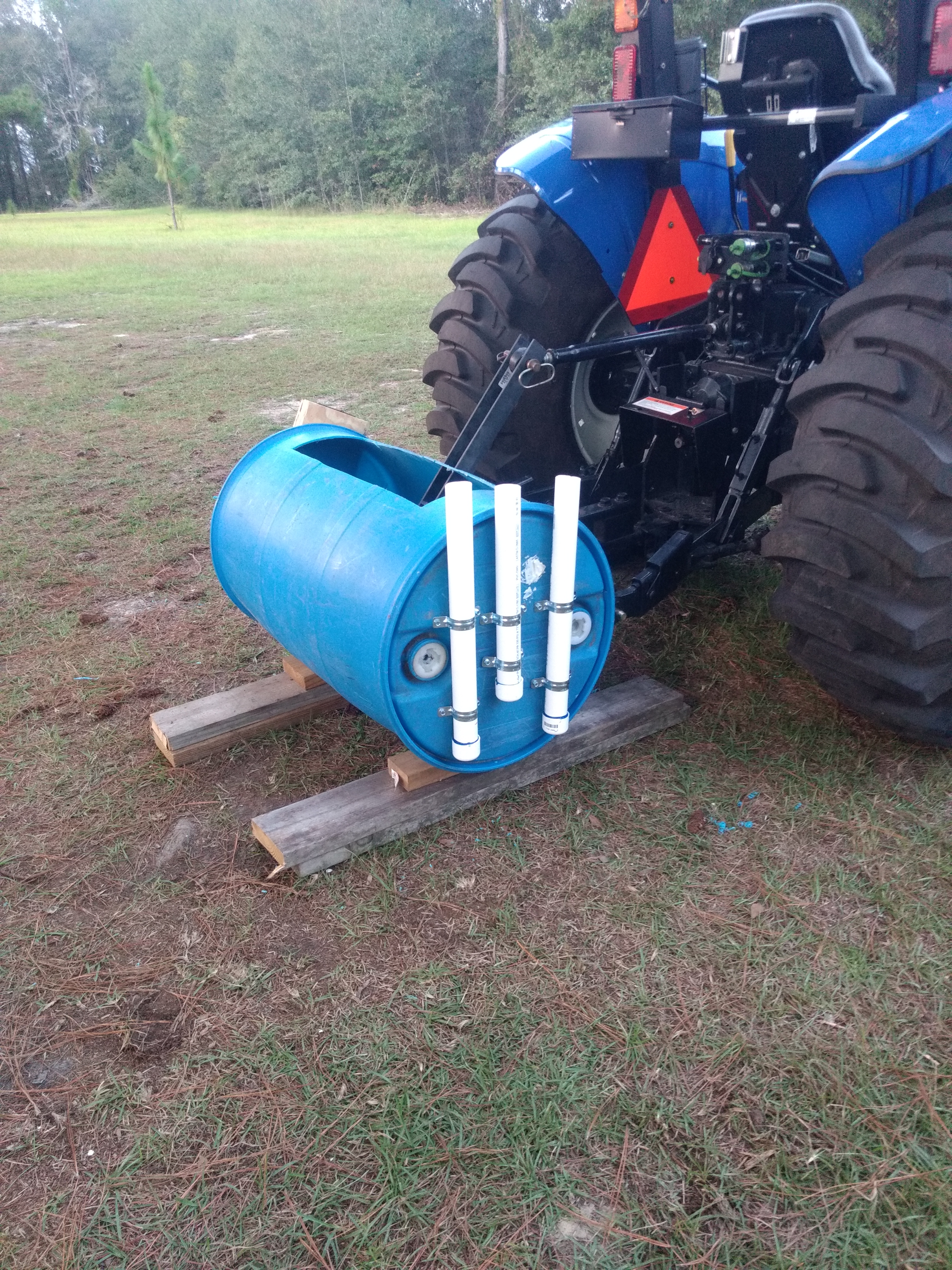

Finished pouring concrete, 11- 80lbs bags. This left room in the top for tools & chains if needed. I decided to put the pipe for my rakes & shovels, & scabbard for my chainsaw on the outside to keep from needing drains after everyone's advise.
How long do I need to let it set before moving so I can paint it?
   / Concrete barrel ballast box idea #40
I think I waited about a week before moving it to paint and a month before actually using it for work.
Looks good, you'll enjoy it.
