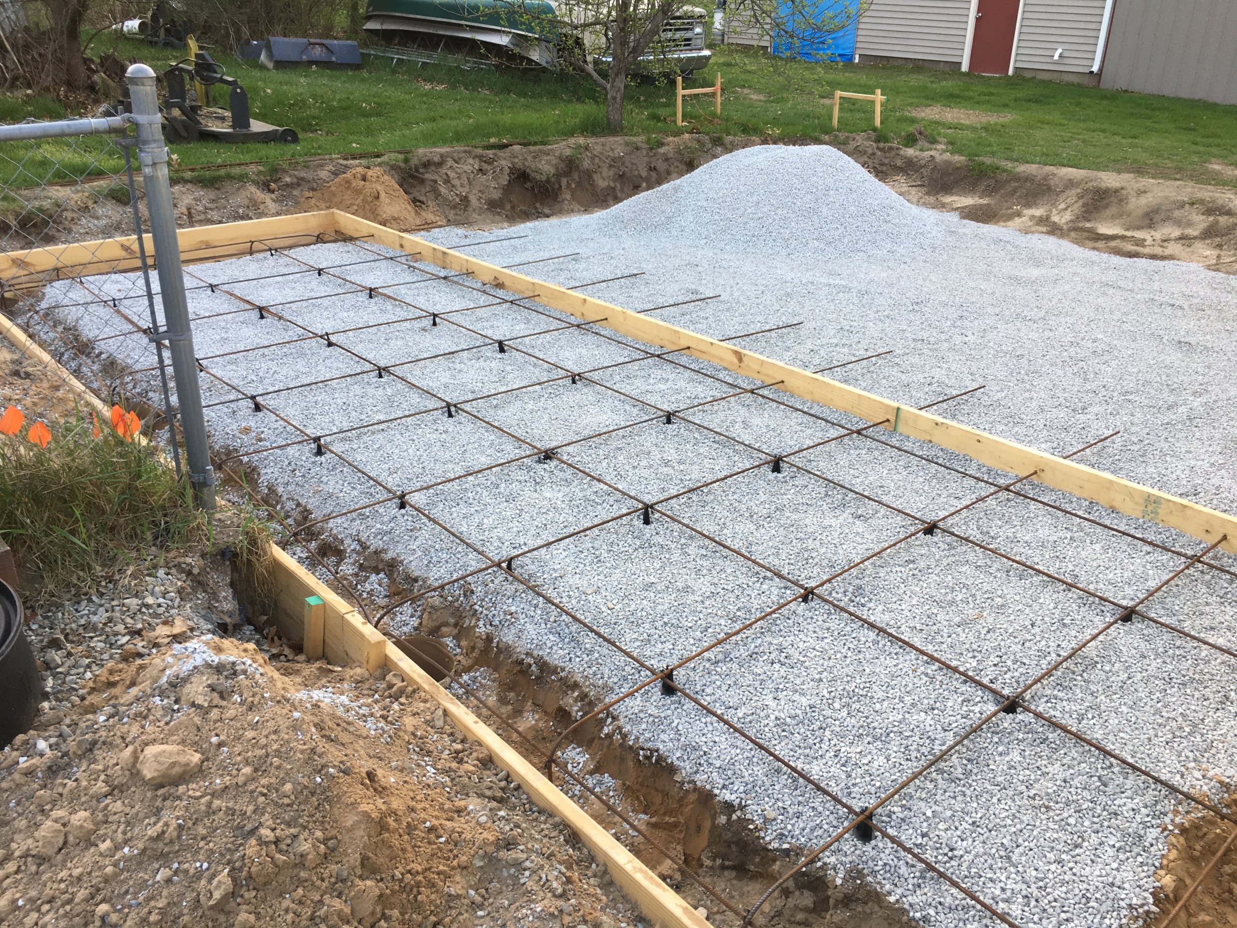

When I did my garage addition in 2020, I used these little plastic chairs. Pretty easy addition, cheap, and I know the rebar isn't laying on the bottom or 1/4" from the top. They are currently .29 each. Not sure what they were 4 years ago.
EDIT: They were .17 each in 2020.
Nice thing about Menards... they keep your receipts on-line for quite a while. :)
(click to enlarge).

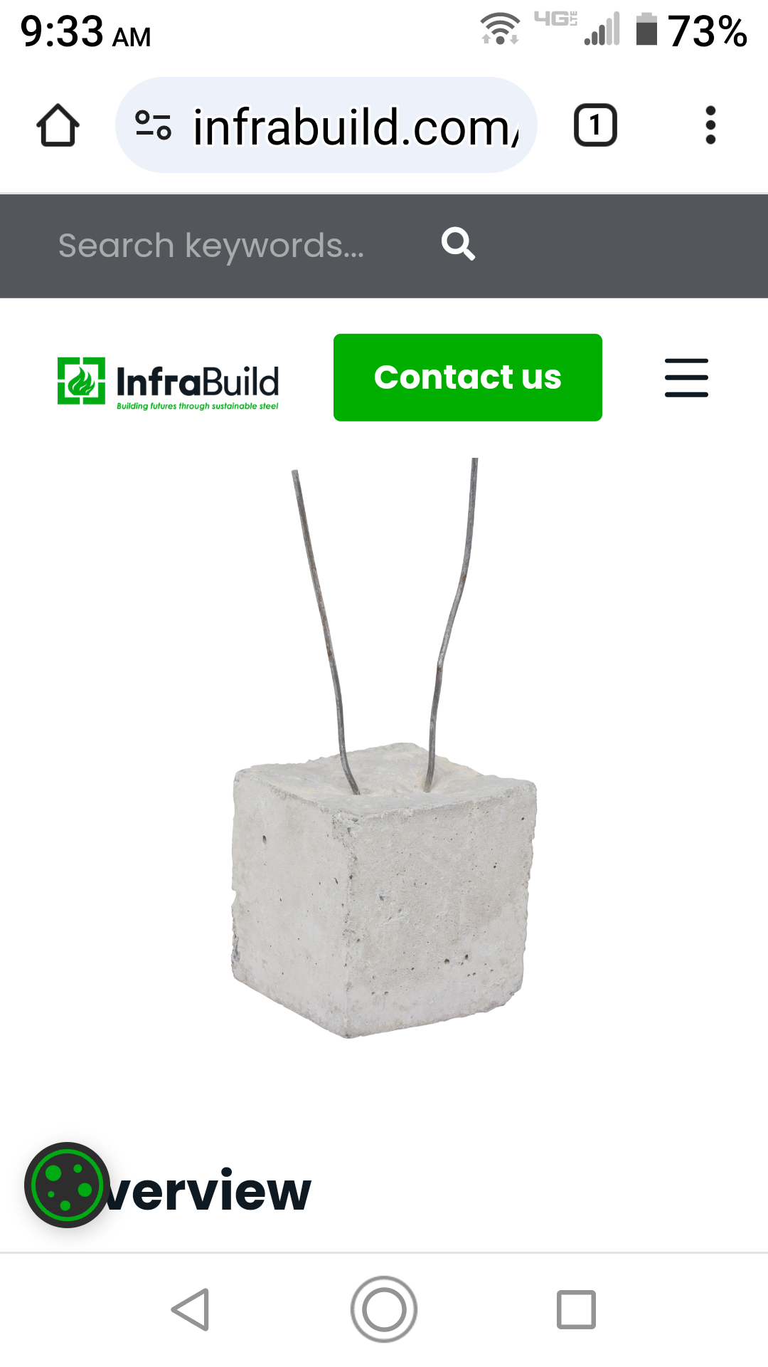

Seen these concrete chairs at your overpriced big box store before, There are lots of companies making plastic chairs apparently it is the new requirement these days. Stubbornness with me prevails and I'll never use them lol.
