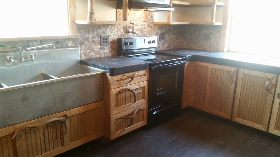

Nice job.. thanks for sharing.. I have been unable to convince my wife to let me try to put them in our kitchen.. I noticed what appeared to be a stainless steel section next to stove??
I included a stainless section so that hot pots can be set down directly on the counter top.

Advantages: 1) inexpensive ($30 concrete, $80 melamine, $150 colorant & additive), 2) if you screw up see advantage #1 3) not having to design around a granite slab 4) almost unlimited colors
Disadvantages: 1) concrete is more likely to stain than granite 2) sometimes just writing a check for something is better so you can go fishing 3) if you don't have lifting equipment, not a one person job

Very well done. I found that all the stains that I tried didn't give me the black color I wanted, so I rubbed black ink into the counter. That worked great and I went from hating how it looked to really liking it, but the amount of frustration that went into getting the color right wasn't something that I would want to do again.

That sink is awesome
