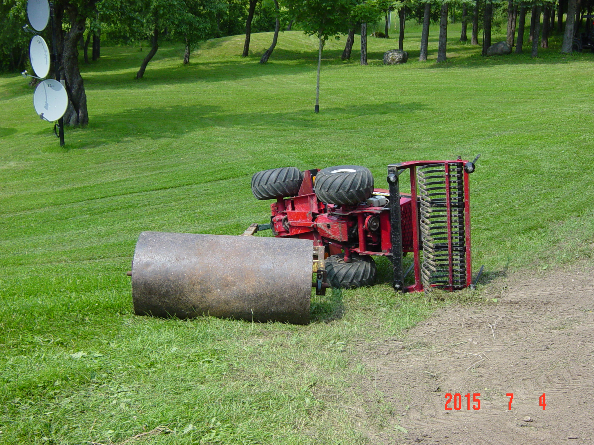

Yes, connecting a heavy roller is a PITA. It can also push over a small tractor if you are going down hill and turn too soon, fast or sharp. Ask me how I know?

450# roller, weight of lawn tractor unknown. I think you will have difficulty aligning 3 drawbar holes so it can be pinned on. Using a pair of clevises don't work very well either. Using the automotive style of trailer connection is cheap and much easier to connect even without a 3pt.
It rolls. No problems getting it into place!
I may have to mod the hitch to give a little more up/down swing but it fared well on its maiden voyage.

I'm pulling it with a Deere x758. I think it can keep 450-800# in check. I have no significant hills.

   / Concrete curing in enclosed space #14
We built this one at work using 24" Sch 40 steel pipe. Each section has a stub piece of 3" pipe that's a bit longer than the width of the section so the sections don't rub each other. It has 4 sections at 12" and the center section is 19". Each one has spokes made of rebar that kept the 3" axle in place while pouring. I had it made in sections so it would make sharper turns without scrubbing.
   / Concrete curing in enclosed space #15
Oooops!
