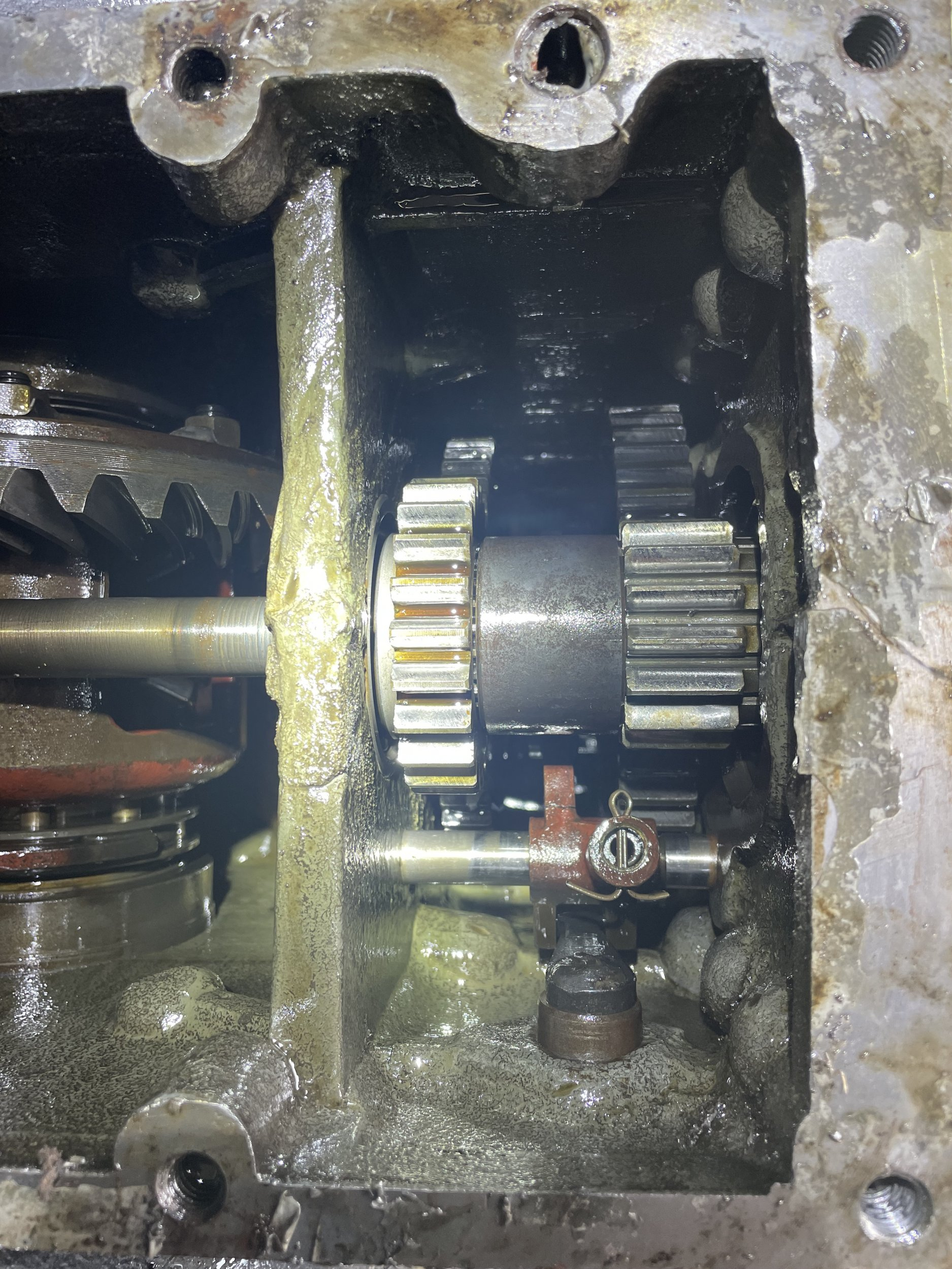

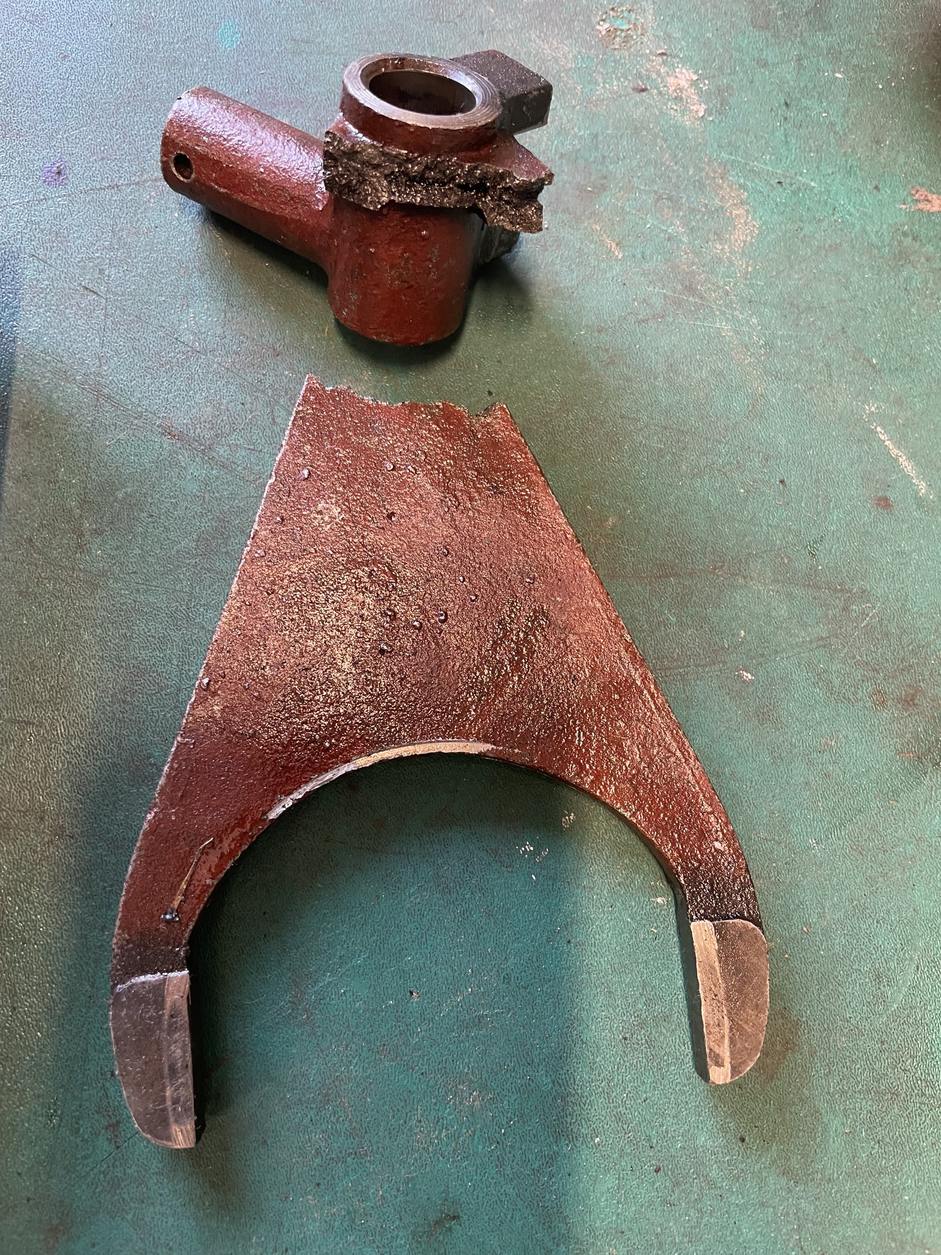

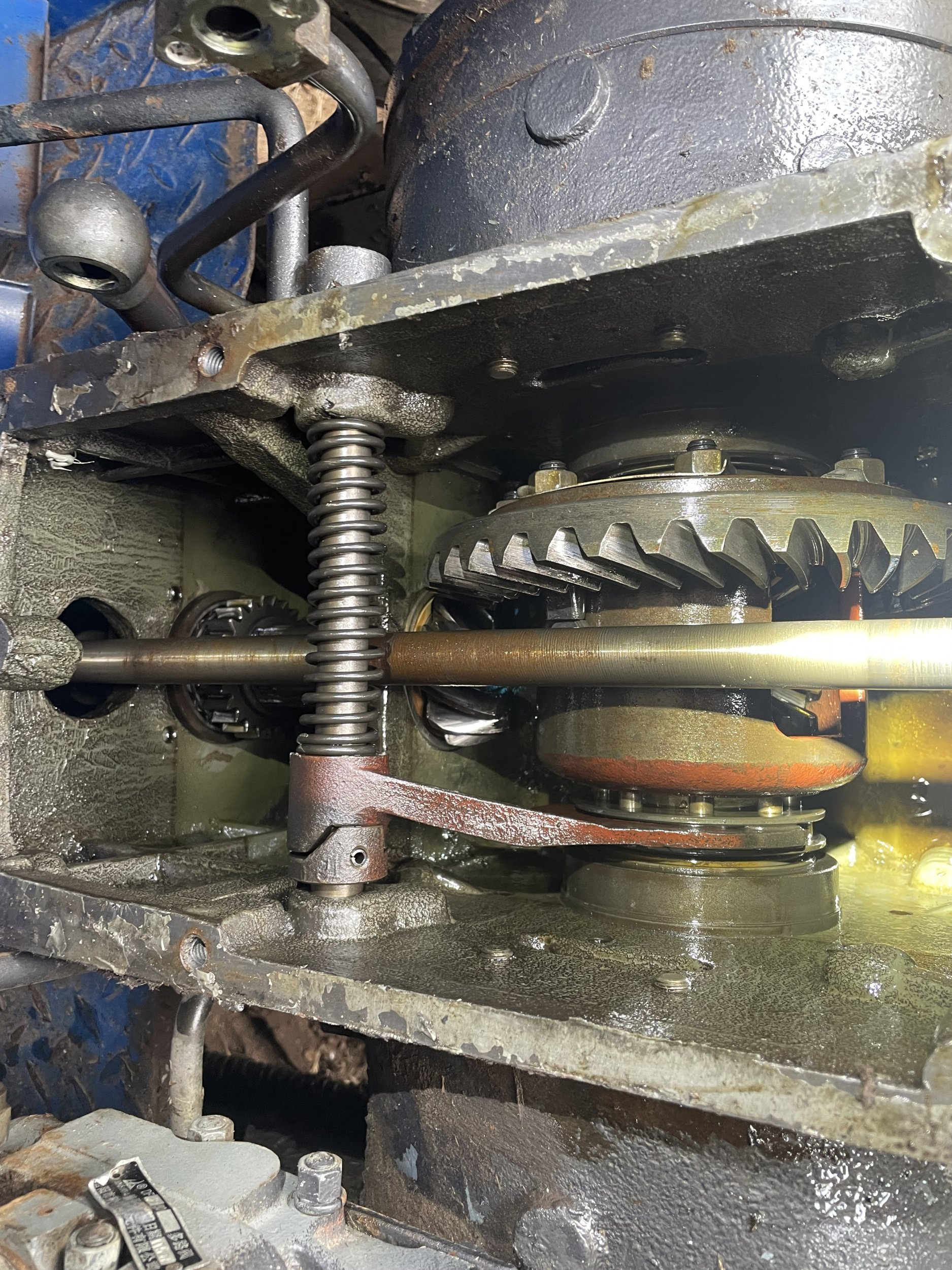

The 3PL assembly is heavy. Really heavy! Minimum of two people or preferably a chain hoist or similar is needed. Once it's off, you can see the final drive gears and the PTO drive gears. And, in my case, I could see why the PTO was not engaging. The cast fork that selects either 540 RPM or 1000 RPM, was cracked - see photo. Fortunately, it had remained roughly in place and not caused any more damage. To remove the selector fork requires removing the drive gears (top shaft) which sit on two very substantial roller bearings held in place by circlips. Removing this shaft through the rear cover took some doing in my case. It'd been there since 2005 or earlier and needed a combination of pulling and some hitting with a drift. But it did finally come apart and allowed me to remove the selector fork. The gears, splines and dog clutches all seemed in good working order. The photos don't show it very well but the general condition inside the transmission is pretty good. The oil was not burned (use a good appropriate oil made for these wet - brake final drives and you'll get no brake squeals) and there were no "big bits of metal" on the magnet. The bearings are readily available 6306N and 6205 roller bearings with or without circlip grooves. I'll put the new ones back with some anti seize on the surfaces!

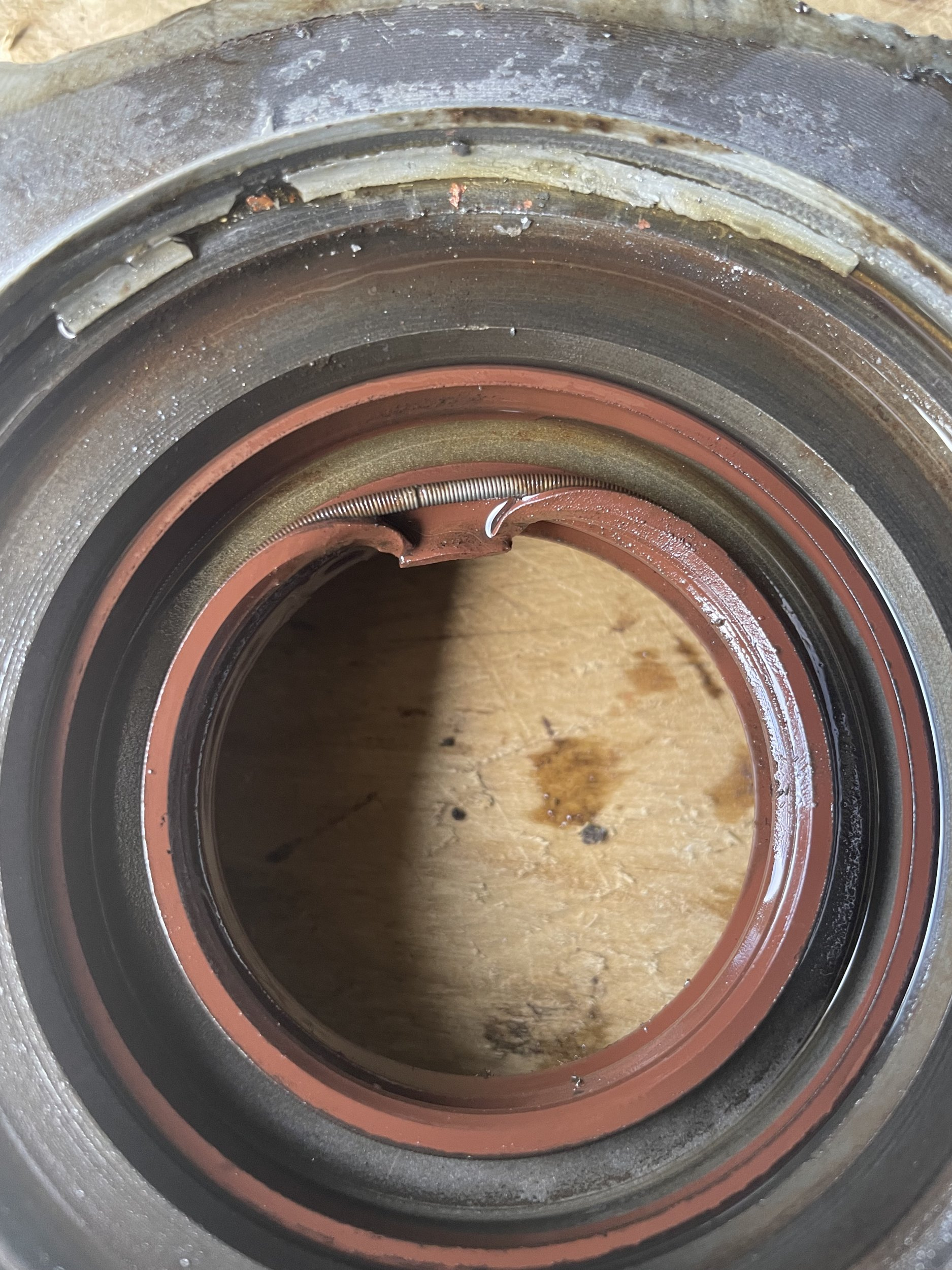

I also found the PTO drive outer shaft seal had been badly fitted See photo) from day one but, fortunately, there are two of them side by side so the leaking had been minimal. The only other thing that was harder than it looked, was removing the split pin and spring from the selector fork. The spring maintains pressure on the ball on the selector rail and it is a substantial spring pressure. For any of us that have had that dreaded experience of these little steel balls falling into the base of a transmission/gearbox, in this case the ball is safely retained in the selector fork. Nice one Chinese engineers.
So, I'll order the new bits, wire brush the bolts, clean the cavities and reassemble. Like most things on these little Chinese tractors, they are massively over - engineered and very simply designed. Tolerances are all over the place and I found no shims and all straight cut gears meaning very little end - loading. They do make a bit of noise when operating however but that's to be expected. But, overall, I maintain my respect for them. They are cheap and made to be maintained and fixed with little complexity and with few special tools. In these days of "right to service" issues and special tools that lie across automotive and agricutural equipment, it's kind of nice to still have things that can be repaired with relatively low skills and a farmer's tool kit.

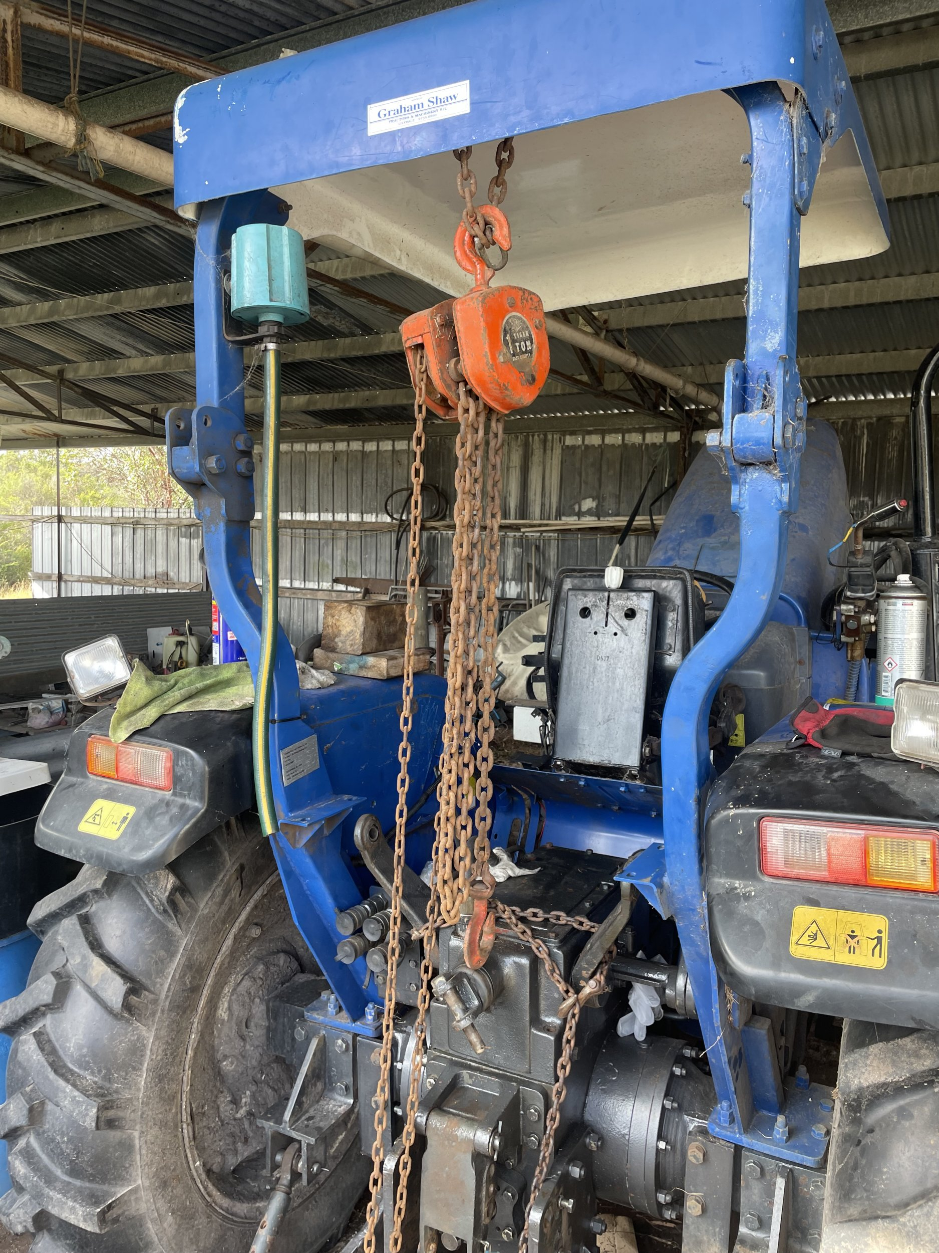

So it's all back together and working. Not overly complex but the bearings and counter shaft take a bit of getting into the right place so the circlips go into place. The bearings for mine were overly tight on the shaft so I polished a little bit off. As I flagged when I pulled it apart, the 3PL assembly which sits atop the final drive and PTO drives is really heavy. With everything cleaned and the old oil drained from not only the main diff' case but also from the transfer case and from the base of each of the planetary gear housings - little drain plugs in all these places - it's time to put the 3PL housing back. The photo attached shows how we did it with the aid of a block and tackle. It is conveniently swung from the ROPS frame at the top and with a sling to the 3PL arms at the bottom. Just needed a little bit of balance from my helper and it could be eased back into place. As I have said before, there's no gaskets in this area so any good gasket maker, RTV or the like will seal up the joint faces. And, if you are contemplating doing anything at this end of these little tractors, go and buy an 18mm socket if you don't have one; there's a lot of 18mm bolts used. Finally, the oil for this area is used by the PTO gears, differential, gearbox, transfer case and the wet disk brakes. As such it should be an Agritrans type oil suitable for wet disk brakes and will have an anti squark additive. 20W-30 (80W) will do it. The 404 takes 27 litres and I caution you, it needs 25 to 27 litres just to appear on the dipstick.
