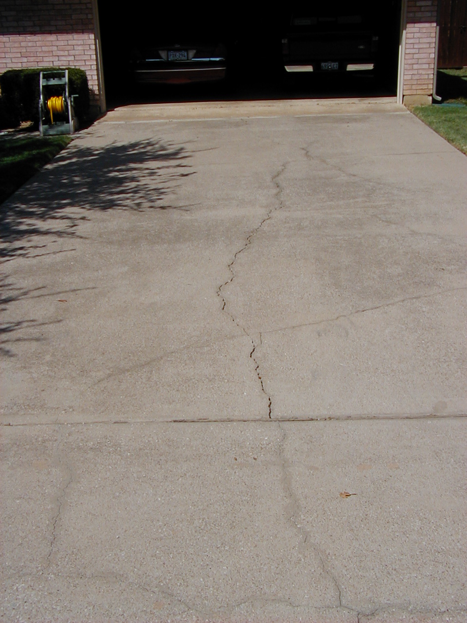

Lots of good suggestions and I thank all of you. There's not any buckling, no heaves, etc. but sure is showing the cracks.

I wish mine looked that good. :D
I'd definitely seal the cracks one time and see how much it moves in a year or two.
   / Concrete Driveway Cost #17
It's a driveway! That looks like it's in pretty good shape. Seal it and save the money for another 5-10 years! I'm sure you can find something else to spend the money on now.
   / Concrete Driveway Cost #18
Yeah I would just go after that one large crack in the middle, and just where it's 1/8-1/4+ inch wide. I wouldn't chase all the little ones.
Anything you do will make them look more pronounced than they are now if you are not careful.
I would get a good polyurethane caulk in a color that is darker than the driveway to avoid a contrast (darker is always better than lighter when patching) and cut the tube fairly small, inject it in the crack, fill it but try not to get any on the surface. you could also sprinkle a little dry sand on the caulk to blend the sheen/ texture in as well.
You just want to make that dark shadow disappear, without it looking like a patch.
All just my opinion of course, But I have made a living being a "patch up - fix up" guy. That's what one old timer called me, not very flattering but not inaccurate either :)
I like to boast sometimes that I CAN make a silk purse out of a sow's ear :laughing:
Good luck!
JB
   / Concrete Driveway Cost #19
I heard on the radio,yesterday,that due to the drought,foundation repair calls are stacked up for months. Especially anywhere near the black clay soil that runs from Greenville to Dallas,then south along I35 corridor. I agree with the post above,I would seal the cracks and look at a epoxy type topcoat.
   / Concrete Driveway Cost #20
Bird,
I agree entirely with JB. An hour with hydraulic cement on the larger crack, then sealer or epoxy and that will be a driveway to win your wife's heart:D
And with the money you saved you can buy another toy. :thumbsup:
