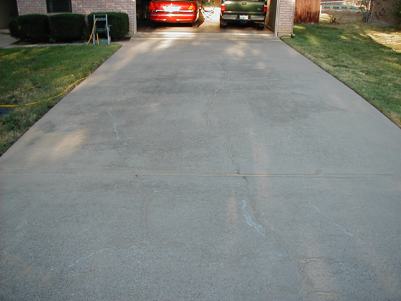

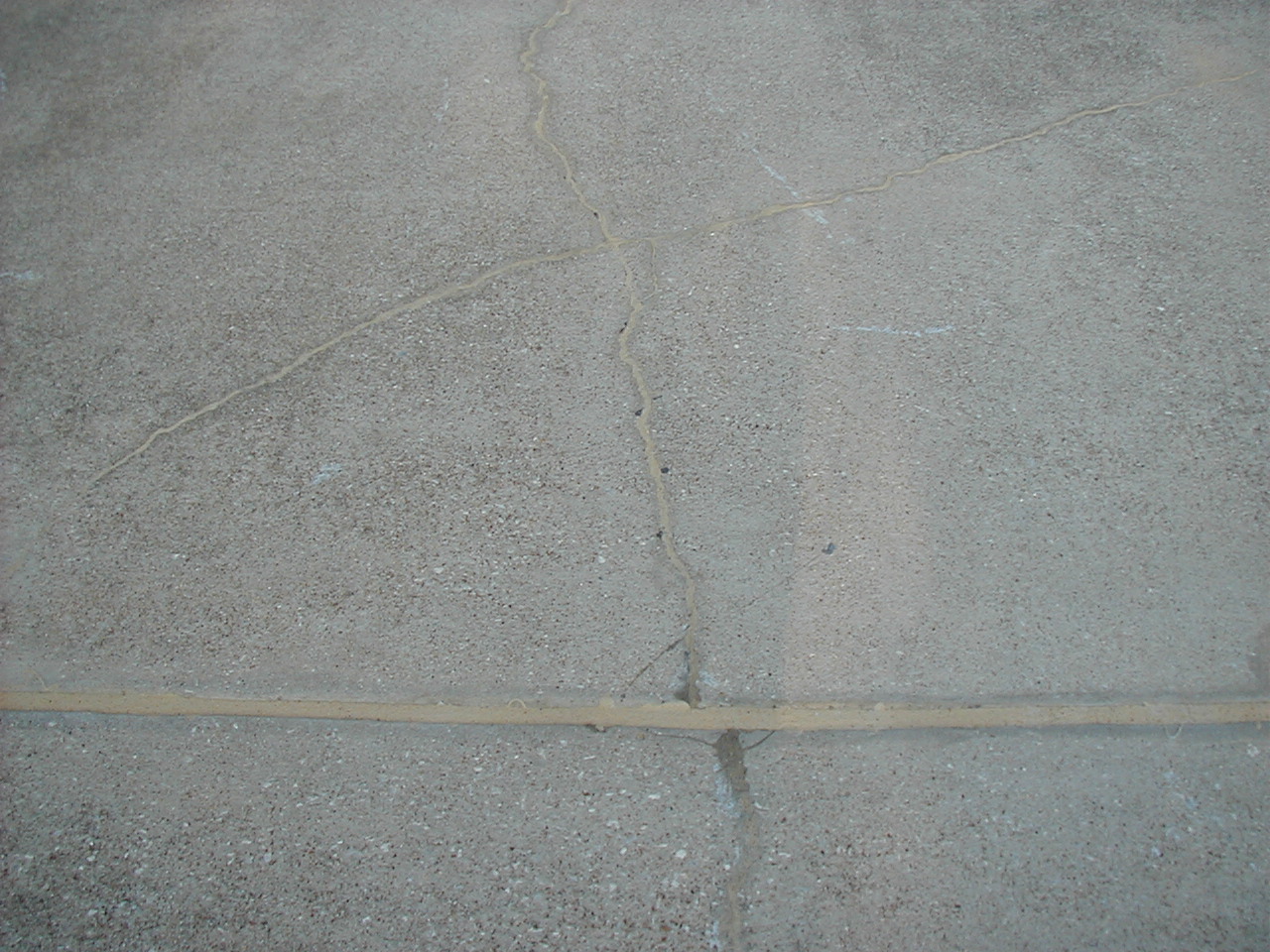

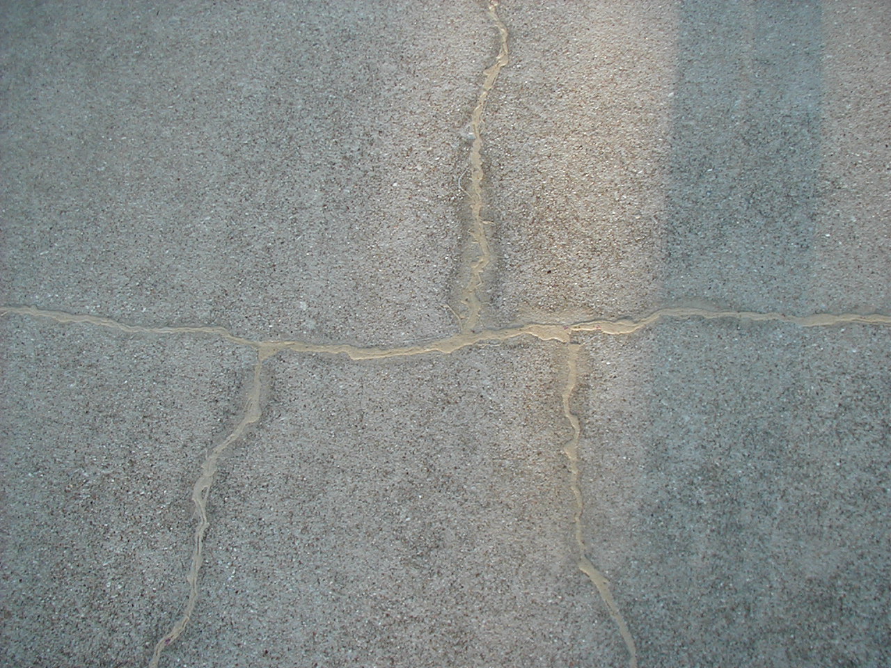

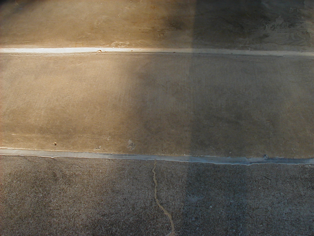

JB, I think this Sikaflex SL is really good stuff, and comparatively easy to work with. Naturally, there are a few ways to mess up a bit.:laughing: And you know I'd find them.;) Of course you apply it with a caulking gun, but it's thin enough that it will continue to slowly flow out of the tube unless you not only release the pressure from the caulking gun, but point the tip UP. So it's easy to get a little too much in places. On the other hand, it's slowly sinking into the crack or joint, so you sometimes have to go back a few feet to finish filling in there. That's not a problem except for trying not to string some of it in places you didn't want it. In other words, it's easy to get too much or too little. But overall, I think it's great. It's dry enough that yesterday I hosed off the driveway.
The first picture is from the street.
The second picture is the expansion joint just before the driveway flares to the street.
The third picture is the expansion joint I did in December, 2009, at the garage apron. You can see the difference in color in that one vs. the new ones on which I applied play sand. (The difference in the light in that photo is because the sun was coming up and hit half of the driveway:)).
The fourth picture is about the middle of the driveway where where one crack goes across the full width of the driveway and the other the full length of the driveway.

Yep, that's right, JB, I made some little stakes that I drove in the ground at the ends of the expansion joints and at the ends of the crack that went all the way across.
This did turn out to be much cheaper than tearing out the drive and rebuilding it, so I'm happy with it.
