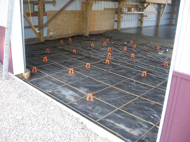

Also consider using concrete bricks instead of plastic "chairs" to keep the rebar from sinking to the bottom.

I like rebar in concrete. Not hard to do yourself.

Concrete without steel is too foolhardy to comprehend!
