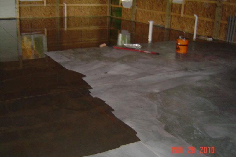

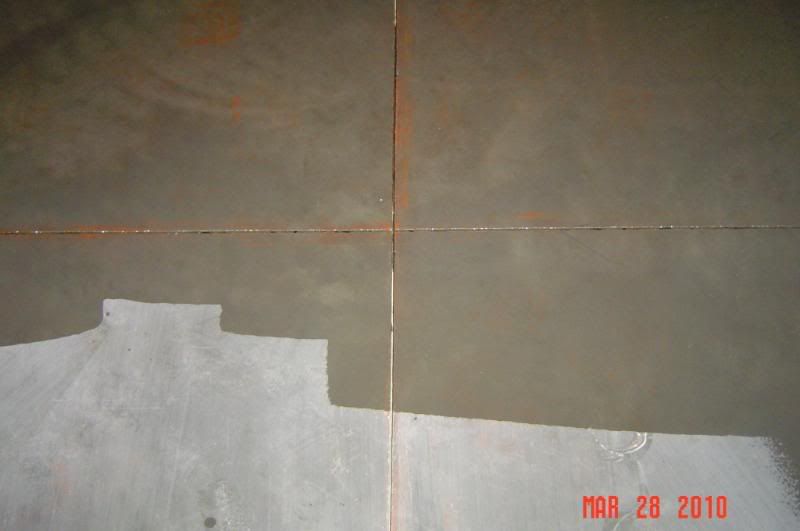

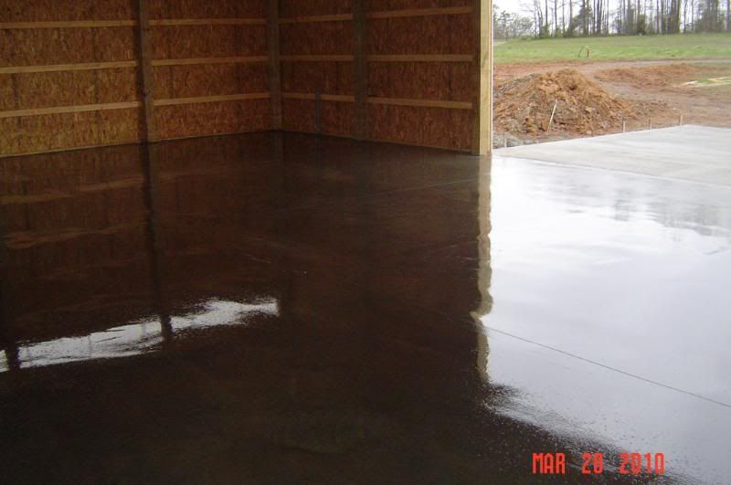

Basf Cure n Seal
http://www.cascadeblock.com/media/pdfs/sealants_coatings_cleaners/Kure-N-Seal25_ProductData.pdf
This is not a water based sealant. It is an Acrylic covering. Very easy to mop and sweep. When I dropped some of the spray foam sealant on it, you let it dry and then it just pops off with your foot. The smallest quantity you can get is 5 gallon pails. I think it runs $50-75 per 5 gallon and is sold only at commercial concrete supply houses.
Mine was bought at AH Harris in Richmond VA. It took 15 gallons for 2 coats 40 x 64.
I had to do a special coating where I installed vinyl in a bathroom for the glue to stick.
More pictures are on my link. The concrete turns very dark when applied to new concrete. Can be used on new or existing concrete. Higher PSI are reached when used to slow cure rates.
