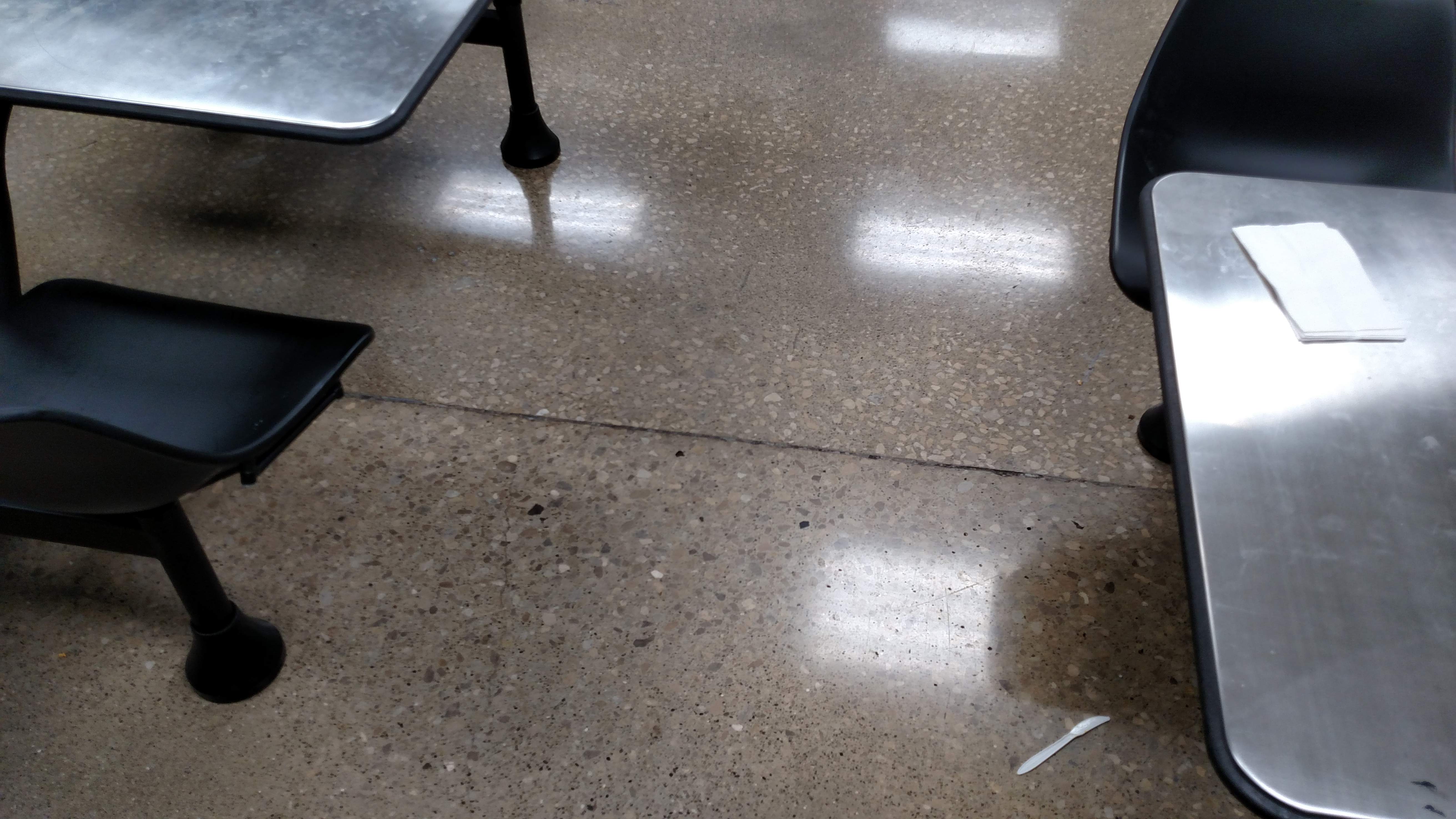

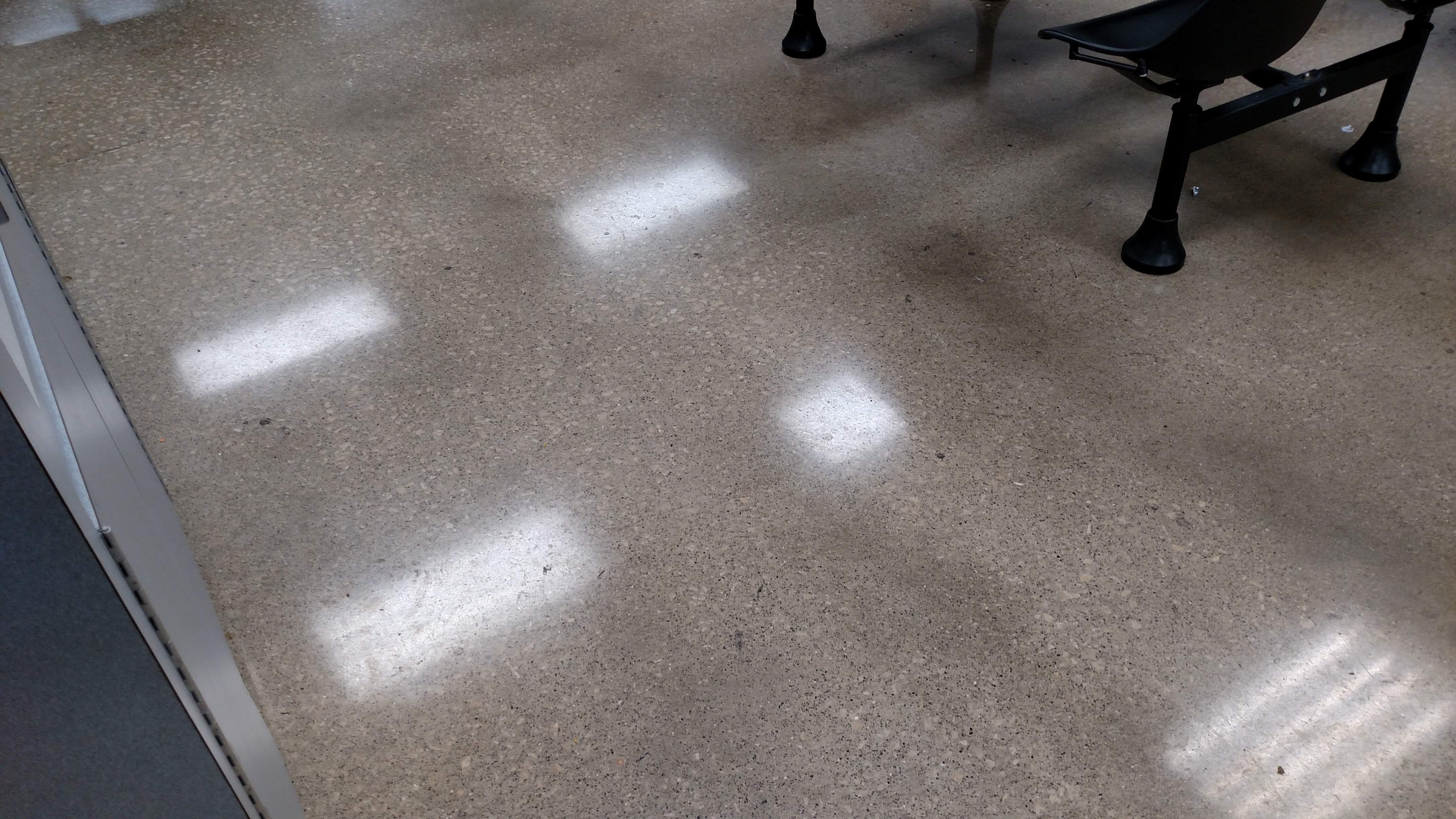

Here are pics of 30-40 year old concrete that has been living under vinyl tile tile just last month. All I know is they went to 800 grit and then sealed. Have no idea beyond that. I really like the look, though I don't want it quite that slick.

Go to your local rental yard and see what they have. I've rented the ones with 3 stones that you put in with wood wedges. You have to buy the stones and they come in different grits like sandpaper. One type for removing a bunch of material, another for smoothing and another for making it shiny smooth. You just stand there and hole the machine while it spins and grinds down the concrete. It's real simple to use, but you do have to make sure you keep moving along so you don't wear down one spot more then another. With a fairly fresh pour, the concrete is still pretty soft and the sooner you get on it, the easier it's going to be.
