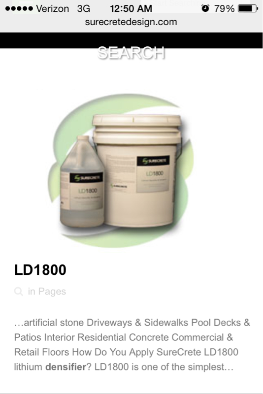

LD1:
I'm hoping to see some picks soon! As for sealer some water repellant I picked up at menards seems pretty good called "water block" & is clear & seems to seal pretty good designed for patio blocks but worked well on outside surface crack I had last year & going to coat entire outside of my concrete this summer already bought some fillers for the cut lines and crack.
I tried some of the Rustolium stain which failed miserably as did the clear top coat same brand. brake cleaner picks it up instantly as does gas or break fluid after a few.

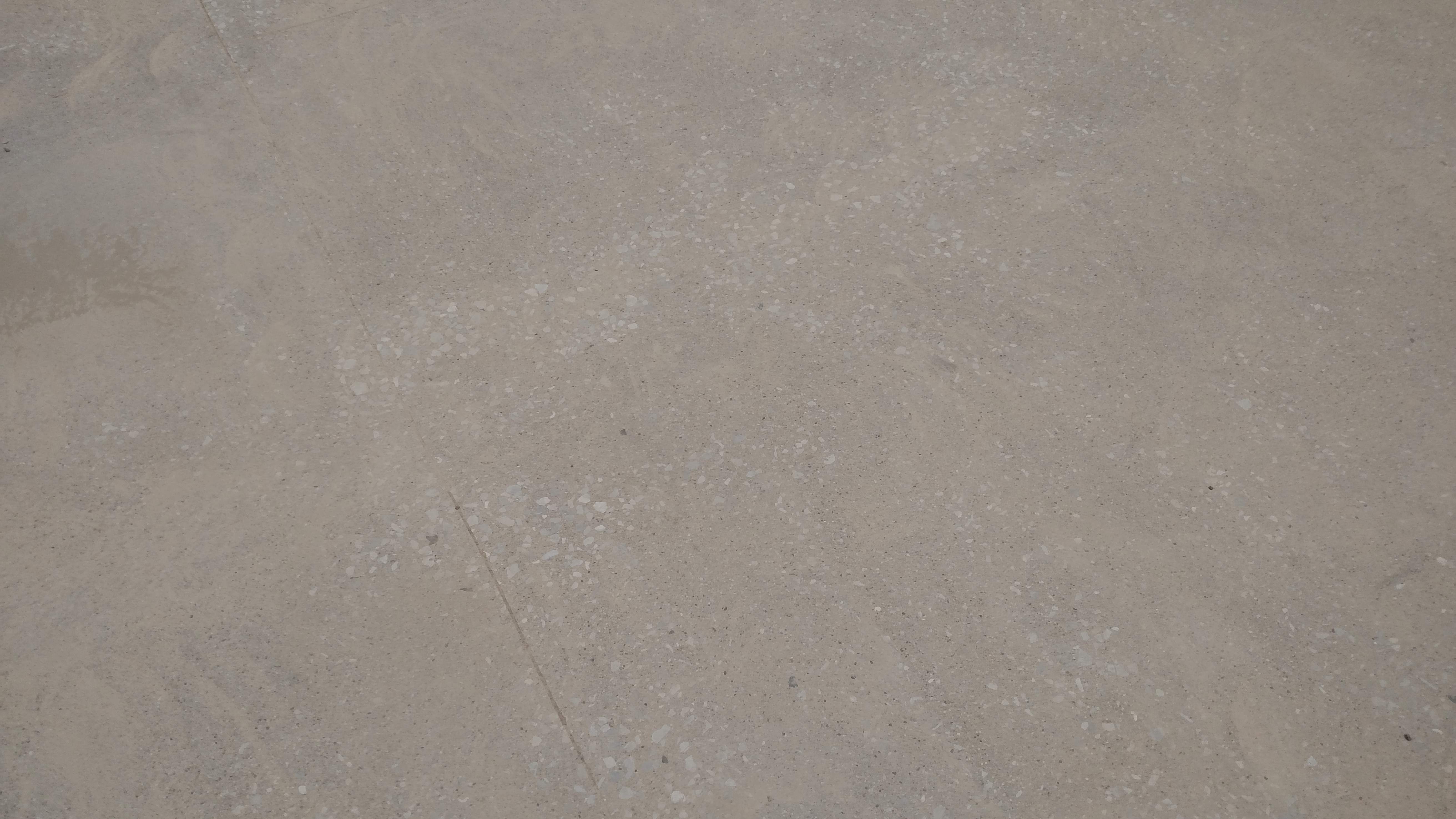

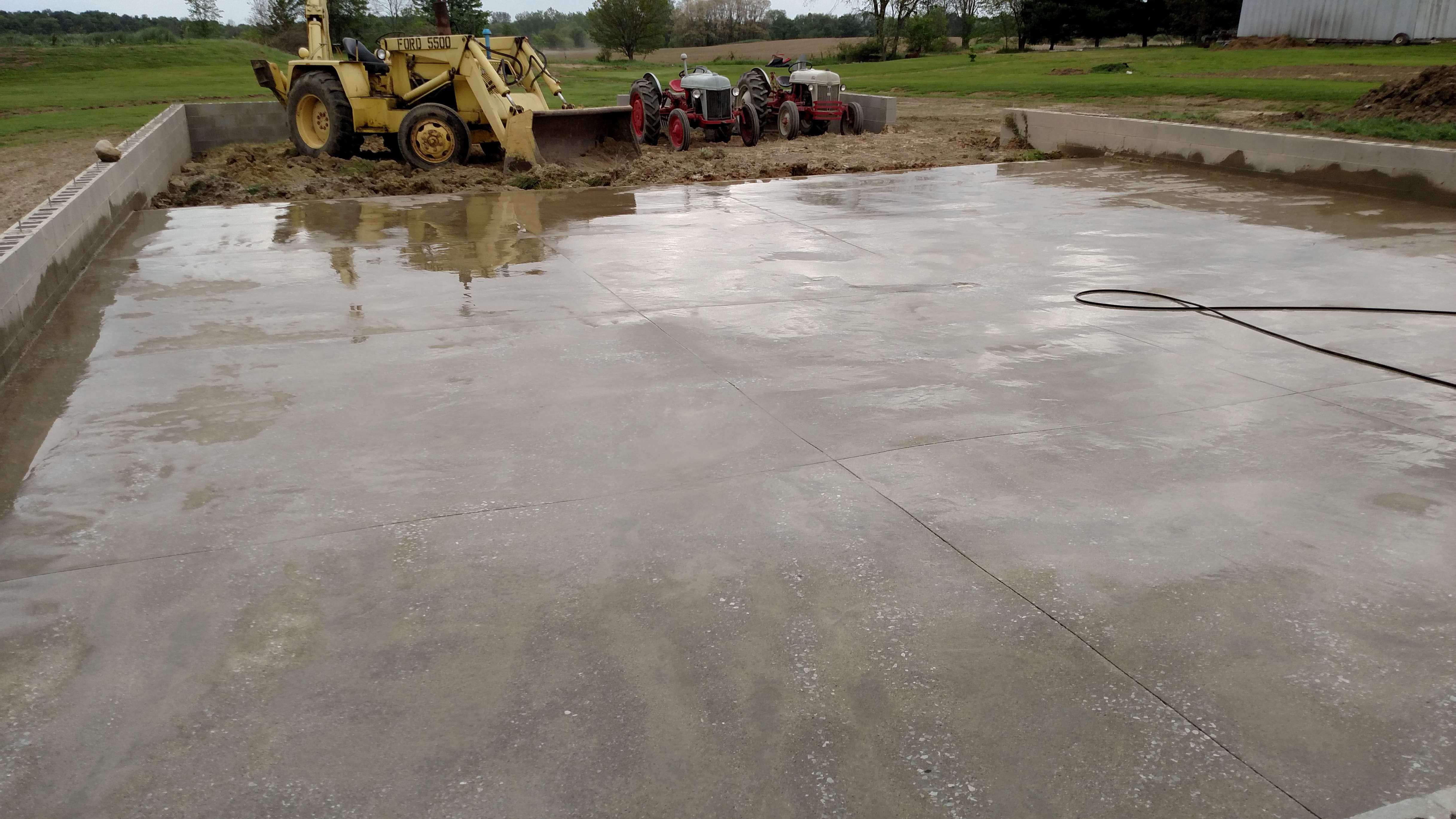

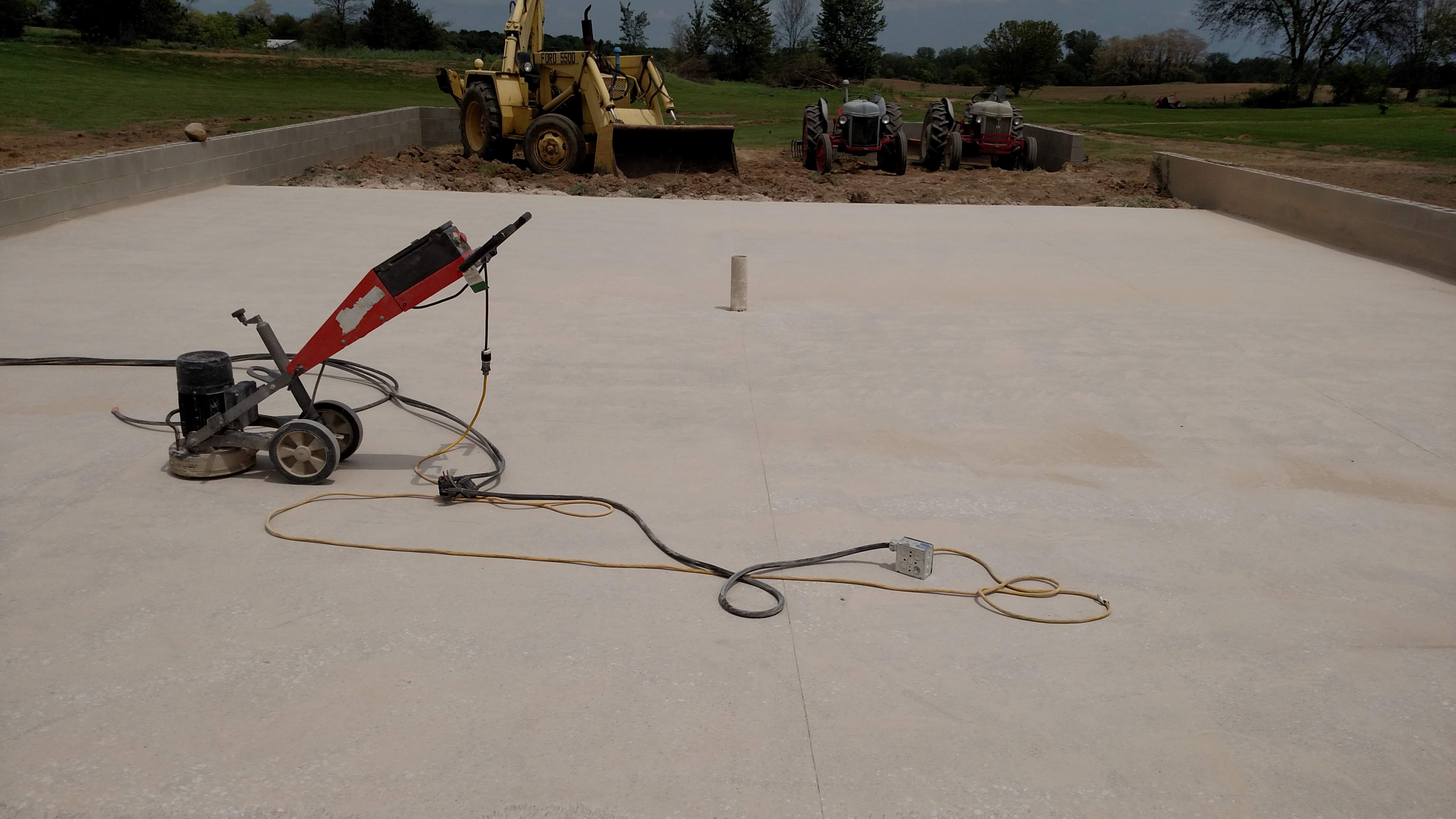

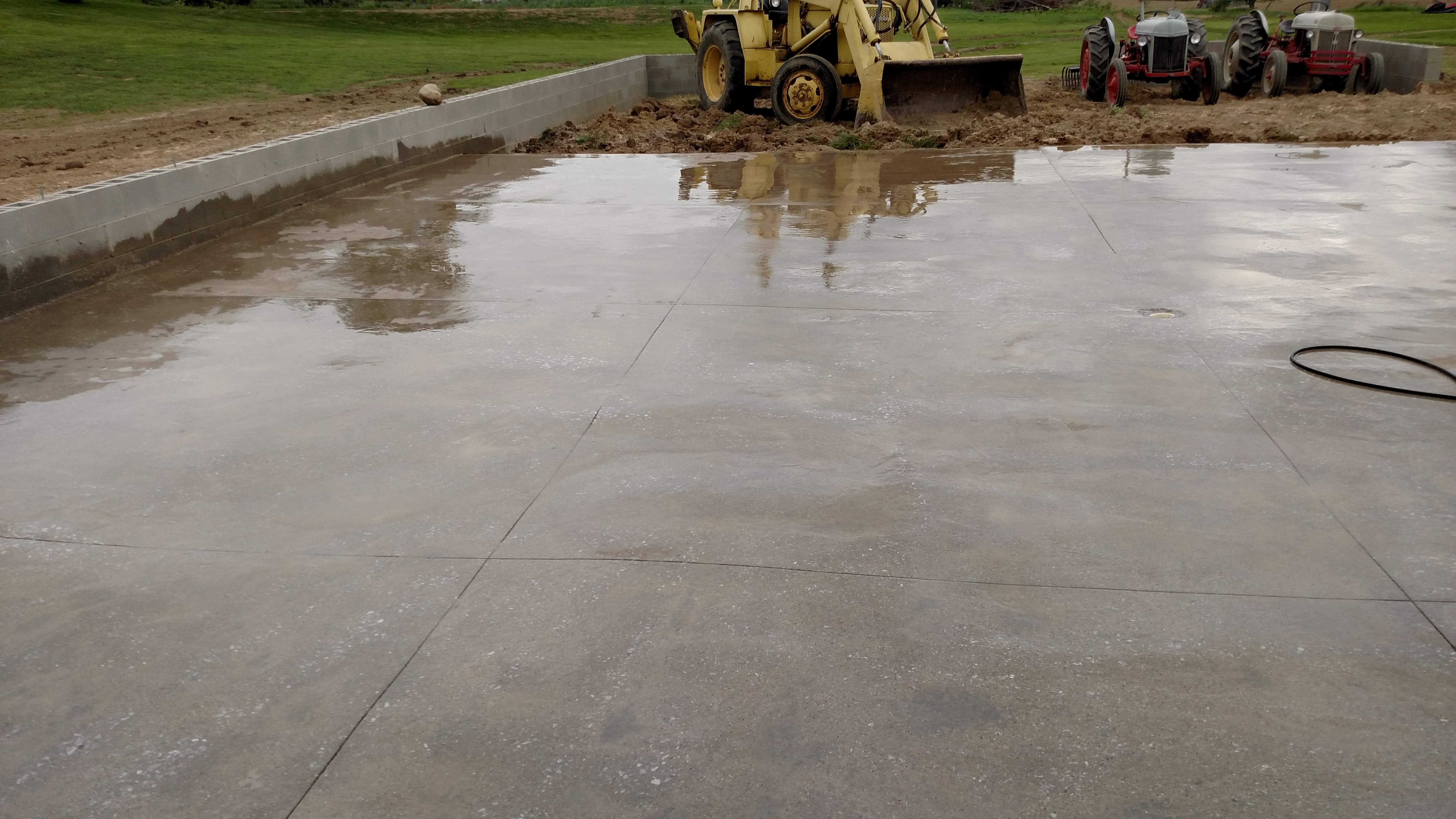

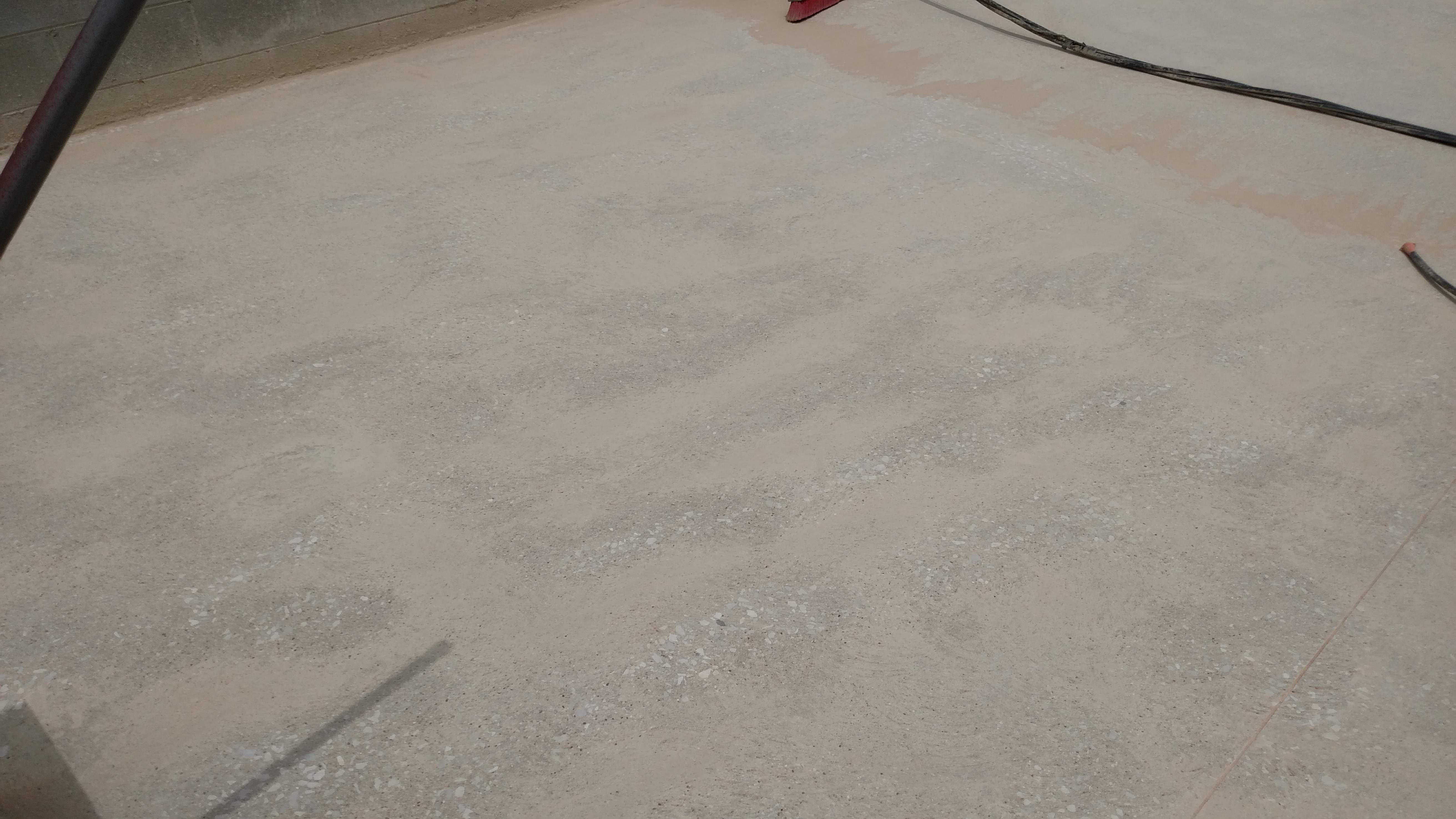

   / concrete for grinding / polishing
#25
Here is a bunch of pics. The first ones are dry just after sweeping. Then I powerwashed it, and those are the remainder.
Now the densifier, I assume lithium is what I want. Any recommendations on where to buy aside from online? If I am gonna do this, it needs to happen now as I am getting lumber delivered friday and will be set on the slab. So its now or never and dont really have time to wait on some to show up in the mail.
