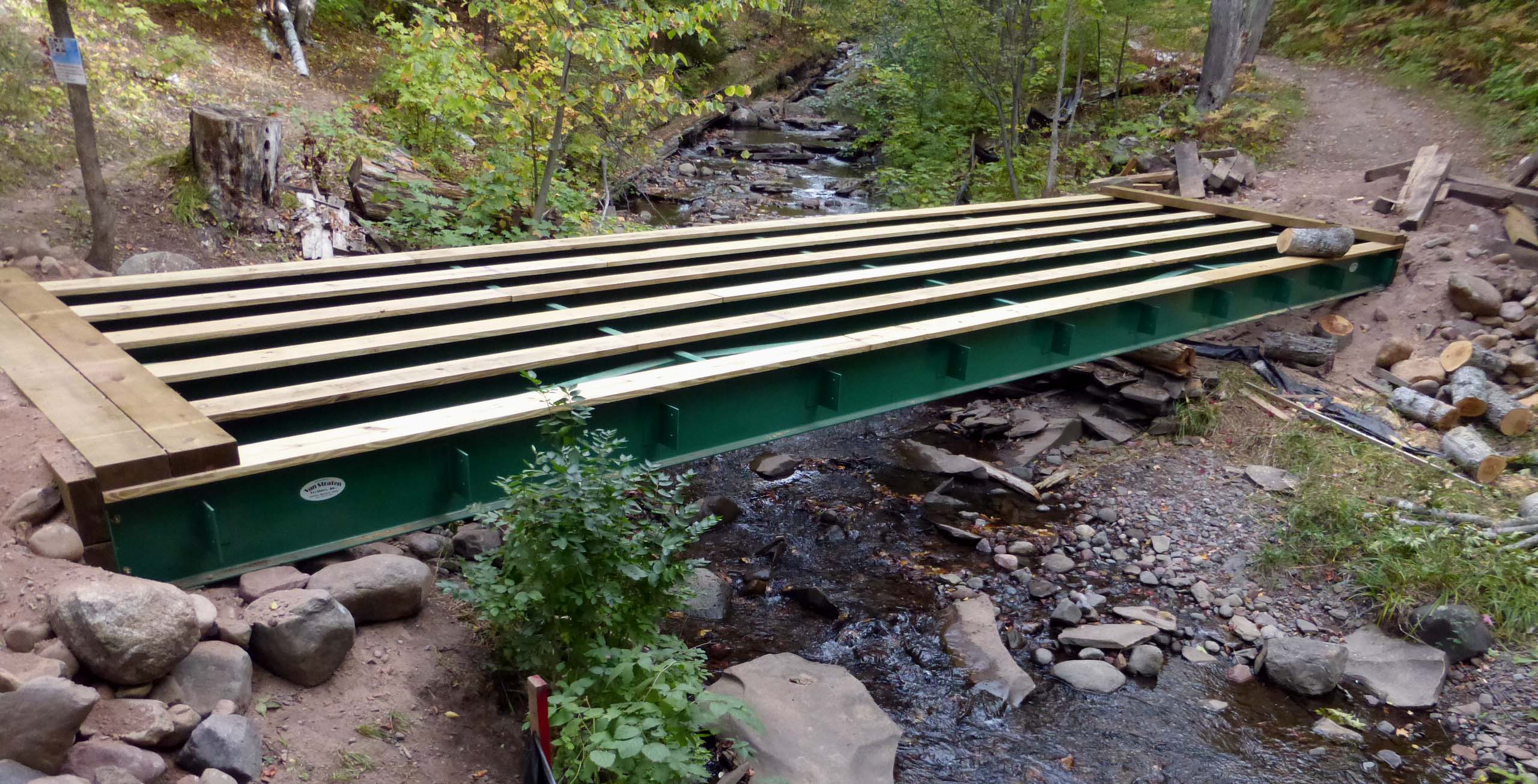

For our bridge abutment pour we used 2, 110volt mixers powered by two 2000watt Honda gens. This was on a creek, so we dug a sump hole in it and dropped a 1/2hp rough sump pump into it. With this pump we filled a small barrel for watering the mix from in a controlled fashion. We also had a garden hose attached to the pump for cleaning up afterwards. The generators also powered a vibrator. With the info you've posted, I think you can do this project. I'll post a couple more photo's, last one when our project nearly done.
